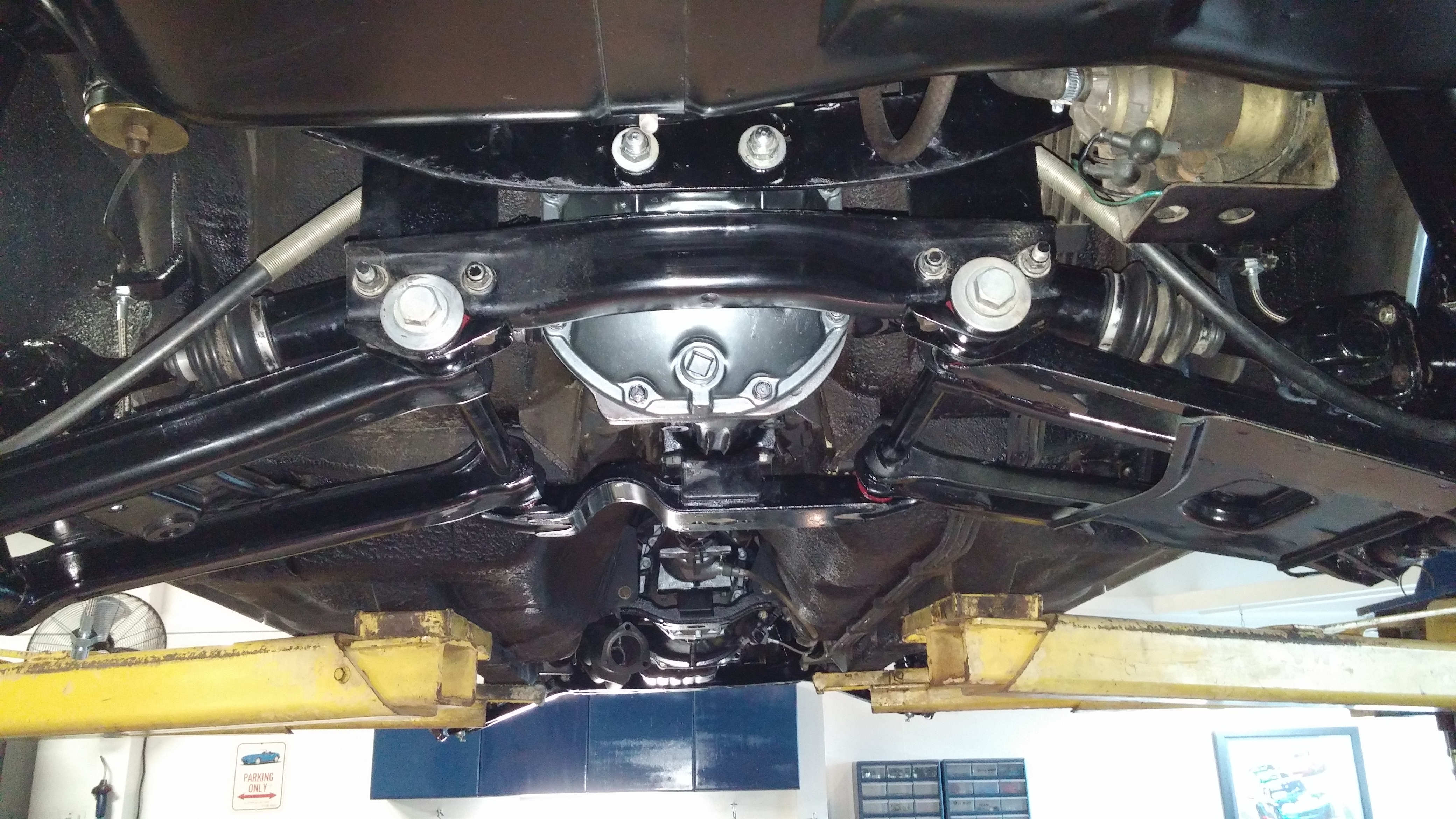

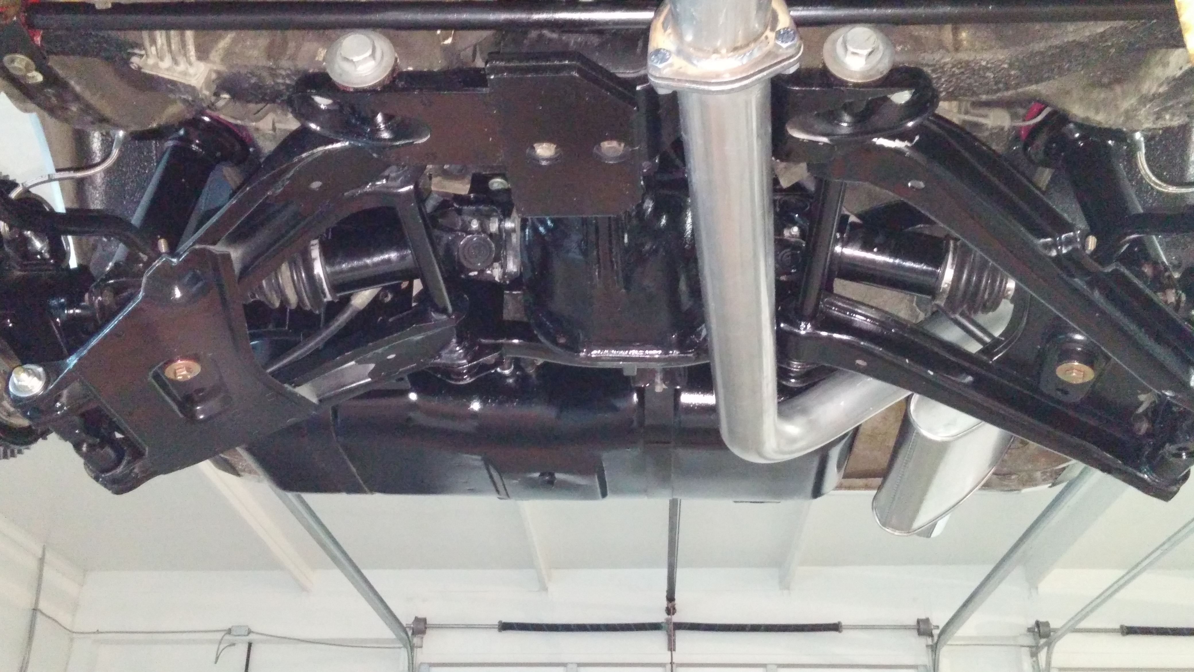

Siteunseen, thanks for pics of heat sheild. I am doing a once over with my friend on Sunday morning. Still need to install pcv pipe and bleed brakes and clutch. Then we will see how well we put it back together. I want to go back and redo a few things once its running again... I may look into the silicone hose Chickenman spoke of. I have a few parts I may take off and replace just to freshen up or shoot with some paint. I am tracking down a few factory engine bay stickers right now for a little extra detail. I think in the end I saw the project through as much as I had hoped to. My one weakness I would say is the intake manifold, I cleaned it best I could for having fuel rail and everything still attatched to it. It was super tough to clean. I also want to say for anyone doing exhaust in the future, the MSA premium exhaust system is top notch! I installed it by myself in a little over an hour and it fits perfect on a 75. I bolted up the 2 pipes together on the floor, zip tied the back pipe up to the control arm while attatched to my MSA 6 to 1 header. I knew ahead of time the muffler would be on an angle thanks to threads I found on this site. So I fitted the muffler to where I wanted it and started clamping, easy peasy! Here are the last of the pics, hopefully my pooches won't tell anyone how many times the diff was in and out of the car fighting that r180 mustache bar. I'm also hoping the left over bolts in the drawer aren't needed.
THANKYOU EVERYONE FOR ALL YOUR RESPONSES TO MY PROJECT THREAD, WHAT A GREAT HELP YOU ALL ARE!! I HOPE THIS WILL HELP SOMEONE ELSE IN THE FUTURE LIKE ME (NON MECHANIC) COMPLETE A SUSPENSION PROJECT.
When you hear that MSA full exhaust it will sound as good as it looks.  I enjoy reading successful/happy endings like your's.  I'm not a mechanic either but always seem to work through my projects after reading and getting help from this forum.
Congratulations!  You're happy, dogs are happy and you have a nice car.

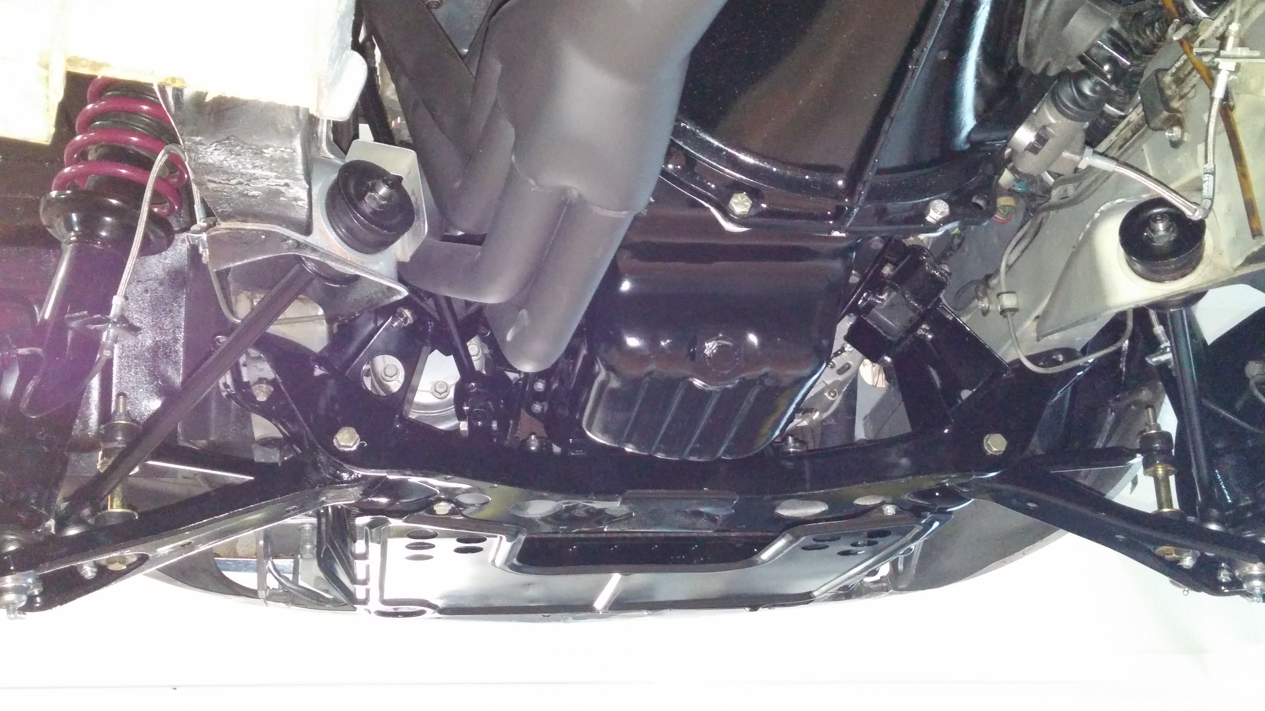

By normalize I mean "under no stress" and n the context of the control arm bushings, I mean "the rubber is under no torque stress when the car is sitting level on the road".
Wait.... Are you using poly bushings or original style rubber bushings? If you're using poly, forgot I said anything. Doesn't matter. Go ahead and tighten to full torque with the wheels off and the suspension hanging.

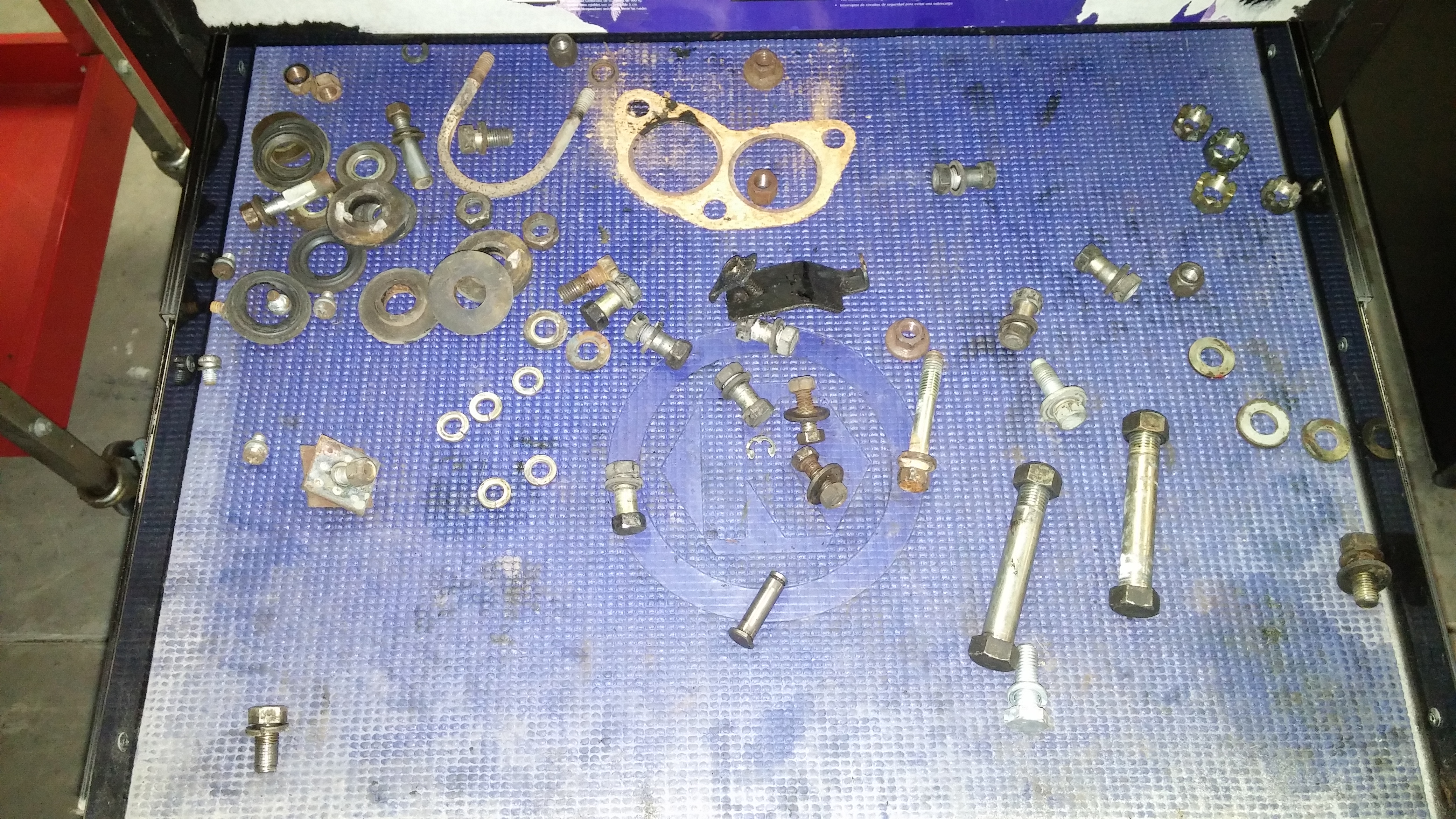

I left the spindle pin wedges out, it was on my button up list. I could not find the flat spot on the spindle pins?? I had know idea there was a front and a back to the pins. Just an fyi for the next person. Of course I had a 50/50 chance of putting them in right and neither one was right. So, I had to remove and reinstall those. Next, I pulled out my power bleeder and went to town on bleeding the brake system and clutch, all is good there. It's now time to turn the key...... fired right up and sounded great! I let it sit and idle while putting wheels on, I was totally stoked..... until I realized I could not get it into gear, any gear?? My new 5 speed transmission out of my parts car went into all 5 gears with ease when in the 79 and  when it was laying on the floor. Since the clutch felt good I went ahead and pulled the shifter to compare it to the shifter that was originally in my car. I noticed the hole that holds the shift pin was missing its brass sleeve and the hole was quite a bit bigger and made it very loose and sloppy. The only thing I can figure is that it's a leverage issue and the rubber shift boots are playing a role in this??? I temporarily put the original 75 shifter in and it goes easily into 2nd, 4th and reverse but obviously not 1st, 3rd and 5th because it bottoms out into the trans tunnel. Does this sound like I'm headed in the right direction??
