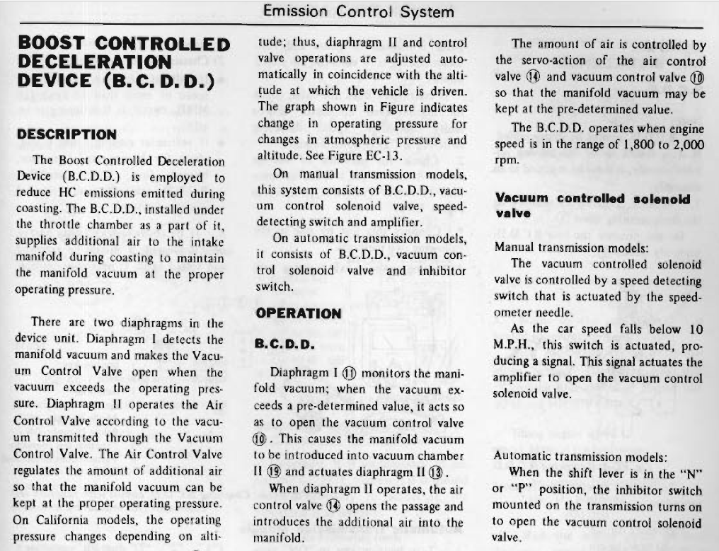

what adjustments can be made to it?  Should i start with cleaning the electrical?  or has it probably failed.
I'm looking with a phone but it looks like the hose is missing or unplugged.  I was told to plug mine when I deleted the egr and bpt valves.
It has a nut on the bottom you can turn for adjustment.  Try half a turn one way and drive it. If it helps keep going that way, if it makes it worse go back the other way.  Google "280z bcdd adjustment" and click "images".  You'll see the fsm's directions.
From http://xenonzcar.com/s30/files/FSM/1978 280z FSM.zip  Section "EC Emission Control System".  If you have any unplugged hoses, plug them up.
