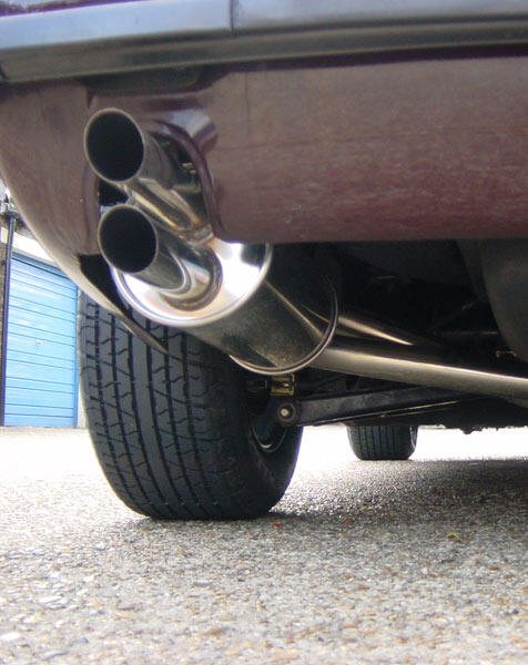

At some point you just need to step up and do it. I see you asking questions about stuff (sensor bosses, welded mounting tabs etc) that you can add/modify on whatever system you buy. Some of the questions make it sound like you are ordering parts for NASA. Aftermarket exhaust systems for almost any car - in my experience - are likely to need a little tweaking at the very least. This is not millimetre accurate engineering here. They are pipes with bends in them.
I previously vouched for the Spirit Garage (Japan) systems and used one on one of my cars for many years. It is still going strong. However, I made some small modifications to the rearmost mounts to better fit (in my opinion) my car, and my tastes. No big deal, surely? I eventually painted most of it flat black, as I got tired of the 'bling'.
The Spirit Garage and Fujitsubo systems are excellent quality and have the advantage of ready availability and, currently, USD to JPY exchange rates greatly in your favour.
31 minutes ago, HS30-H said:
To be fair, you've been posting on this thread asking questions since 2017 and you still haven't bought a system. One might be excused for thinking it's you that doesn't want to "buy the damn thing"... 😉
