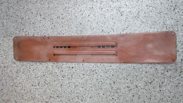

February 3, 20178 yr comment_511669 6 hours ago, Hardway said: I cannot find the series-1 hatch flap panel restoration article at the moment but I will keep looking as I remember seeing it awhile back. page 24. And you would enjoy this photo from the same thread along with a couple of my pictures. See the seal on the back of my panel? That was a foam seal originally. It decomposes. That panel has to be sealed to the hatch for the vents to work.  Edited February 3, 20178 yr by 26th-Z Link to comment https://www.classiczcars.com/forums/topic/56972-exhaust-tip-length/?&page=2#findComment-511669 Share on other sites More sharing options...

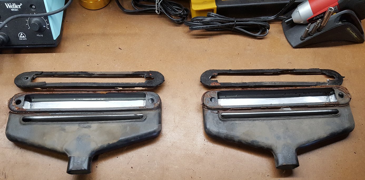

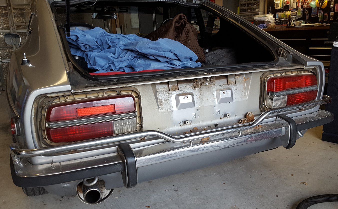

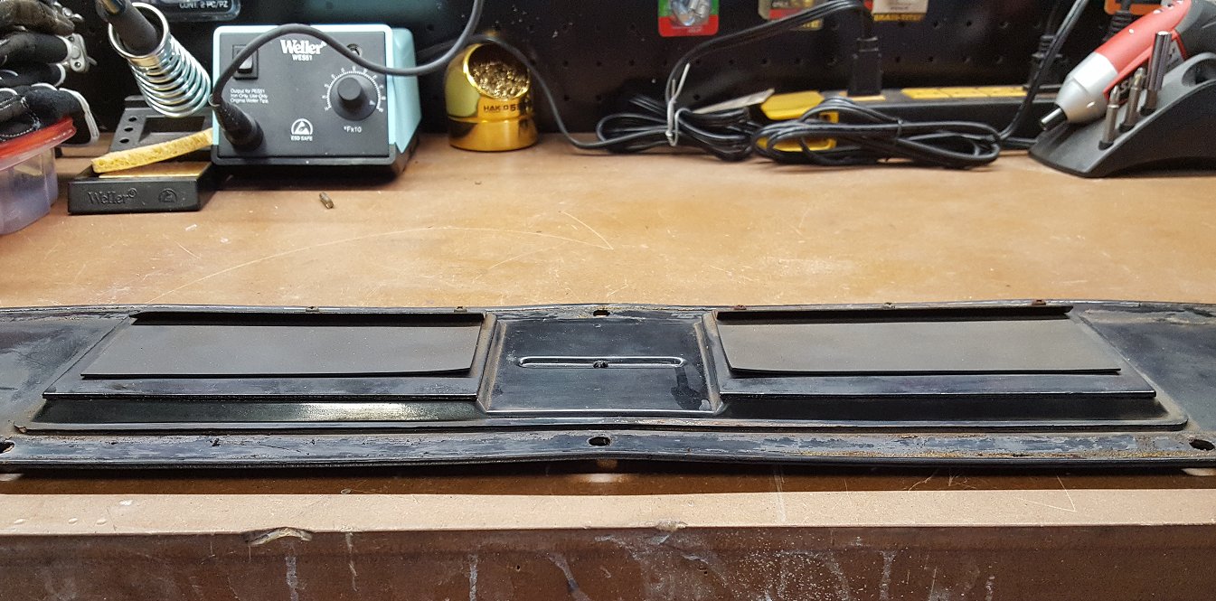

February 6, 20178 yr Author comment_511947 I had some to work on the Z today and sure enough, just about every seal and gasket related to the hatch vents and taillights are shot.  I am unsure if the rubber flaps might have been replaced at some point.  They look thin and are still soft.  Additionally, the ducts for the hatch vents were not even secured to the top sheet metal of the hatch.  I am going to start another thread in the body and paint section the relates to restoring all of the hatch vent system components.  Here are a few shots of today's progress.  Edited February 6, 20178 yr by Hardway Link to comment https://www.classiczcars.com/forums/topic/56972-exhaust-tip-length/?&page=2#findComment-511947 Share on other sites More sharing options...
