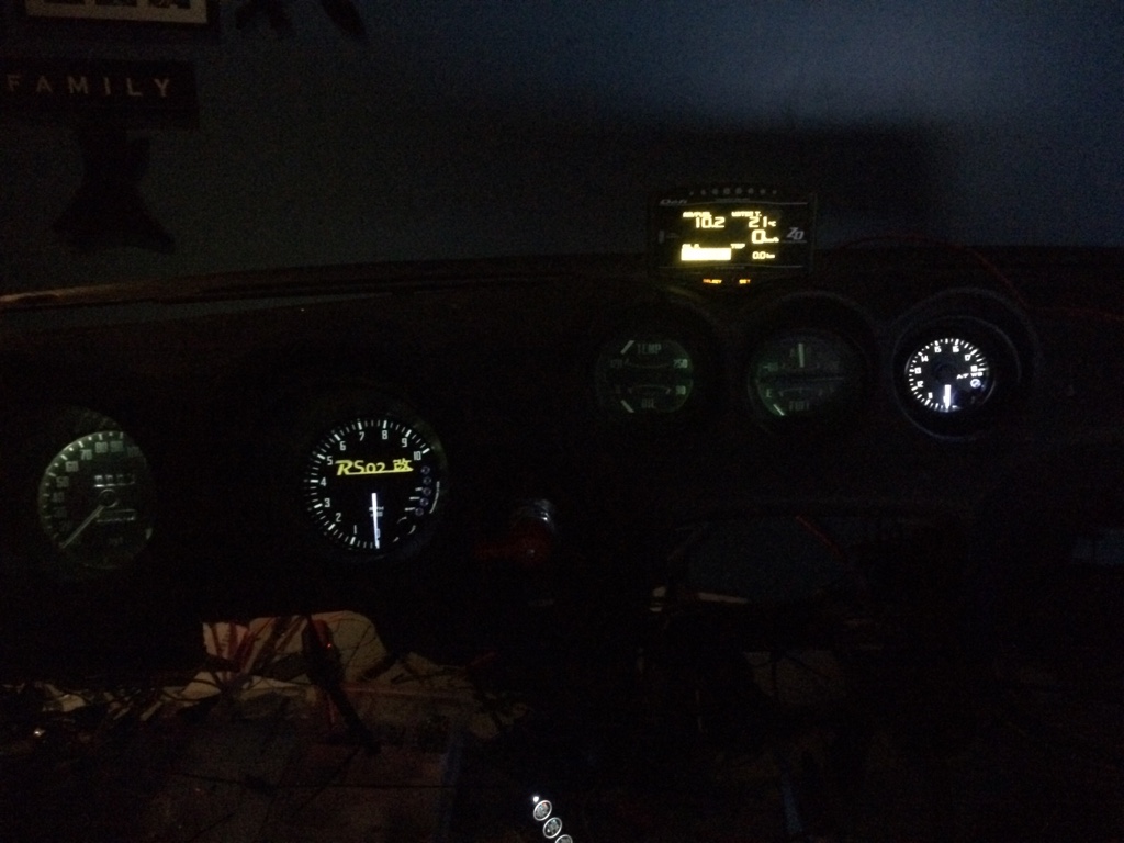

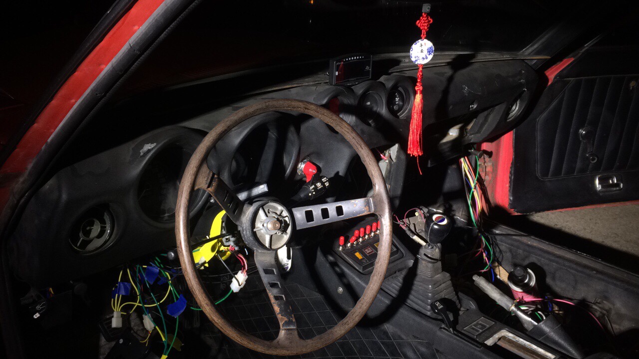

February 16, 20178 yr Author comment_513061 Dash wiring is finally getting close to done. I will keep it unwrapped for now in case for some adjustments.Sent from my iPhone using Classic Zcar Club mobile Link to comment https://www.classiczcars.com/forums/topic/56981-240z-restomod/?&page=3#findComment-513061 Share on other sites More sharing options...

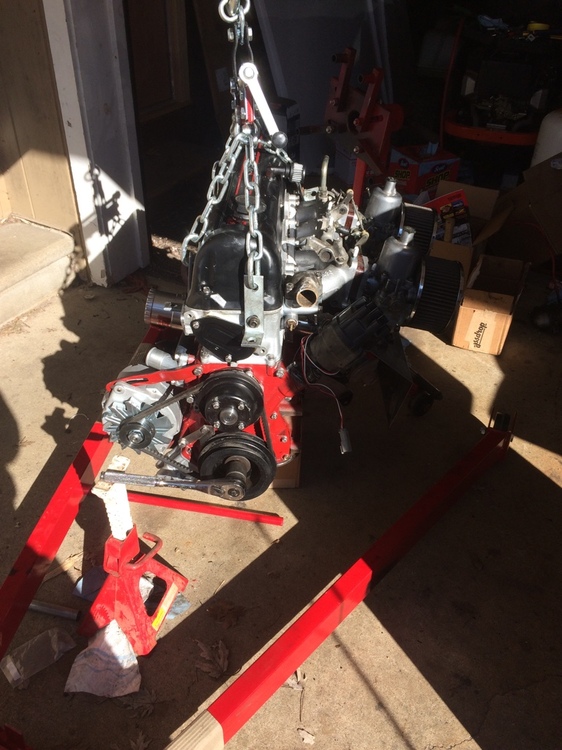

February 21, 20178 yr Author comment_513533 The engine is in! And dash wiring is mostly done.Sent from my iPhone using Classic Zcar Club mobile Link to comment https://www.classiczcars.com/forums/topic/56981-240z-restomod/?&page=3#findComment-513533 Share on other sites More sharing options...

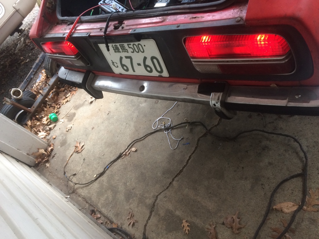

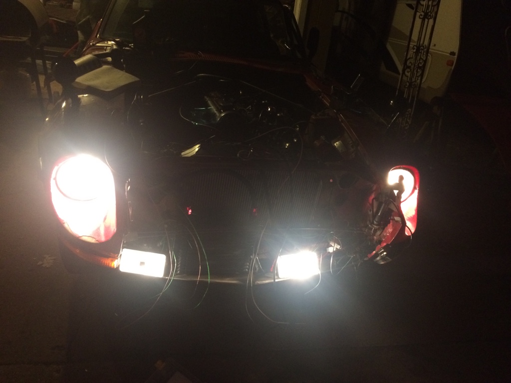

March 29, 20177 yr Author comment_516753 All my lights are working. The old two function bulb in the tail are really bad... blew 2 fuses trying to find what's the problem. Turns out it draws too much amp.Sent from my iPhone using Classic Zcar Club mobile Link to comment https://www.classiczcars.com/forums/topic/56981-240z-restomod/?&page=3#findComment-516753 Share on other sites More sharing options...

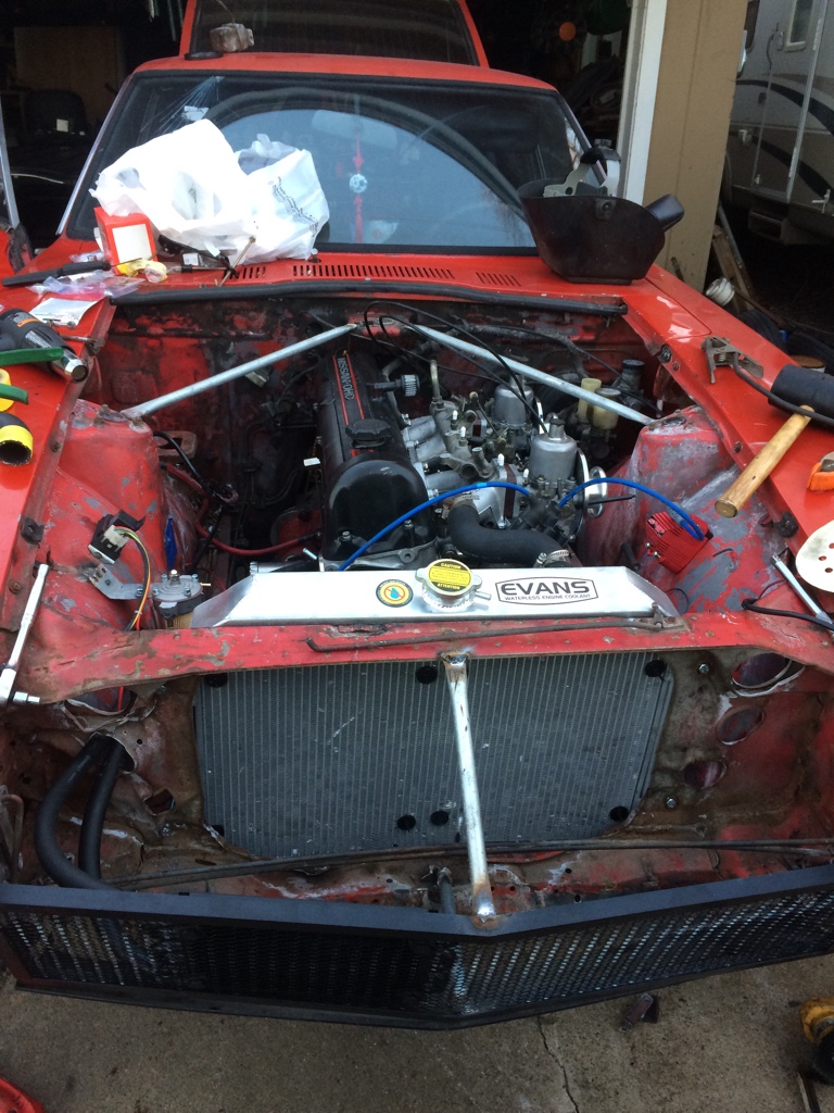

April 23, 20177 yr Author comment_518855 Got my car running!A LOT of problems though. Here's what I need to address: 1. The MSD ignition box fried itself. Now only the megnetic and hall effect input works... Do not buy old msd from Ebay... 2. Slight water leak from water pump; 3. Oil is slipping through the gap where the front cover and cylinder head meet, on the passenger side; 4. Need to route a battery power to rear of the car in order to get the antanna working, this can be delayed but it's easier to do with the breather tank off; 5. The 17mm breather hose kept kinking, need a coil inside to support it; 6. fuel tank need to go in, flush the fuel lines, wire the pump and float. Link to comment https://www.classiczcars.com/forums/topic/56981-240z-restomod/?&page=3#findComment-518855 Share on other sites More sharing options...

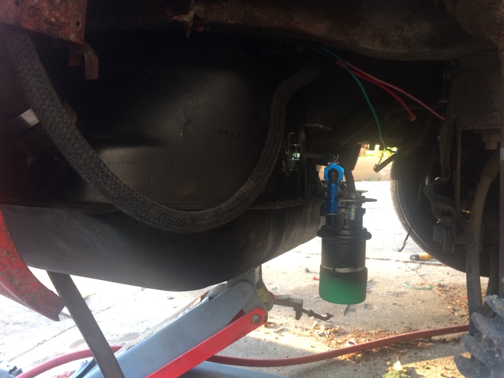

April 24, 20177 yr Author comment_518956 Fuel tank is going in!I know it's not the best idea to use a car jack under the tank but the tank is not staying there long anyway.Hoses. I found out the compression springs that hardware store sell are perfect hose supporters.Sent from my iPhone using Classic Zcar Club mobile Link to comment https://www.classiczcars.com/forums/topic/56981-240z-restomod/?&page=3#findComment-518956 Share on other sites More sharing options...
April 24, 20177 yr comment_518957 that pump looks kind of low. Link to comment https://www.classiczcars.com/forums/topic/56981-240z-restomod/?&page=3#findComment-518957 Share on other sites More sharing options...
April 25, 20177 yr Author comment_519078 that pump looks kind of low.I checked the ground clearance and found out that it's a hair higher than my exhaust. Don't know what they're thinking when they're designing this pump. The instructions said to keep the pump below fuel tank level, and I did my best...Sent from my iPhone using Classic Zcar Club mobile Link to comment https://www.classiczcars.com/forums/topic/56981-240z-restomod/?&page=3#findComment-519078 Share on other sites More sharing options...
April 25, 20177 yr comment_519084 On 4/23/2017 at 9:14 PM, sweatybetty said: that pump looks kind of low. Agreed. I don't know if I'd feel too good about that. The disaster potential is pretty high. Link to comment https://www.classiczcars.com/forums/topic/56981-240z-restomod/?&page=3#findComment-519084 Share on other sites More sharing options...
April 25, 20177 yr Author comment_519102 1 hour ago, ksechler said: Agreed. I don't know if I'd feel too good about that. The disaster potential is pretty high. Alright. I will relocate it. If the pump were to be touched the exhaust would go first. I guess I'll play safe. It should pickup fuel just fine. Link to comment https://www.classiczcars.com/forums/topic/56981-240z-restomod/?&page=3#findComment-519102 Share on other sites More sharing options...
April 25, 20177 yr comment_519114 1 hour ago, RS02 said: Alright. I will relocate it. If the pump were to be touched the exhaust would go first. I guess I'll play safe. It should pickup fuel just fine. I think you'll be safer for it in the long run. My concern wasn't about whether or not the exhaust went first or not at all. The problem is if that fuel pump hits something like bottoming out over a speed bump, it will rip a hole in your tank which could very easily cause a fire and burn you up. I wouldn't attach it to the tank at all. Edited April 25, 20177 yr by ksechler Link to comment https://www.classiczcars.com/forums/topic/56981-240z-restomod/?&page=3#findComment-519114 Share on other sites More sharing options...
