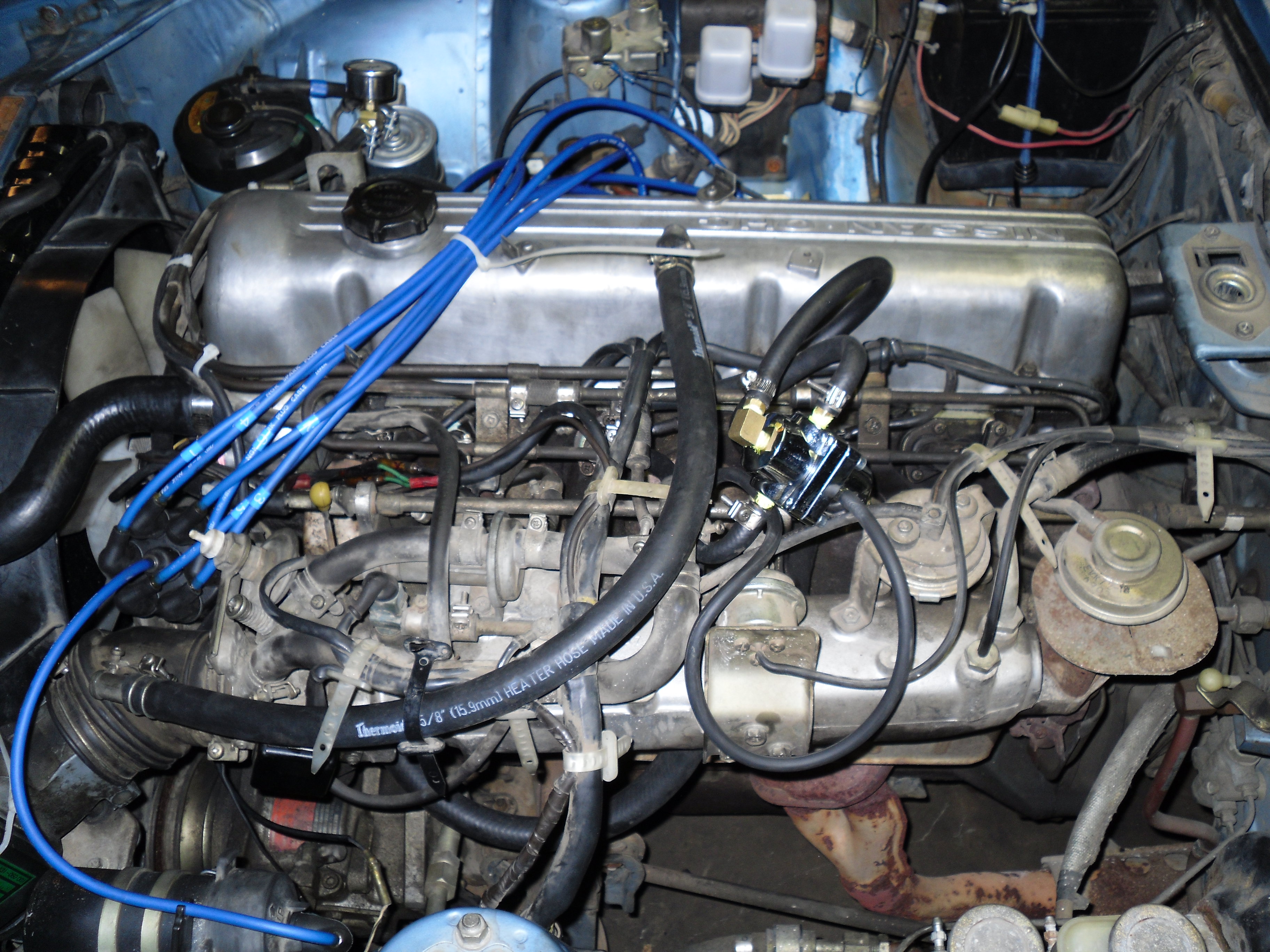

There's not an adjustable FPR that works on our cars.  I've read hours on that and even bought one just to see if it helped and it did not.  They lose pressure.  Airtex is the only one I read about that worked okay and it was like $249.
You can buy the potentiometer at Radio Shack for $5, that was what fixed mine and many others on here.
I almost bought this Bosch but it doesn't have a vacuum port.
https://www.summitracing.com/ga/parts/bch-0280160001/overview/?cm_mmc=pla-google-_-shopping-_-srese1-_-bosch-automotive
Here's the one that I found that may work, $269
http://www.thezstore.com/page/TZS/PROD/classic17b06/11-3073
