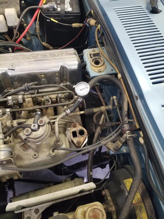

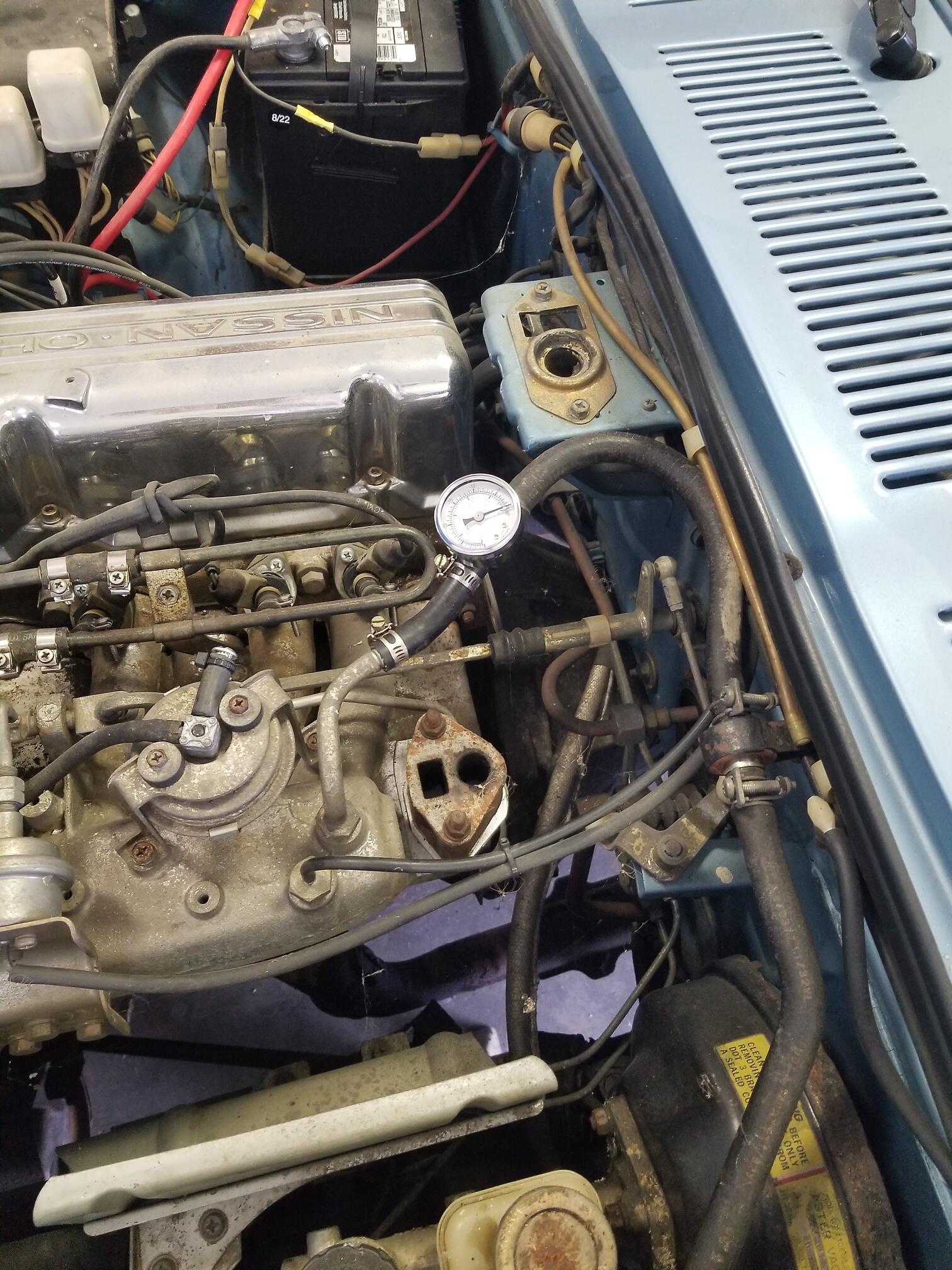

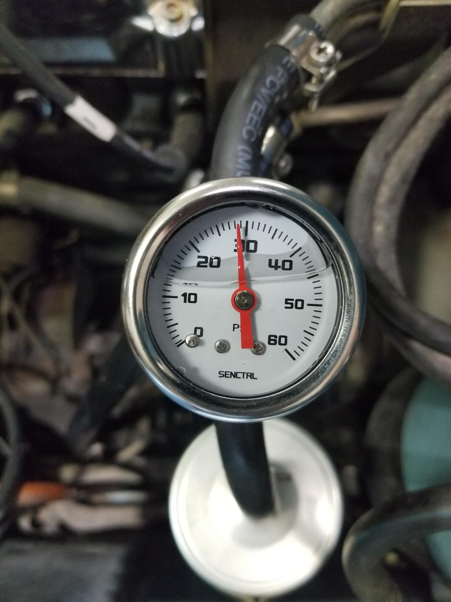

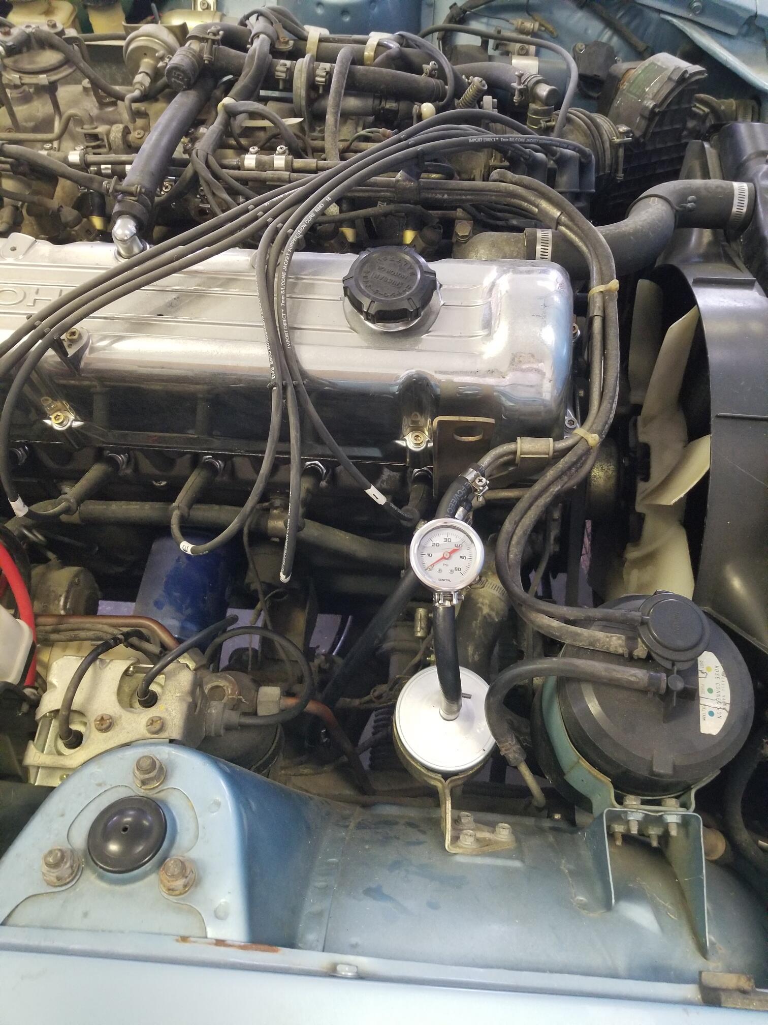

I rigged up a temporary fuel tank with a 5 gallon gas can in the hatch. It's only got a gallon or two in it. The car starts and runs ok but here is the fuel pressure while warming up and the the vacuum gauge that is plumbed in before the brake booster check valve
20231005_180334_resized.jpg20231005_180341_resized.jpg20231005_195119_resized.jpg20231005_195122_resized.jpg

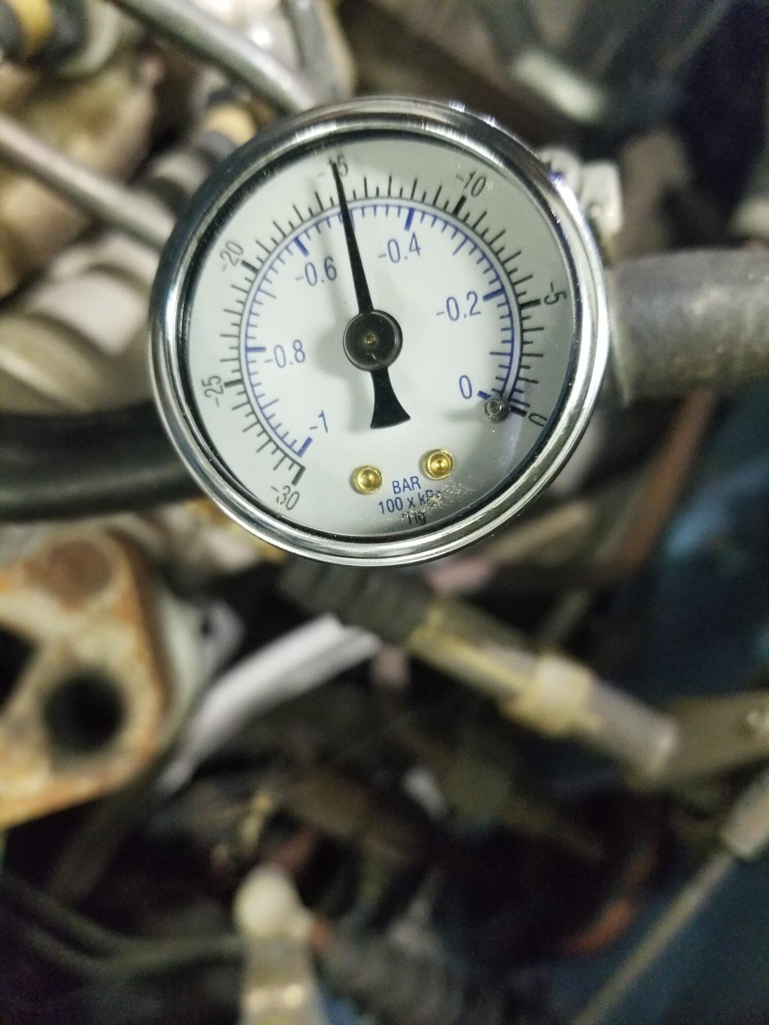

It was my understanding that the vacuum to fuel pressure reduction should be 1:1?? we are seeing more like 1:2. Should this fuel pressure be 21-22Psi with 15...
Never mind, I think I figured it out. His vacuum gauge is not reading Psi!!! It's reading Hg. 0.5 bar is about 7psi. We had a static fuel pressure of about 35 psi in the start position with the solenoid disconnected. So that looks pretty good from that standpoint.
Which is good and bad. It seems our fuel pressure is regulating properly but our vacuum seems really low. Best places to start? I know he has block off the EGR. How do I verify that it is actually properly blocked?

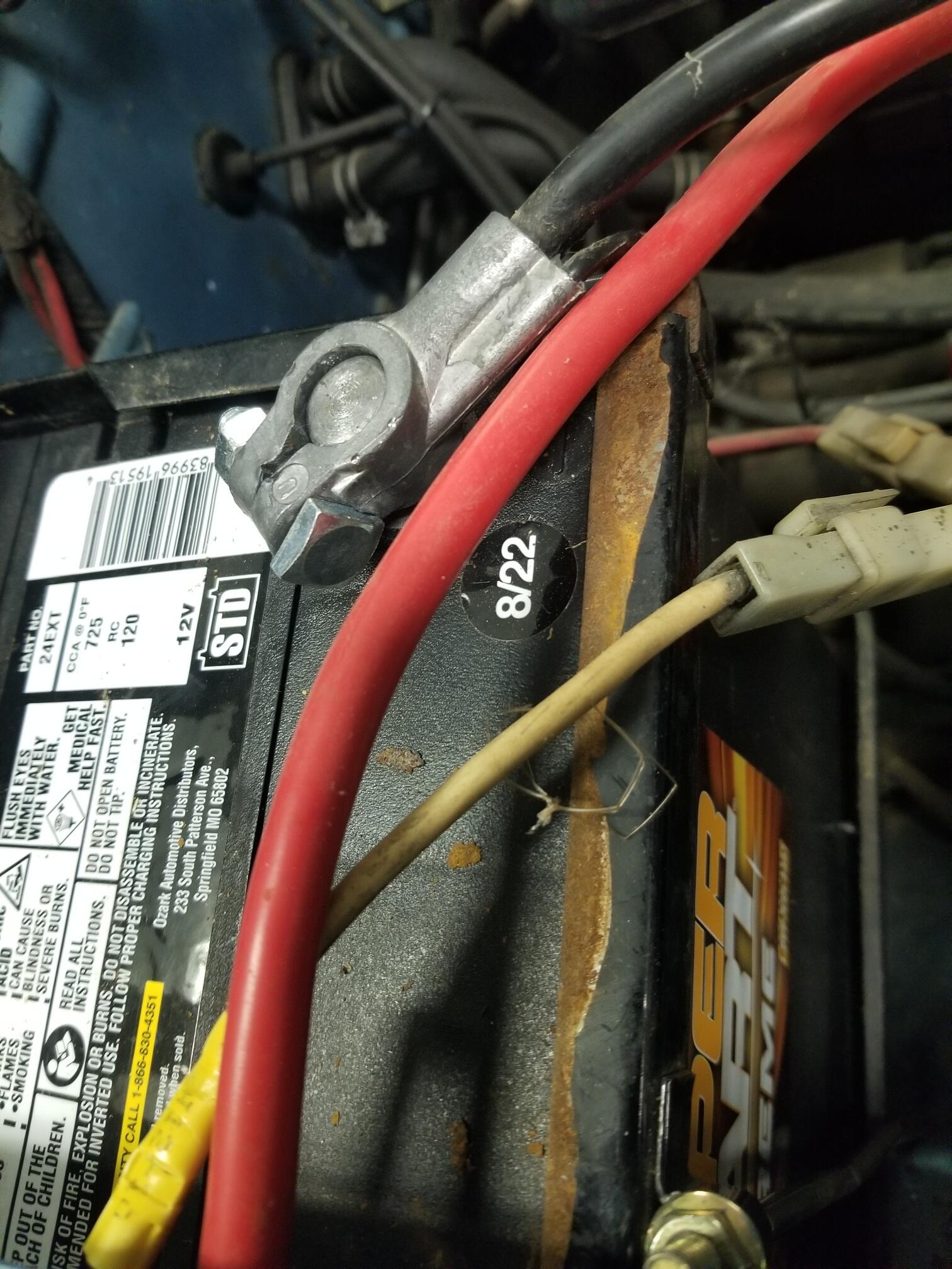

Battery is August 2022
At idle
Just after shut off. Where to start??
The EGR looks like it's open because I had to reinstall the EGR spacer to get it sealed. The mounting studs aren't fully threaded and at the time I couldn't get them out. But there is a block-off plate and gasket under that spacer.
I understand, but I know some of these devices aren't easily blocked off because of how they're designed. I want to be sure that that method is perfectly executed and does not present an opportunity to internally bypass. I was under the impression that vacuum should be higher than that but that could be a units of measure issue again?
