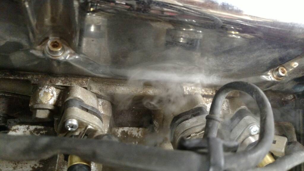

I tried out the fog machine tonight. It worked spectacularly well. I found a huge vacuum leak around the #5 injector. I must have not gotten the sealing ring lined up when I installed it a while back. I disassembled the rear half of the fuel rail and redid everything. Another fog test showed no leaks.
I turned the key and it started right up. It's smooth as silk. I set idle speed and timing once it had warmed up. It revs freely with no hesitation or popping. I am SOOOOO HAPPY right now!

So I got a question... Having never used one of them smoke machines, what is it that keeps the smoke from just picking a cylinder with open valves and passing through the engine and out the exhaust system? Do you stick a banana in the tailpipe or something?
Good question.  I suppose some does escape.  But the fog machine I borrowed is pretty big, and puts out a large volume of fog (it traversed the 10 foot tube in a second or two).  So there's plenty to go around.  In fact, I had to be pretty meticulous sealing up the intake with my yogurt cup, and even making sure the hose clamp on my vinyl "fog tube" was tight enough to seal it against the vacuum port pipe in the intake.  Otherwise, fog would seep out where I didn't want it to, and obscure things pretty quickly.  Once I fixed the injector leak, I ran the machine a couple more times to verify it and look for others.  At that point, the leakage around the yogurt cup and vinyl tube were still enough to send faint tendrils of fog here and there.  So I had to fiddle some more to eliminate the leaks.  Even my sealed connection at the fog machine leaked a little.
Thinking about this, you don't want this to build any pressure.  It might damage vacuum diaphragms and such.  So having the exhaust pipe be a safety valve is probably a good thing.

Hmmm  I wonder if simply plugging the exhaust tail pipe and the air cleaner would effectively seal the engine? less fooling with unhooking stuff. Then add smoke at the brake booster port.
I'd be concerned with building pressure if the seal is too good.
I removed the AFM, leaving the rubber hose to the intake in place.  I used the big end of my yogurt cup with a few wraps of electrical tape to plug that.  I'd already blocked off the EGR passage and associated vacuum line.  All I had to do at that point is pull the brake booster line off the hard line on the intake, and clamp the tube from the fog generator to it.  I could have used the barb on the booster check valve.  But the tubing I used was too big, and there wasn't much room around it for fiddling with a hose clamp.  I suspect you can leave the exhaust (and even the EGR) open, and it will still be effective.  Even with some leakage around the tubing and yogurt cup, there was plenty of fog coming out around the injector boss to see the leak.
