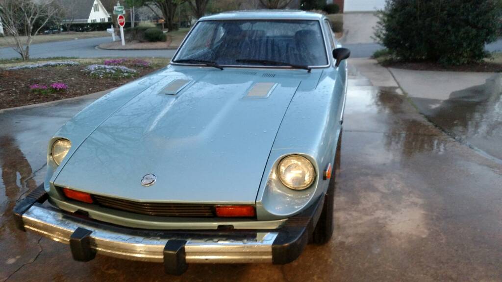

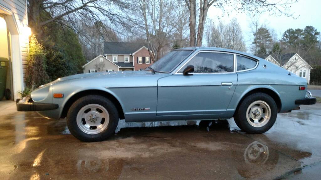

No video. But a few photos after a fluid change and wash. I drove it around my neighborhood for about 15 minutes and it runs pretty good. I need to do a thorough tune up and bleed the brakes before I drive it much. But I couldn't resist a shakedown drive. The only thing I can find wrong is a burned out license plate bulb and the power antenna is inoperative.
Sent from my XT1254 using Classic Zcar Club mobile
Over the weekend I changed fluids, set the timing and tied up a few loose ends in the engine room. Vacuum holds at 15 at idle. Still a tad low (I'm just gonna have to replace all the vacuum hoses and be sure). It would hesitate at times under acceleration. But it's been running fairly well. Then tonight I took it out for a longer drive. After a few miles it started to bog really badly around 3k rpm. It would occasionally backfire out the tailpipe too. It only does it while driving. It revs fine in the shop. I figure it's rust from the fuel tank getting sucked up while in motion. So I guess it's time to drop the fuel tank and have it cleaned and coated.
