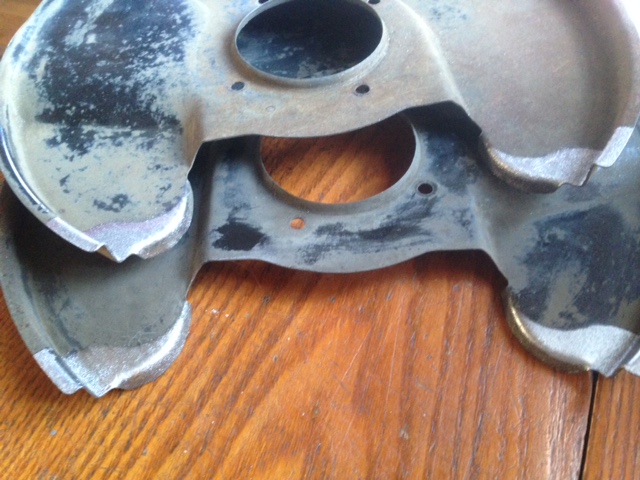

I have all of the suspension off the car for clean up and installation of Eibach progressive springs. I am also working on installation of the MK63 calipers. Kats has helped me find the parts needed to complete the project. (vented rotors, spring clips etc...) I have began the process of modifying a set of backing plates for the new calipers. I have marked a spare set of backing plates (silver area to be cut out and metal rolled over to resemble factory). I have a metal shop that will complete this for me, then I will clean the backing plates up (media blast) and have them powder coated. I believe that having backing plates will give a more complete look to the upgrade. I will continue to update as I progress.

The modified backing plates are complete. I am happy with the results, they look factory. I believe having backing plates along with my MK63 caliper upgrade will enhance the overall upgrade.
Edited by JLPurcell
Suspension back with Eibach Progressive springs and I am dry fitting my MK63 parts. I want to thank a member for his help with locating the needed parts for the caliper and rotor upgrade. I dry fitted the modified backing plates, calipers, and rotors tonight. It all goes together flawlessly. I like the way the modified backing plates fit to the MK63 calipers.
