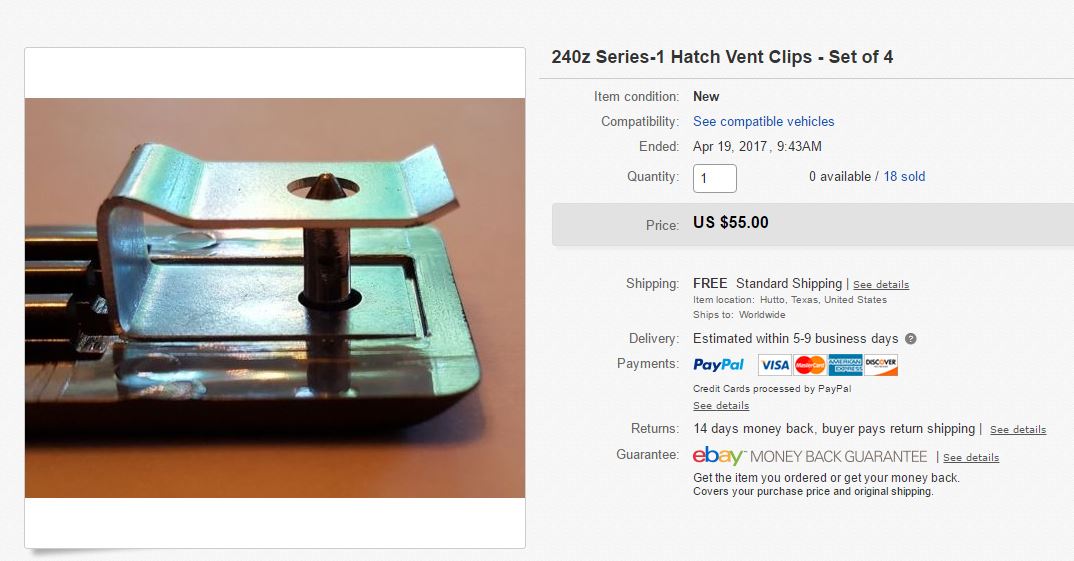

"That's all folks!"  The last set of clips just sold on Ebay.  I appreciate everyone that purchased a set and look forward to meeting up with those that will be picking up their sets at ZCON.
This has been a team effort for sure and I thank everyone who was a part of it.  They say it takes a village to raise a child, it certainly takes a community to keep these old cars on the road.  If a large enough need presents itself I would consider doing another run but I feel this first run took care of a lot of folks that were needing them.
