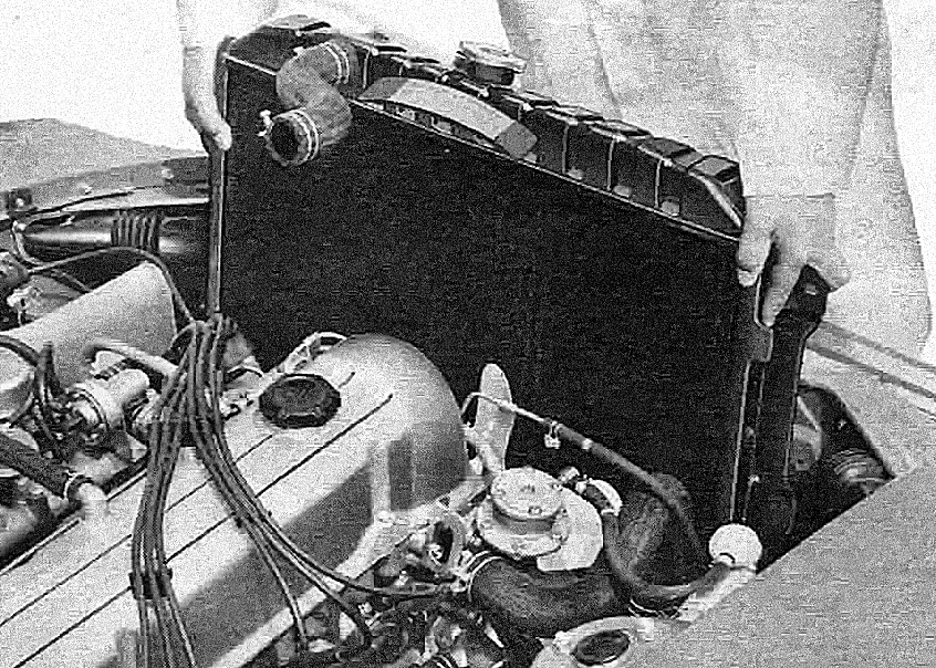

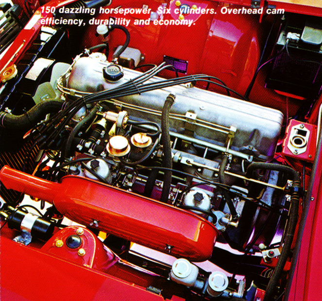

Early 1970 brochure has 710/OIL Cap:
FSM with posible HLS30-00003 seems to have 710/OIL Cap

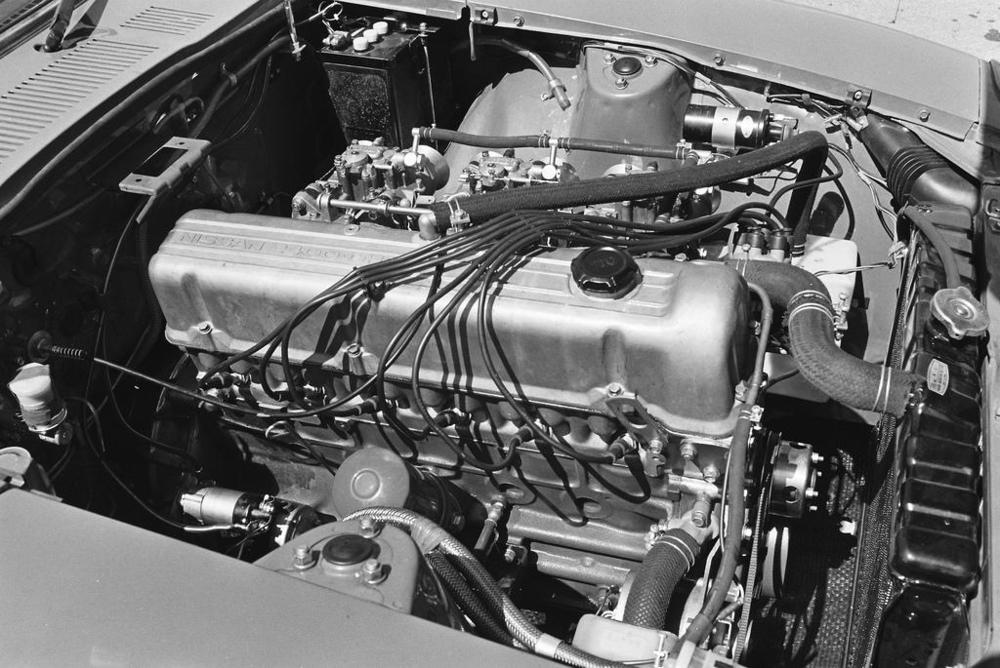

July 1970 First L24 Factory racer had 710/OIL Cap:

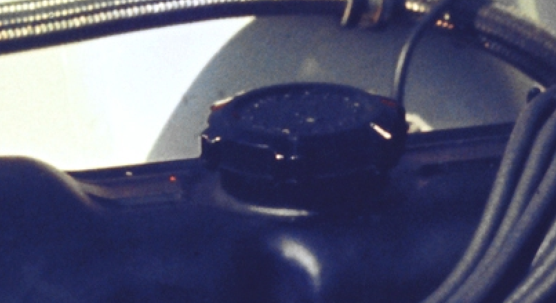

Q3 1970 BRE racer seems to have Elephant Cap:
