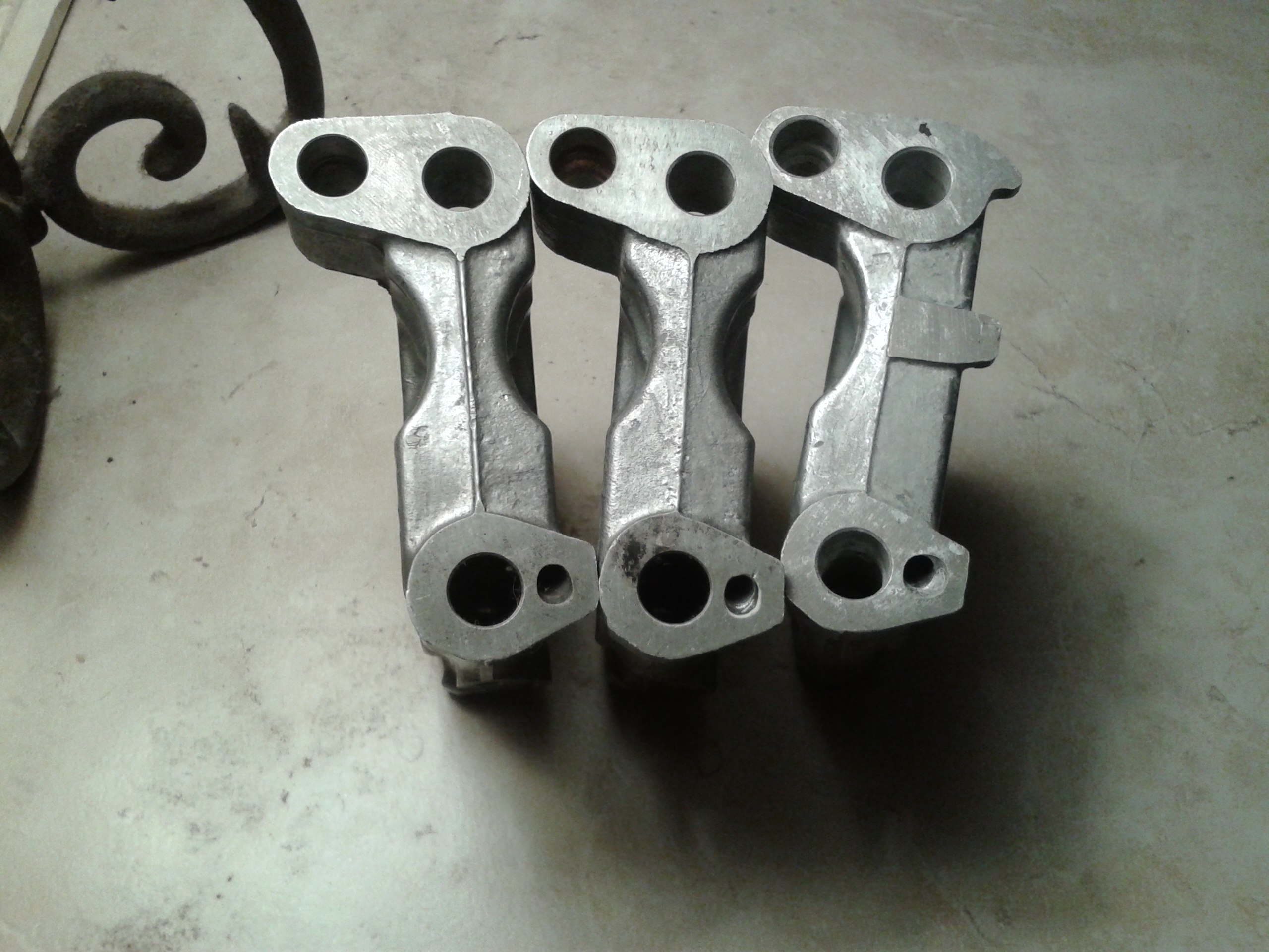

June 9, 20177 yr comment_522690 9 hours ago, siteunseen said: The head bolts go through the far left holes in my picture. The cam tower bolts go through the two that are in line with each other. The oil feeds are the smaller holes to the right. Hope you can understand my backwards arse thinking/splainin'. The cam tower bolts go through the top left and bottom holes. The head bolts go through the top center holes. Chuck Link to comment https://www.classiczcars.com/forums/topic/57055-camshaft-advice/?&page=3#findComment-522690 Share on other sites More sharing options...

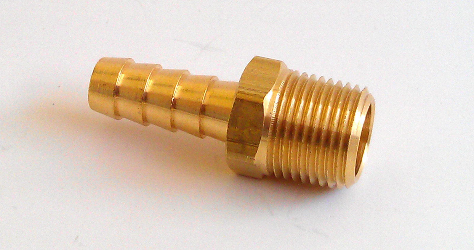

June 9, 20177 yr comment_522739 25 minutes ago, Mark Maras said: A paper punch works great for clean holes when making gaskets. Mark we'd make a good team! I knew or at least had read that probably from you. If he doesn't have a paper punch a brass fitting will work to cut the gasket material also. Good catch, I need somebody that thinks like I do to finish my thoughts. Thank you Sir! Link to comment https://www.classiczcars.com/forums/topic/57055-camshaft-advice/?&page=3#findComment-522739 Share on other sites More sharing options...

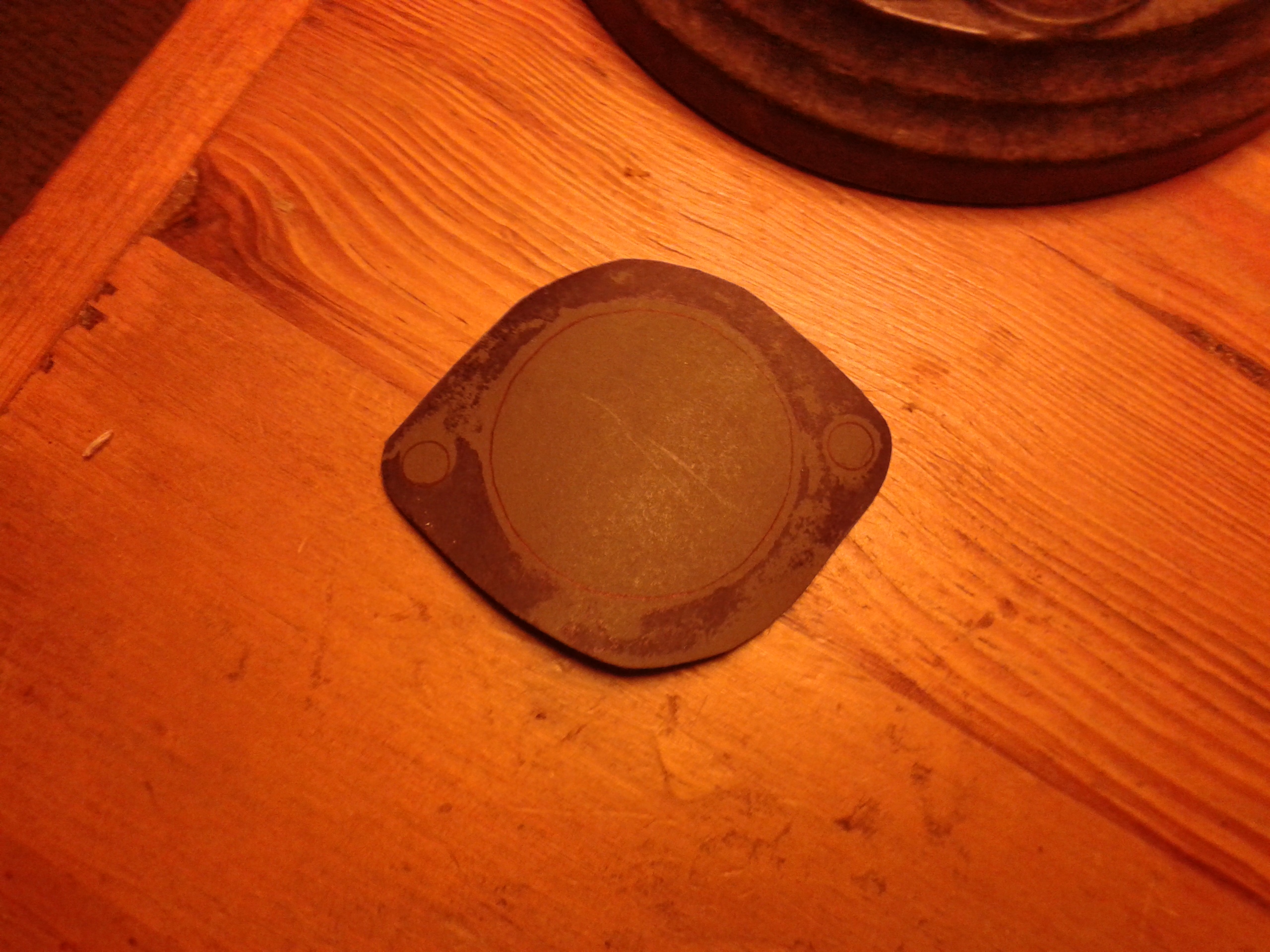

June 10, 20177 yr comment_522769 My first attempt and didn't like it so I made a better one the next time. Edited June 10, 20177 yr by siteunseen Link to comment https://www.classiczcars.com/forums/topic/57055-camshaft-advice/?&page=3#findComment-522769 Share on other sites More sharing options...
