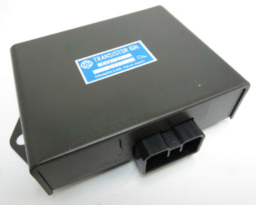

I can not find a Transistor Ignition Unit inside my engine bay, it was not in the location the manual said it would be. (Next to the battery) I am trying to sell my car soon as a driveable project car because I don't have the time or money to throw at restoring it and this random death of spark really dampens my day. So any help would be appreciated.
Found the transistor ign module. The book says specialized equipment is required to test it. Are there ways of testing it without the specialized equipment? Am I even on the right track?

If you want to test the TIU, you can use the test section in an instruction I made for replacing the TIU with a HEI module. The test procedure will be the same for the TIU.
The instruction is made for someone the has basic knowledge of the electrical system. Its basically a process of elimination since the TIU is a black box without special test equipment.

There are several tests you can run described in the FSM.  Not sure what "book" you're referring to, but it seems like the wrong one, considering the next-to-the-battery module location.  You didn't say what year 280Z either.  Use the Factory book from the Downloads area.
You have power to the coil.  It's not likely a loose wire on the input side.  It's probably the module itself or the pickup coil in the distributor.  Do the simple meter tests shown in the Engine Electrical chapter.
Judging by the photo in post#3 it's a E12-27 out of a 78 280Z or a ZX.
Basically any manual from the 78 onwards should get you through it. The manual quickly moves over to specialized test equipment though.
1978_280Z_TIU.pdf
280Z_1978_GM_HEI_Mod_Rev2.pdf
