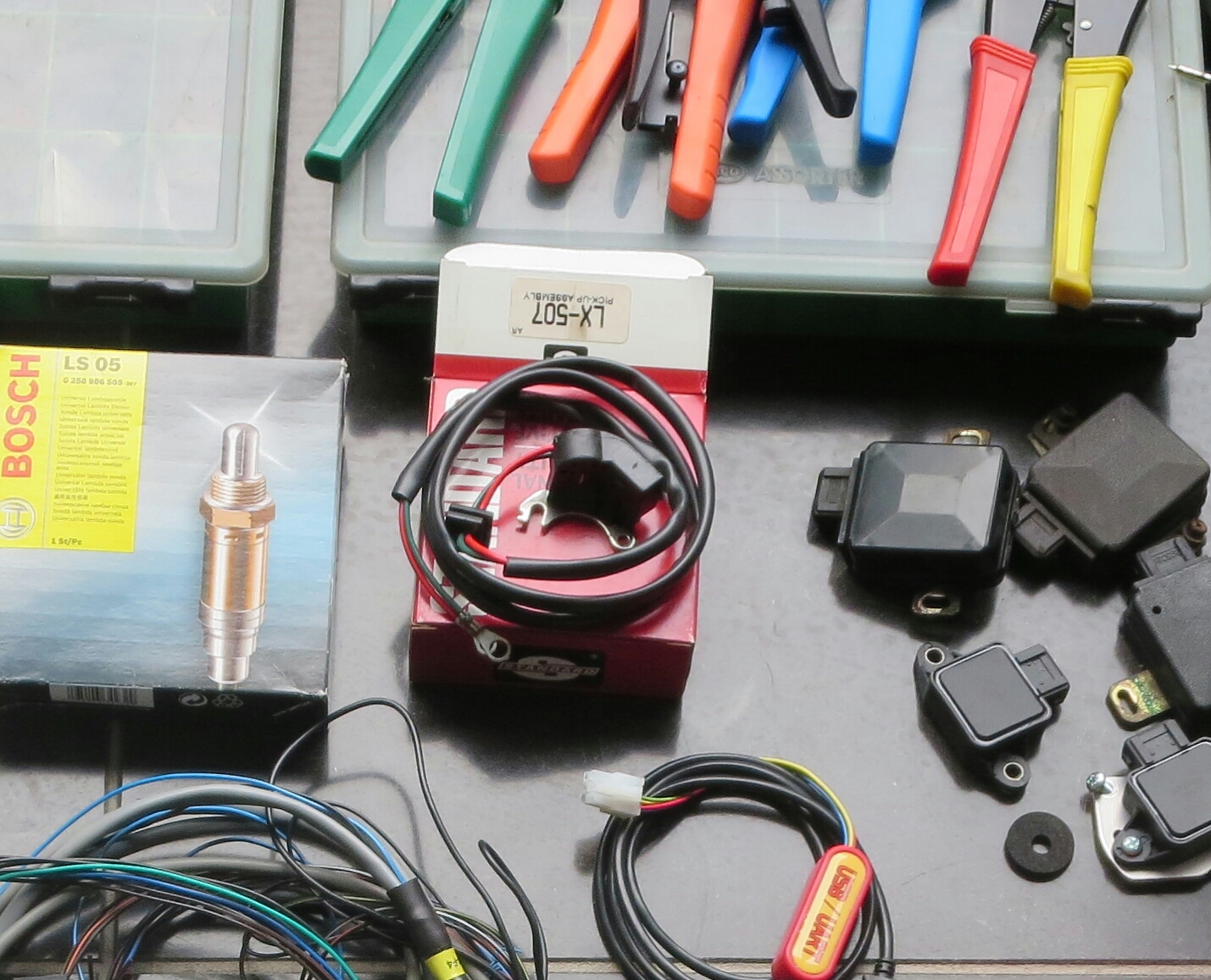

February 26, 20178 yr comment_513843 Rockauto sell a pick-up from the manufacture Standard. P/N: LX-507. I used that in mine. Link to comment https://www.classiczcars.com/forums/topic/57093-nothing-coming-from-ignition-coil/?&page=4#findComment-513843 Share on other sites More sharing options...
