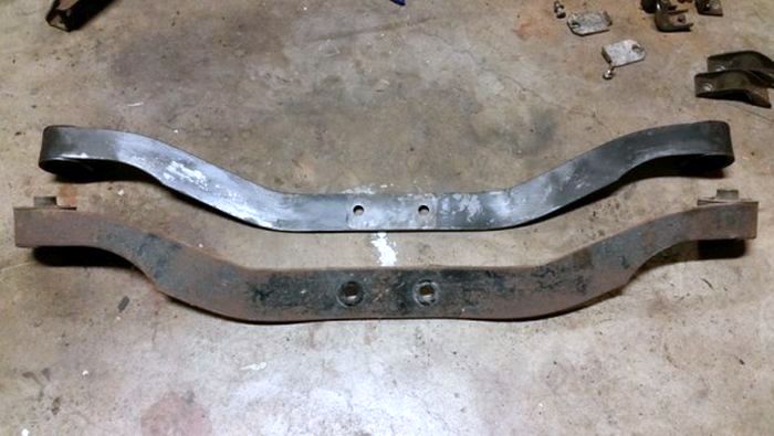

February 20, 20178 yr comment_513389 R180 on top. R200 on bottom. More beef on the R200 bar and larger holes. Copied photo. Not mine   Link to comment https://www.classiczcars.com/forums/topic/57094-mustache-bar-quandryhelp/?&page=2#findComment-513389 Share on other sites More sharing options...
February 20, 20178 yr comment_513390 The holes are not only larger, but they are not in the same place. Â When I made my emergency bar trackside, I welded the spacers on, followed by welding on the new crossbar. Â I then transfer punched the R180 holes onto the new crossbar and then offset them the correct amounts before cutting out the original bar section and drilling the new holes. I was amazed that the modified bar not only fit perfectly and lasted the remaining four hours of the race, but we actually left it in place and ran another 14 hour race with the fabricated mustache bar. Â We finally replaced it and kept it as a trophy for finishing our first 24 hour race. Link to comment https://www.classiczcars.com/forums/topic/57094-mustache-bar-quandryhelp/?&page=2#findComment-513390 Share on other sites More sharing options...

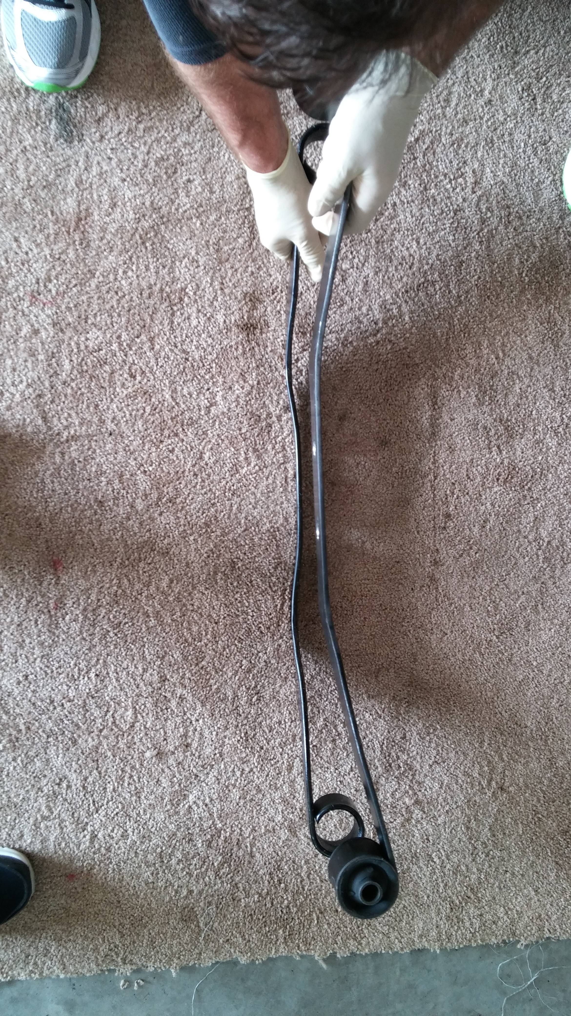

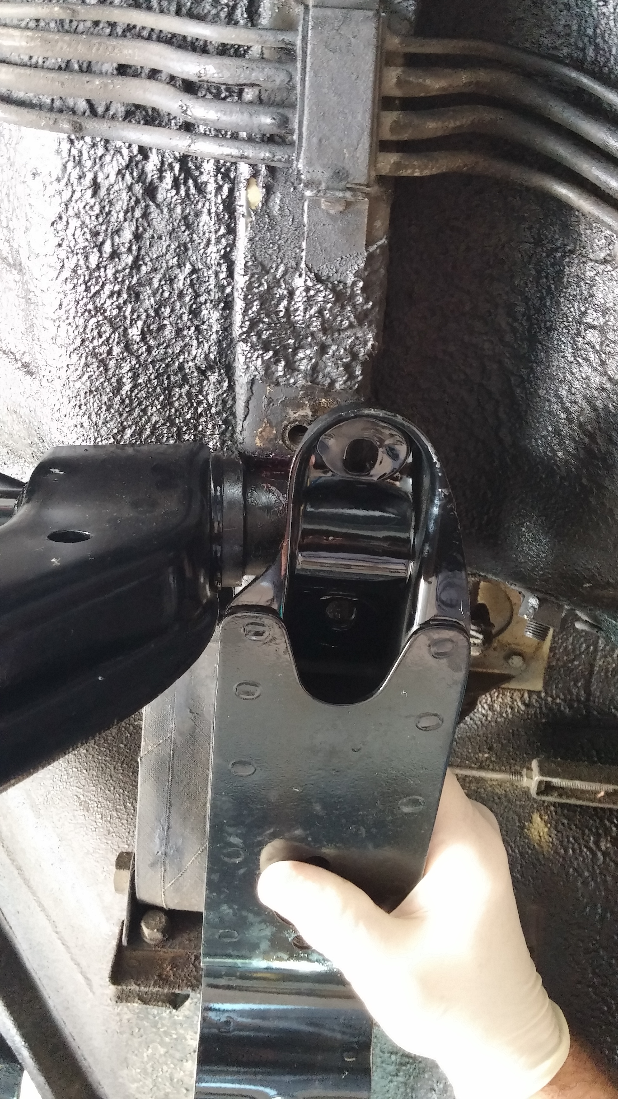

February 20, 20178 yr Author comment_513391 Here's the pics, r200 is a heavier and the bends are different. Obviously, the rear diff isn't in and the m bar is not in place (I am with my wife for just a few minutes at my shop). I am holding the cross member where it was hitting and that was as close as I could get it to the predrilled holes. Link to comment https://www.classiczcars.com/forums/topic/57094-mustache-bar-quandryhelp/?&page=2#findComment-513391 Share on other sites More sharing options...
February 20, 20178 yr comment_513395 29 minutes ago, jlenownnab said: Here's the pics, r200 is a heavier and the bends are different. Obviously, the rear diff isn't in and the m bar is not in place (I am with my wife for just a few minutes at my shop). I am holding the cross member where it was hitting and that was as close as I could get it to the predrilled holes. The top picture on the control arm. Does it hit if you put the control arm up within the travel zone? It looks like you have the control arm hanging down at about an 80' angle. Â Link to comment https://www.classiczcars.com/forums/topic/57094-mustache-bar-quandryhelp/?&page=2#findComment-513395 Share on other sites More sharing options...
February 20, 20178 yr Author comment_513398 It wasn't hitting the control arm when we were actually trying to assemble it. We tried prying the mustache bar back but the m bar was hitting the "u" shaped bracket. Link to comment https://www.classiczcars.com/forums/topic/57094-mustache-bar-quandryhelp/?&page=2#findComment-513398 Share on other sites More sharing options...
February 20, 20178 yr comment_513402 Another way of saying it is that the front mount is too far forward when you use that mustache bar. Â Somebody had a similar problem very recently, but with an R180. Â When you said "hitting" it made it sound like an obstruction issue. Â I think that you meant :"landing" or "locating" or "ending up". Â The holes don't align. I've read of people flipping the front mount. Â Don't know how much it buys you, but I think it helps for some applications. Link to comment https://www.classiczcars.com/forums/topic/57094-mustache-bar-quandryhelp/?&page=2#findComment-513402 Share on other sites More sharing options...
February 20, 20178 yr Author comment_513404 We tried flipping the front mount, still didn't work. When I say hitting I'm saying we were prying the m bar backwards so it would move everything back a quarter of an inch including the diff but we could only pry the m bar back until it hit the u shaped bracket that hangs down behind the diff and kept us from prying it more. I don't believe the bars are interchangeable with out fabrication Link to comment https://www.classiczcars.com/forums/topic/57094-mustache-bar-quandryhelp/?&page=2#findComment-513404 Share on other sites More sharing options...
