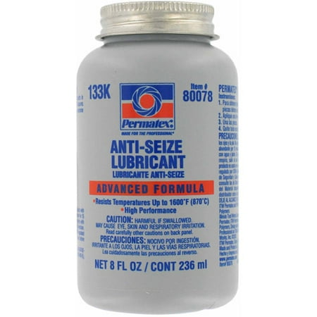

March 8, 20178 yr comment_514757 On 3/8/2017 at 12:54 PM, 240260280 said: Getting the right sealants, oils, and greases also helps. I used these two on the different builds, couldn't tell any big difference. You'll need this too in a few places And this on most all my gaskets just to hold them in place while I put things together And most of all, use this on all your threads Oh yeah, some Loc-tite Link to comment https://www.classiczcars.com/forums/topic/57204-l24-engine-rebuild-parts-list/#findComment-514757 Share on other sites More sharing options...

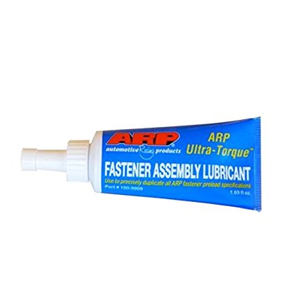

March 8, 20178 yr comment_514759 I'll add this to Cliff's list .... Link to comment https://www.classiczcars.com/forums/topic/57204-l24-engine-rebuild-parts-list/#findComment-514759 Share on other sites More sharing options...
March 8, 20178 yr comment_514760 S30Driver, did you use that on your head bolts? Link to comment https://www.classiczcars.com/forums/topic/57204-l24-engine-rebuild-parts-list/#findComment-514760 Share on other sites More sharing options...
March 8, 20178 yr comment_514761 Yes, it for all the internal critical torque fasteners. According to ARP ... Prevents Seizing And Galling On All Threaded Fasteners Designed To Reduce Tension Pre-Load Scatter And Eliminate The Need To Cycle High Performance Engine Fasteners Before Final Installation Prevents Rust And Corrosion During The Life Of The Lubricant Effective Lubrication Range -50 to 2000 Degrees Fahrenheit Link to comment https://www.classiczcars.com/forums/topic/57204-l24-engine-rebuild-parts-list/#findComment-514761 Share on other sites More sharing options...
March 8, 20178 yr comment_514762 Ok, good info! Link to comment https://www.classiczcars.com/forums/topic/57204-l24-engine-rebuild-parts-list/#findComment-514762 Share on other sites More sharing options...
