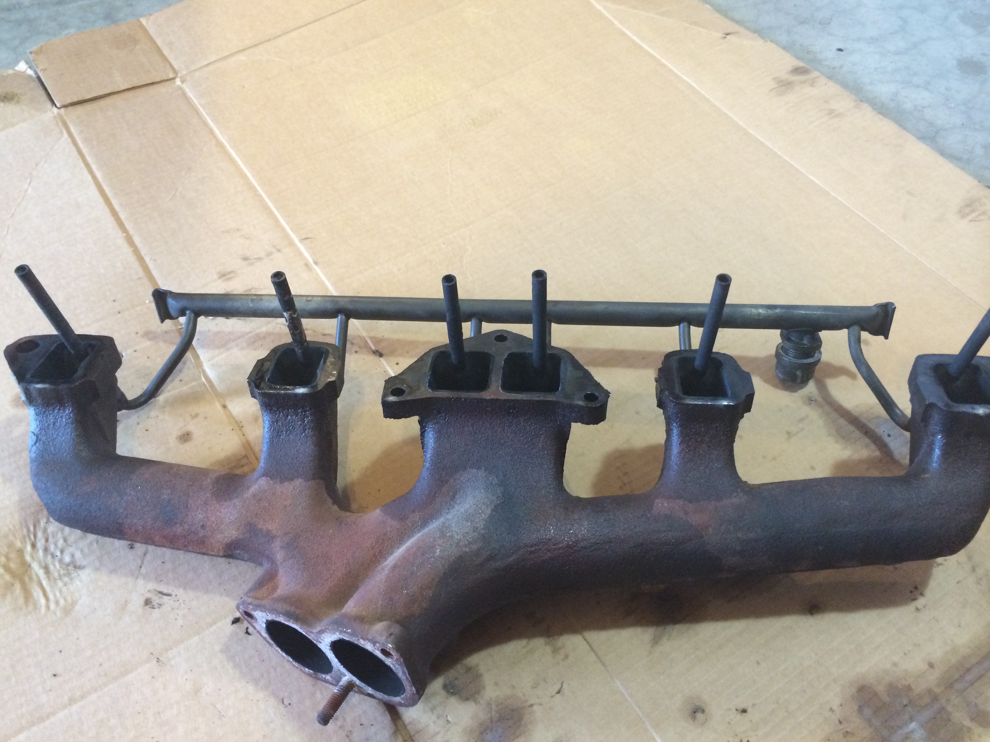

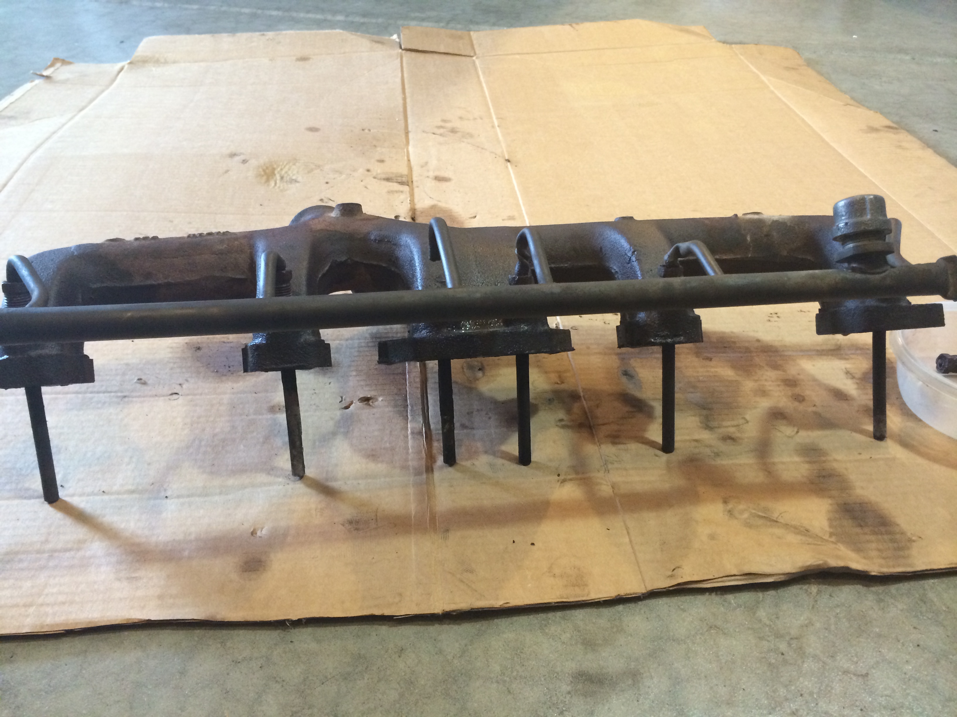

The popping on deceleration is unburnt fuel leaving the combustion chamber into the exhaust system & combusting (burning) due to the heat in the exhaust. I solved mine by removing all of my smog gear, capping off the air galley and leaning out the carbs.
The air galley is the device that the smog pump pushes fresh air into the exhaust manifold with.  Most of them are leaking or damaged by now.
