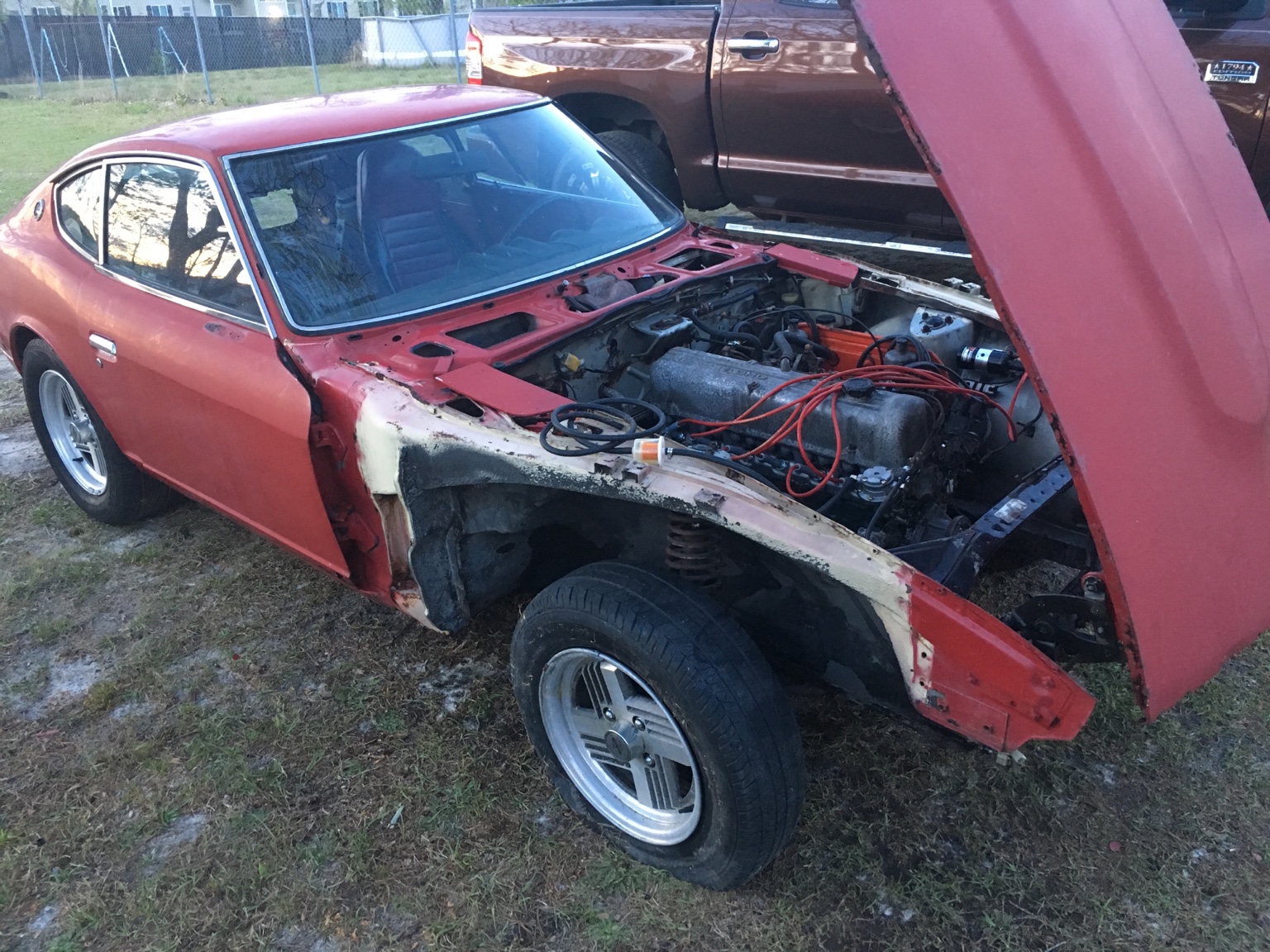

Be very careful blasting the car yourself. It is very easy to ruin these cars if you aren't careful! The metal is exceedingly thin in some areas. You can also cause work hardening or oil canning if you over heat the metal. You need a large compressor to do this right and a lot of media! Also you should be wearing a respirator!!! The dust can cause silicosis much less the nasty stuff you are blasting off in the paint
