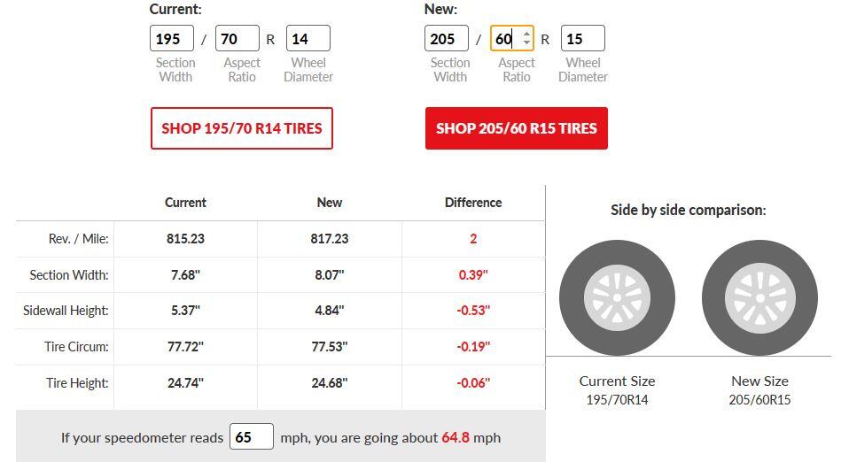

May 8, 2024May 8 comment_665149 21 hours ago, siteunseen said: Use the tire calculator that is in that thread. The 195 is the sidewall size. The lower number is the width, for mine they're 50s for width or rubber meets the asphalt footprint. Here's the calculator I used when I changed to 15x7 wheels. Tire Size Calculator | Tire Size Chart | Tire Size Conversion | Discount Tire Ended up with 205/60 R15 which calculated out to be almost identical to stock tire height (assuming 195/70-14) so when my speedo reads 65 MPH actual would be 64.8 MPH, pretty close. The 205 is tire width and 60 is a tire height percent of tire width and the R15 is the wheel diameter. Link to comment https://www.classiczcars.com/forums/topic/57378-swapping-280z-wheels-on-my-240z-with-aftermarket-15-x-7-wheels/?&page=2#findComment-665149 Share on other sites More sharing options...
