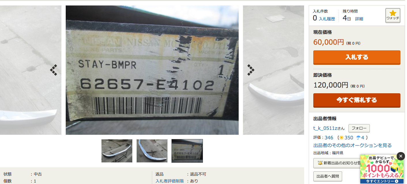

April 14, 20178 yr comment_517984 Well all I can tell is the Japanese on sticker is saying "pure parts". I guess since it had this sticker on it might be a replacement part from Nissan. By the way, if you have a bumper in rough condition pls let me know if you want to sell it (budget you know).Sent from my iPhone using Classic Zcar Club mobile Link to comment https://www.classiczcars.com/forums/topic/57499-is-this-a-unicorn-240z-front-bumper/#findComment-517984 Share on other sites More sharing options...

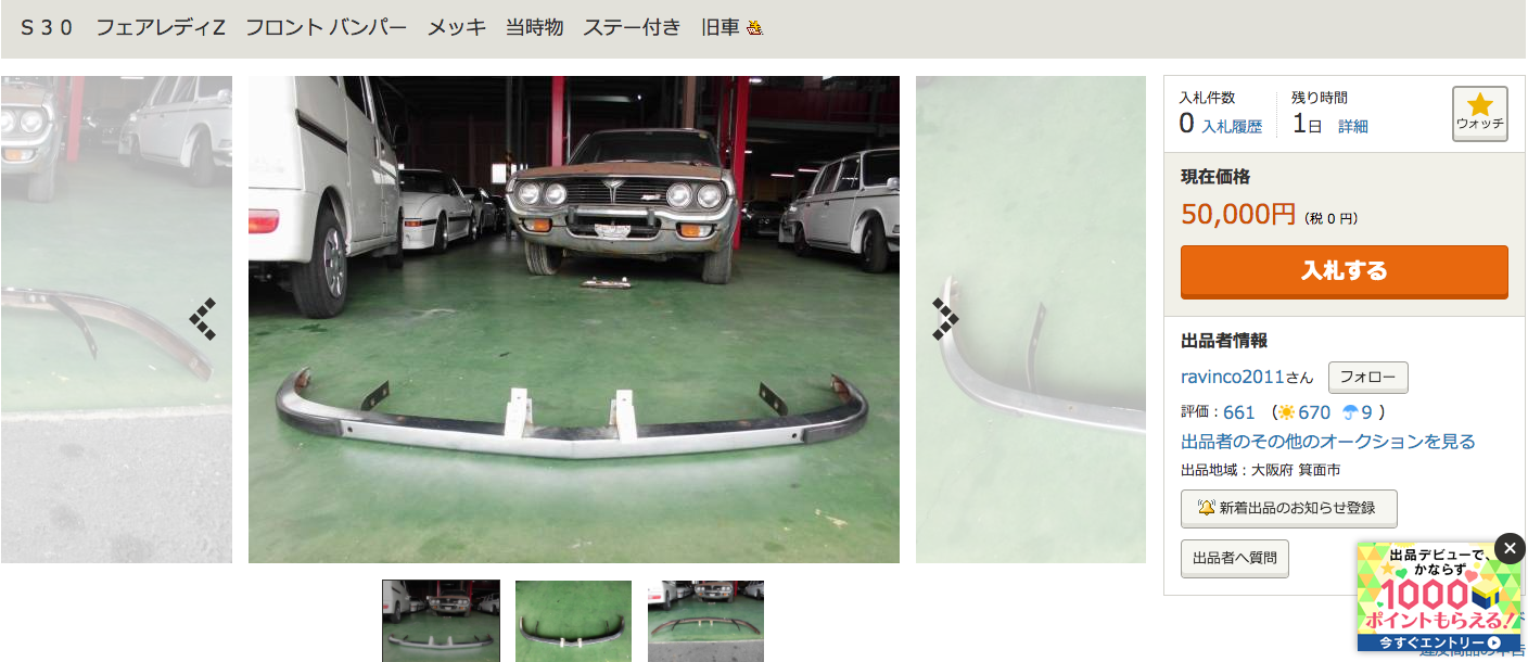

April 14, 20178 yr comment_518052 22 minutes ago, 240Ziggy said: Thanks RS02 for the translate. I guest it's a Nissan option if you don't want the bumperettes. First time i've seen this one, the rubber guards are much longer than stock. I'll try and take some photos of the three styles I have when I get a chance. I'll see what's left after I chop up a couple to make one for the ZG. No problem. I searched on Yahoo Japan and found some of the old bumpers. As you can see the rubbers are short as usual. Also I have never seen a sticker like this on a 240z part... Here is another shot at the bumper part number sticker. My guess is this might be a aftermarket bumper with a "original part" sticker on it. People sell undrilled aftermarket bumpers but they usually call them ”社外品”. I don't know. It's interesting. A early production bumper? Might be... Link to comment https://www.classiczcars.com/forums/topic/57499-is-this-a-unicorn-240z-front-bumper/#findComment-518052 Share on other sites More sharing options...
