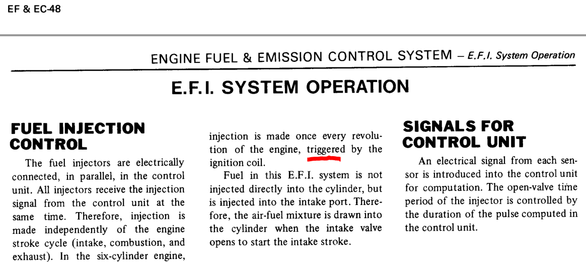

April 16, 20177 yr Author comment_518210 19 hours ago, Zed Head said: Another test for the injection system is to connect a lead to the coil's negative post. Let the other end hang free, turn the key On then tap the free end of the lead to ground to create a spark. Every third tap should cause all six injectors to click. That test works all of the parts, including the ECU. It provides a stronger spark though because the starter motor is not engaged. Why does that make the injectors fire? Link to comment https://www.classiczcars.com/forums/topic/57501-power-to-injectors/?&page=2#findComment-518210 Share on other sites More sharing options...
April 16, 20177 yr comment_518212 It's described in the FSM. The ECU uses spark counting to know the crankshaft has turned. It's a revolution sensor but not an angle sensor. As noted earlier, your car doesn't have a CAS if it's NA. Link to comment https://www.classiczcars.com/forums/topic/57501-power-to-injectors/?&page=2#findComment-518212 Share on other sites More sharing options...
