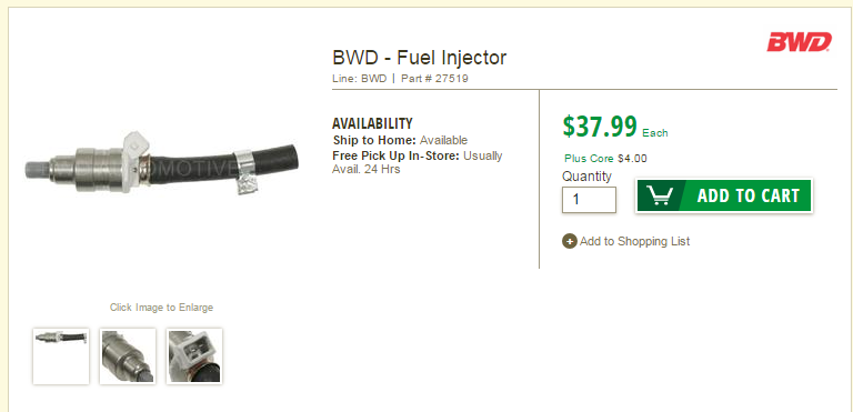

Those FJ3's look like a good deal.
The cheapy BWD's are still available at OReilly.
There are a variety of Bosch injectors that will work also, with hose length modifications.  The Bosch EFI system was licensed by a bunch of manufacturers.  They all the same basic injector.
Edit - that picture reminds me that hose clamps can be expensive also.  And you'll need new seals and maybe insulators.  Nickels and dimes.

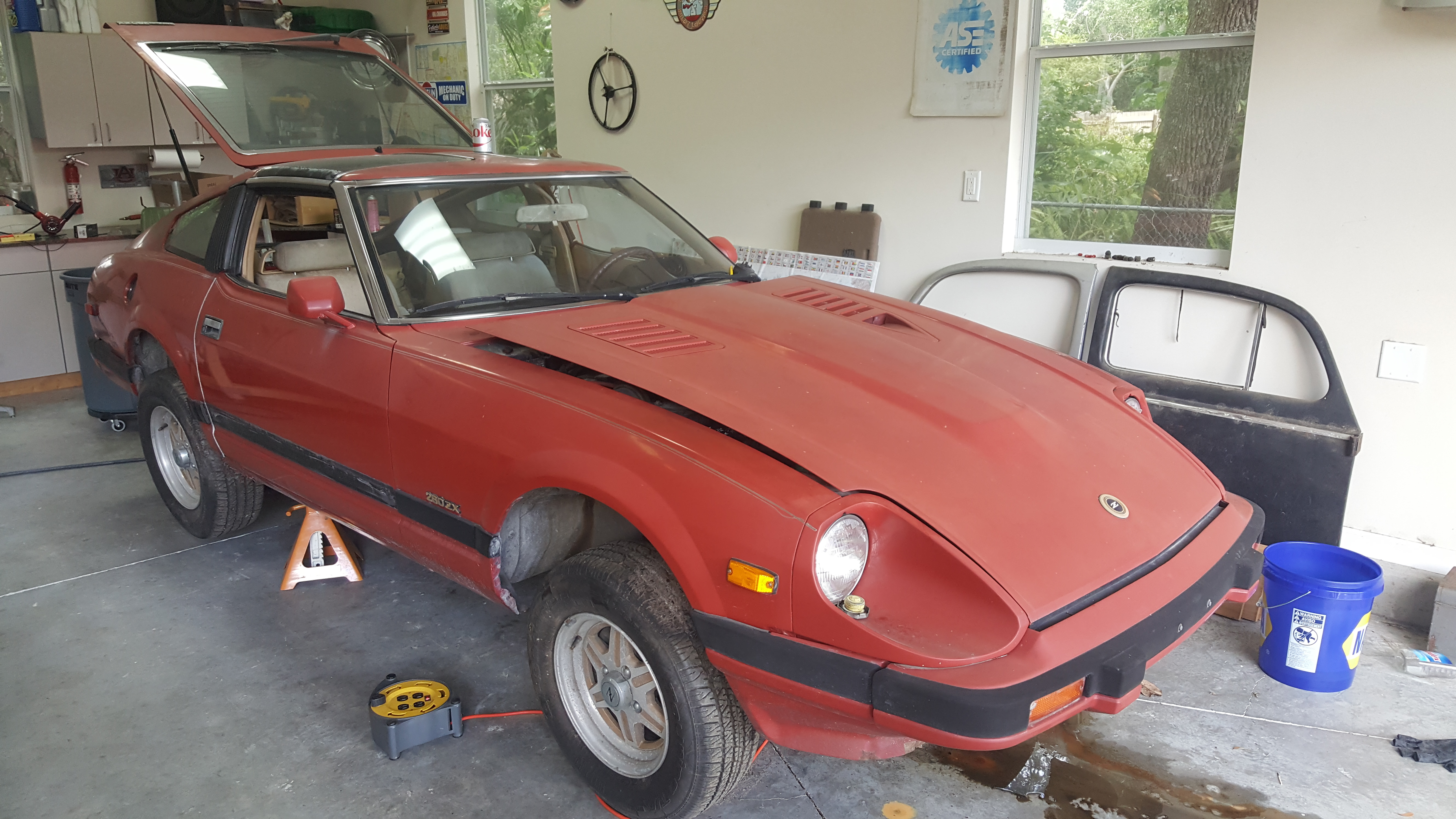

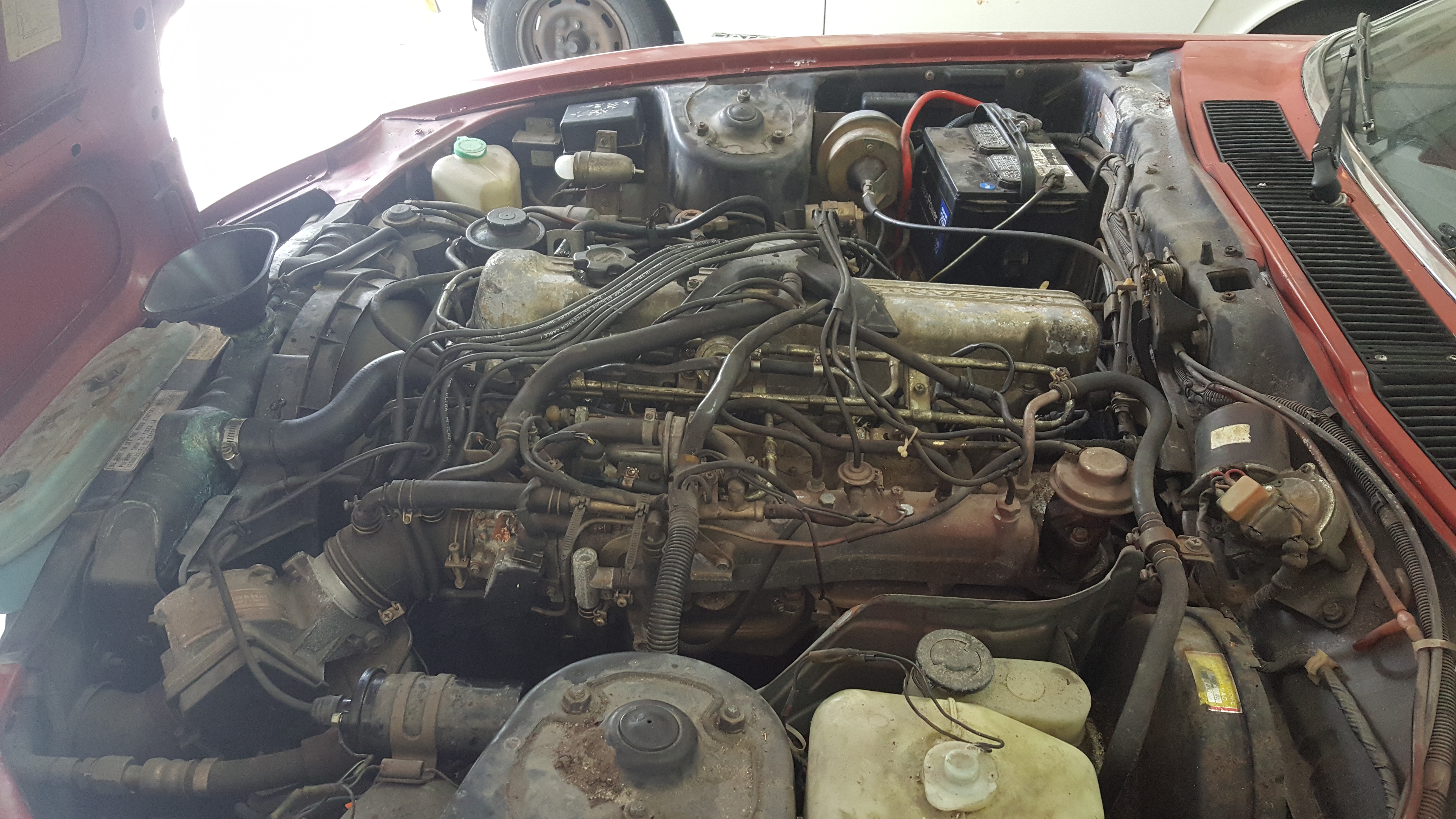

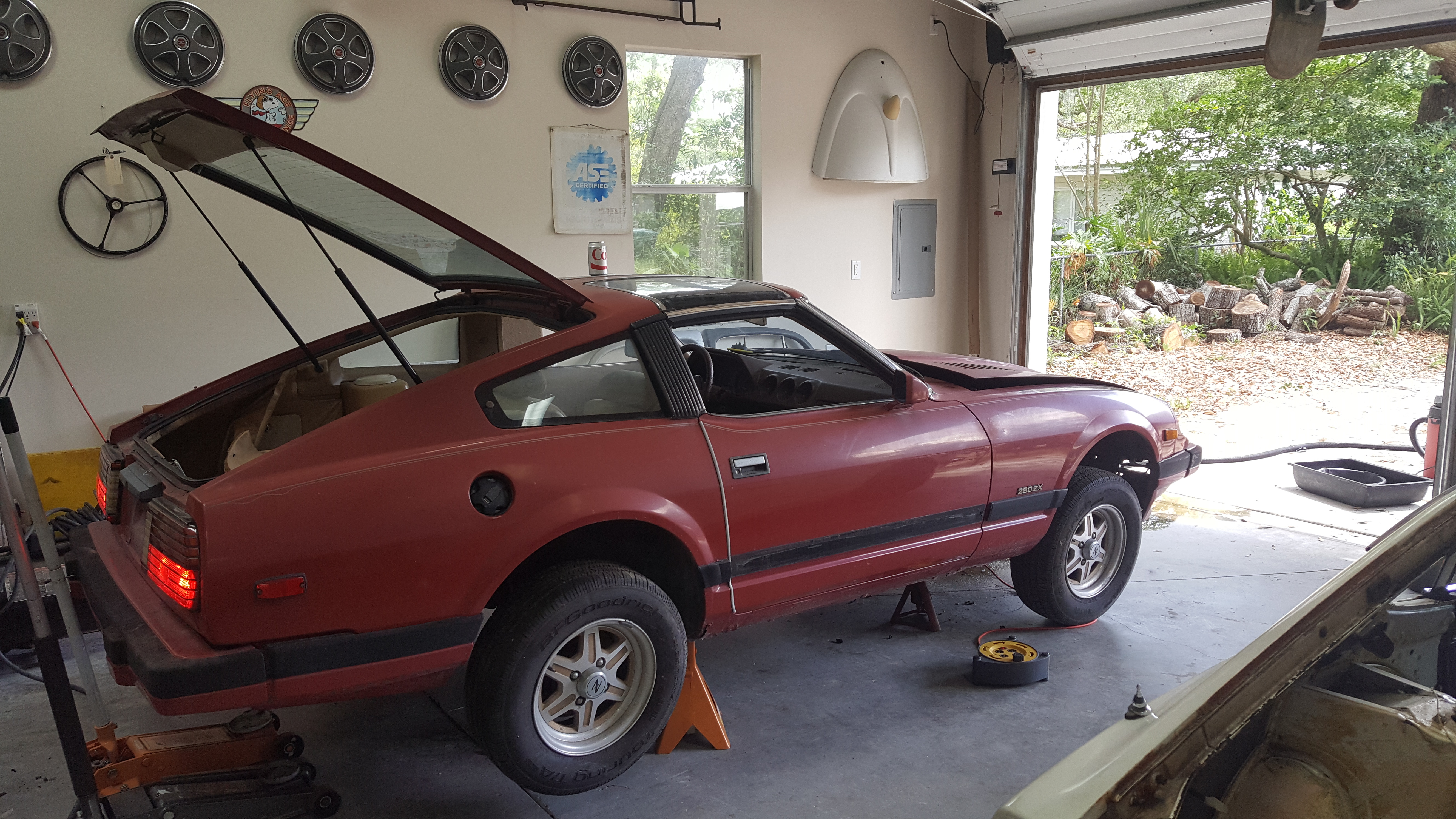

Injectors going on today, results in near future.
I'm replacing the fuel rail. Did the Q-tip test as ZH suggested, RUST! So I actually had a fuel rail in storage from years ago, nice and clean.
Success! Thanks for all the help. If you were here in the shop there would be cold beer.
Purrs like a 280ZX is supposed to. Lots of smoke from the tail pipe which cleared, a couple knocks on the top end which went away, I guess we will see if that manifests into something detrimental once on the road.
Now onto the coolant leaks.
No oil leaks, no fuel leaks. Good oil pressure, charging system working.
Edited by DC871F
Now a slight miss at idle. I really dont want to entertain debris in an injector.
A couple electrical connectors on the engine are way beyond usable (crumbly) but seem holding on while I test run engine, ignition module, etc. I rev engine to about 3K RPM and it seems smooth, but really wont know much until I get brakes finished and can do a road test.
Maybe a vacuum leak.
