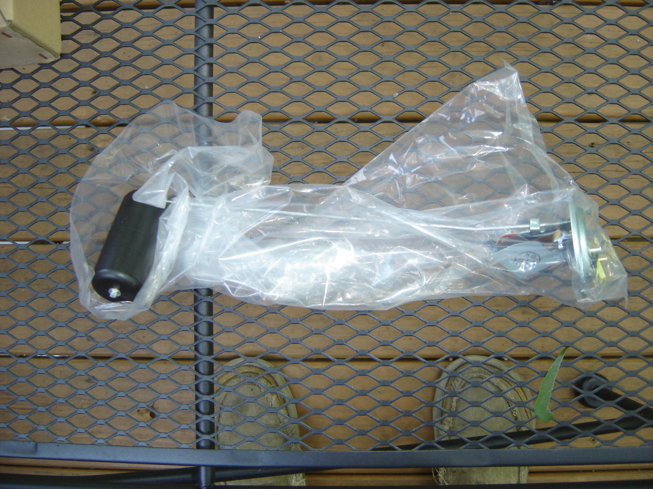

April 17, 20178 yr comment_518286 My '77 stays pretty stable while driving. Here's a couple of things to look at that'll help understand the way they work. Open the hatch and you'll find the round cover that's over the sending unit. If you touch the two wires together the gauge should go to EMPTY. EDIT!!! maybe FULL, can't remember. Edited April 17, 20178 yr by siteunseen Link to comment https://www.classiczcars.com/forums/topic/57516-stupid-gas-gauge-question/#findComment-518286 Share on other sites More sharing options...

April 18, 20178 yr comment_518340 Site, is that a new sending unit? Link to comment https://www.classiczcars.com/forums/topic/57516-stupid-gas-gauge-question/#findComment-518340 Share on other sites More sharing options...
April 18, 20178 yr comment_518373 10 hours ago, rcb280z said: Site, is that a new sending unit? Yes Sir, shiny and clean but for a 240. I don't know if the 280's are still available but the 240's are. Seems like I paid $47, plus the 0-ring it was all $50. I guess I don't drive as hard as you guys, I can't remember my needle moving while I'm driving. I do keep a full tank though. Lesson learned from my earlier days. Link to comment https://www.classiczcars.com/forums/topic/57516-stupid-gas-gauge-question/#findComment-518373 Share on other sites More sharing options...

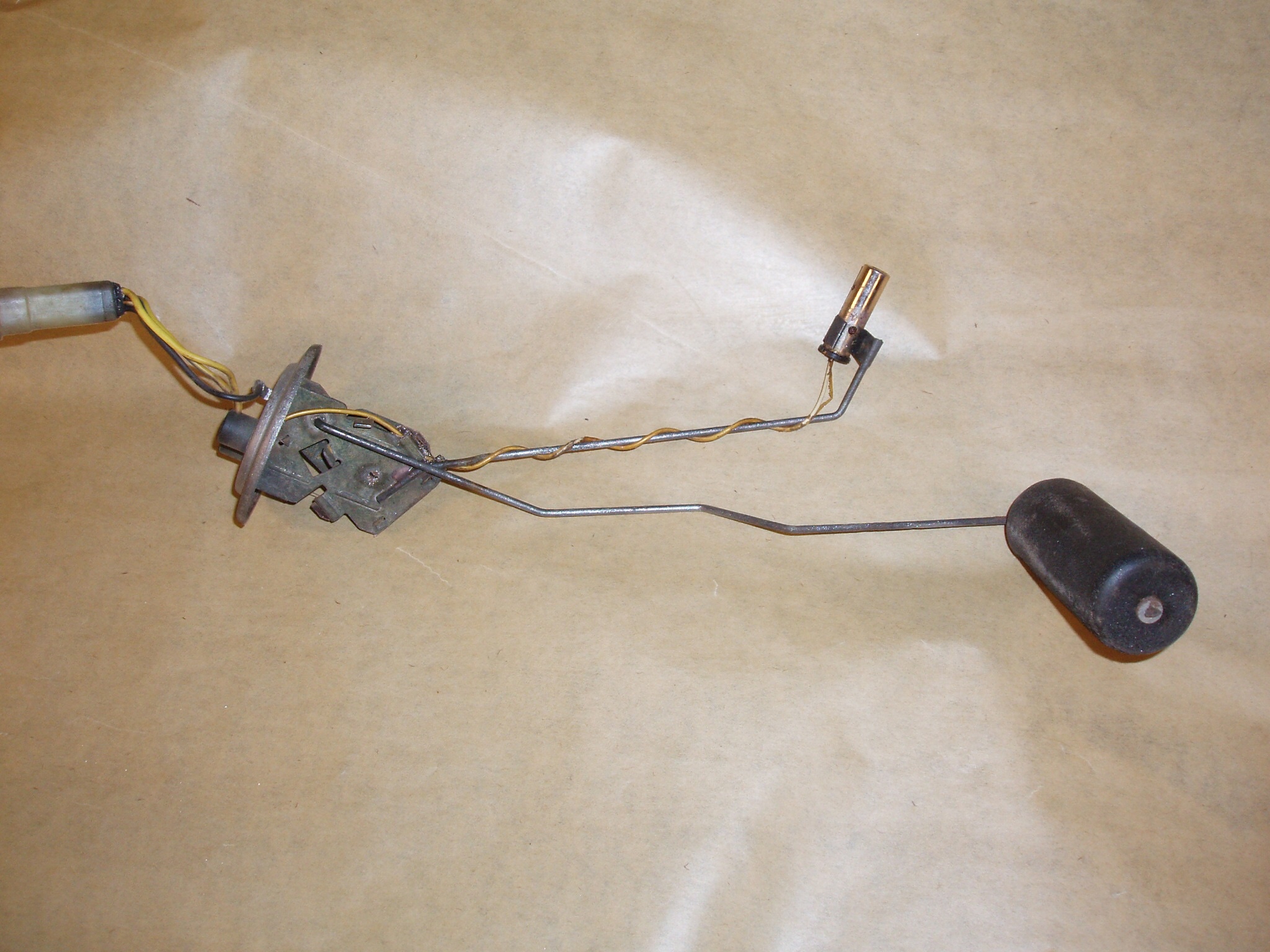

April 18, 20178 yr comment_518378 The 280 senders (side mount) have an "empty" sensor and an extra wire for that. Little red light on the fuel gauge will light up. Other than that they are identical (other than the connector) to the 240 senders if you need one and can't find a 280 sender. Edited April 18, 20178 yr by zKars Link to comment https://www.classiczcars.com/forums/topic/57516-stupid-gas-gauge-question/#findComment-518378 Share on other sites More sharing options...
April 18, 20178 yr comment_518387 The 280 senders (side mount) have an "empty" sensor and an extra wire for that. Little red light on the fuel gauge will light up. Other than that they are identical (other than the connector) to the 240 senders if you need one and can't find a 280 sender. This is true! You could build a new one out of a 240 sender! 280 one below... Link to comment https://www.classiczcars.com/forums/topic/57516-stupid-gas-gauge-question/#findComment-518387 Share on other sites More sharing options...
