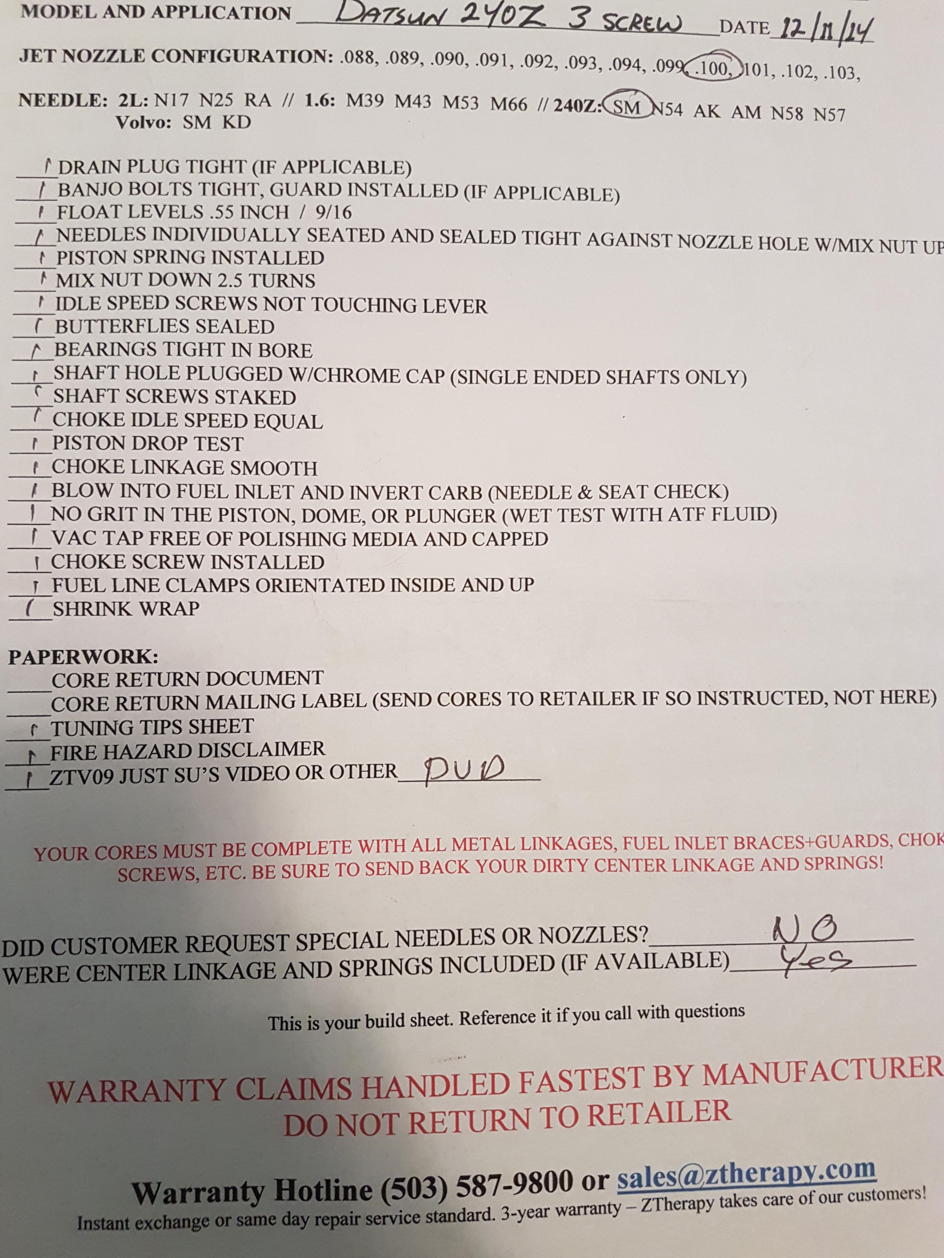

I am using sm needles on my 3 screws su carbs with a modified  2.6 liter engine and  schneider 274f and its impossible to have a smooth idle with them. I guess they are still too rich at idle. So rich plugs start to foul and engine tends to stall on traffic jams. Using atf as damper oil.
Edited by jalexquijano
