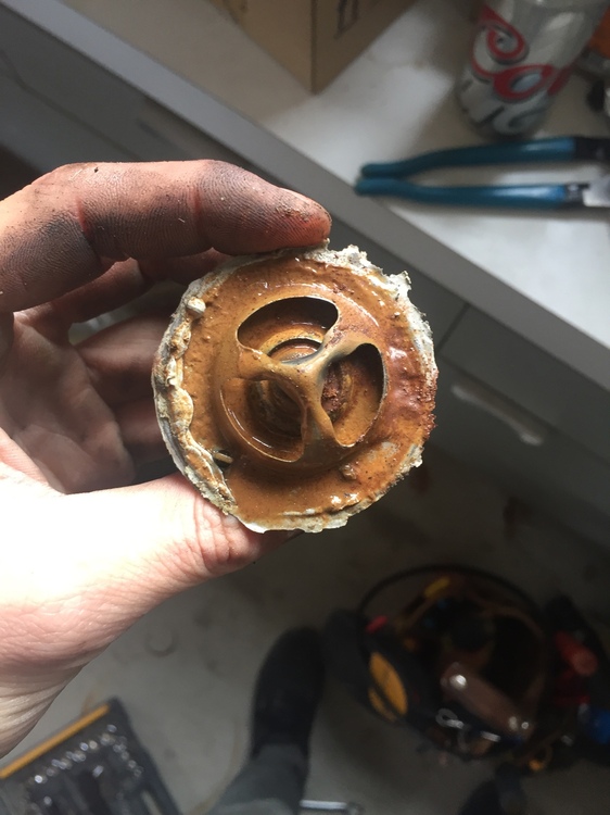

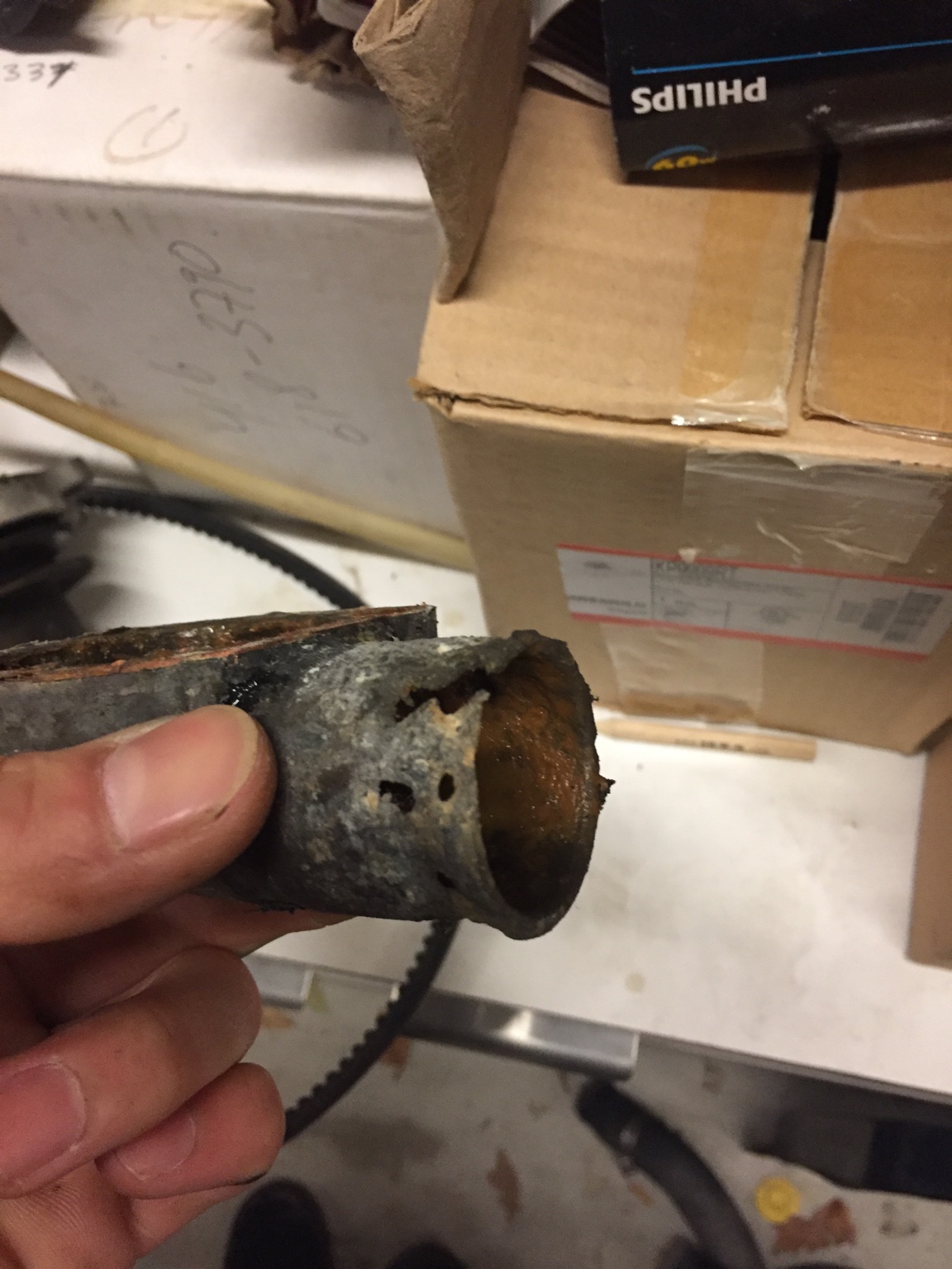

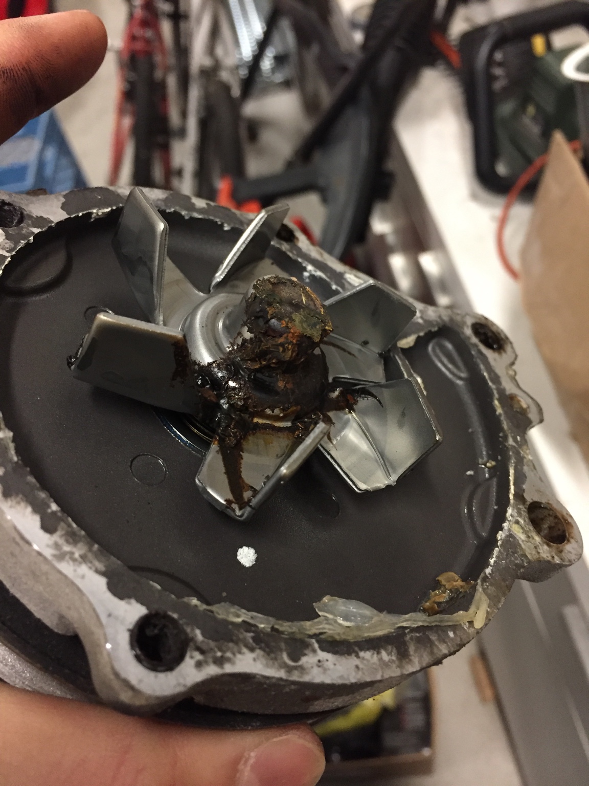

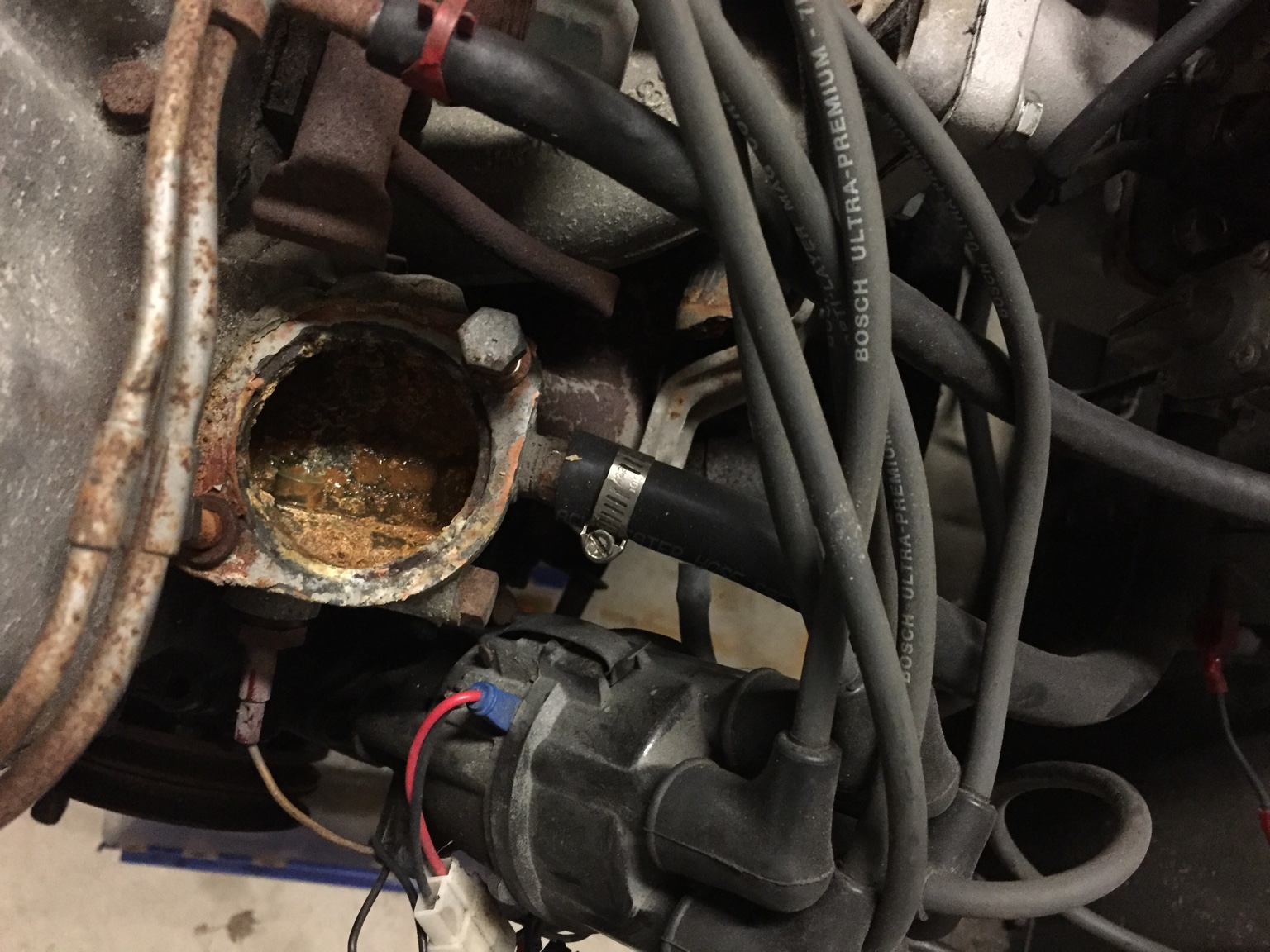

Coolant's definitely leaking from the rad core and the rad cap seal is in mediocre condition. The water jackets are definitely obstructed looking at its condition just from inlets/outlets. There is some thick rusty/calcium-y/iron-y stuff gunked on in many places, BUT hardly anything came out with the coolant. I plan to replace the rad with a mishimoto 2 core and a slim dual fan shroud to support 12"electric fans.
Question regarding coolant: Where the heck is the drain plug for the water jackets on the block? I have seen one by the starter motor, and one tucked behind the manifold, but neither on mine /: (I spun the coolant out with the water pump manually to get it out of the lower rad hose)

Wes, If you are going to tackle the cooling system I would advise you to do the entire system on the first go around, the system works very well in stock configuration but the inside water passages of the engine block and rad have to be CLEAN.
Rust and corrosion don't transfer heat very well so you need to get that crap out first, while the system is all still together run some good quality radiator flush through it and don't forget to open the heater valve as well. I have also used CLR on occasion and it worked well. Then after the engine cools off flush the whole system with fresh water from the garden hose until it runs clean. You will probably be the first guy in 40yrs to have cleaned that system so expect a lot of brown crap to come out. Then replace the rad, thermostat and maybe the water pump, no more anxiety gaugeLOL

You'd be suprised how much the radiator has lost capacity since it left the factory ! Once mine got a new core, things changed drastically, even on a super hot day, the temperature stays moderate.  But a good flush like you said and a new thermostat could do alot.
@bartsscooterservice I'm not talking so much about the rad, they have a life span and some are better than others, I'm talking mostly about inside the water jackets and the corrosion that can build up just as notWes has shown us in his pics.  And it is not just poor heat transference, the corrosion can actually plug up coolant passages and water jackets so the engine can end up with hot spots that screw up the rings in extreme examples.
Okay. Yes that's a big problem to.. When the engine shop rebuild my lower block there was alot of crap coming out for sure.
