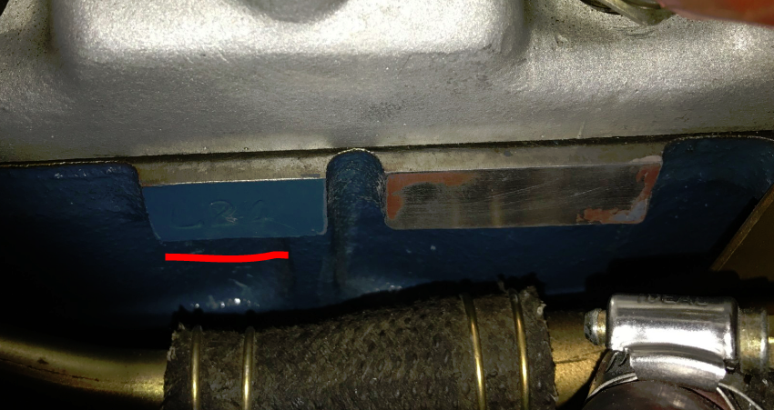

Those informations are very interesting for me. The seller tells me that it is the original engine and it's not. What are the looking differences between an L24 and an L28 engine ? Do they have a number plate to see the difference ?

See the link from K-TeeZ, above, there's a picture showing where the stamp is that  shows engine size, on the side of the block.

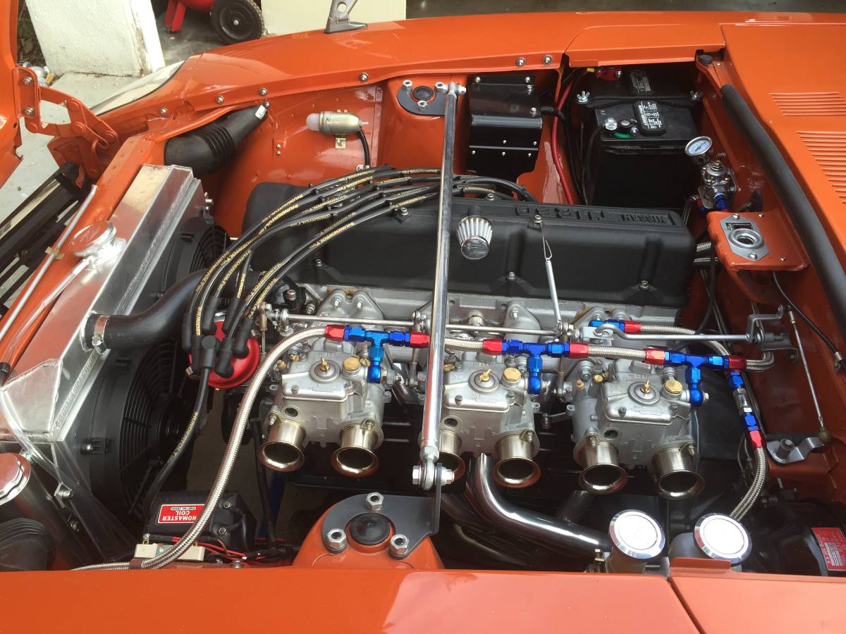

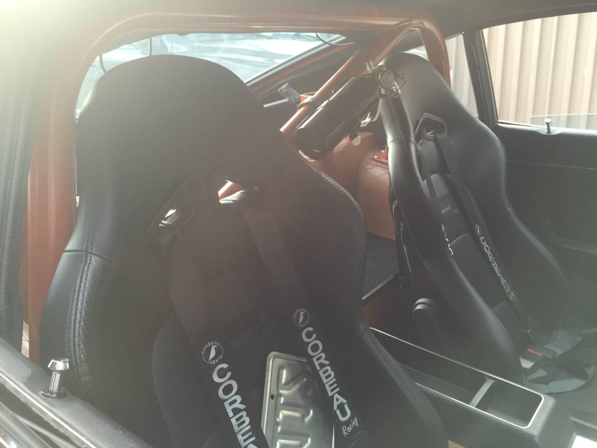

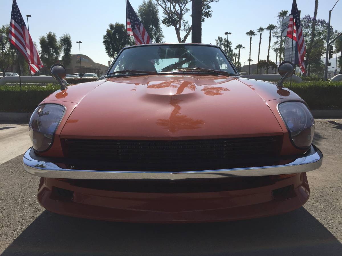

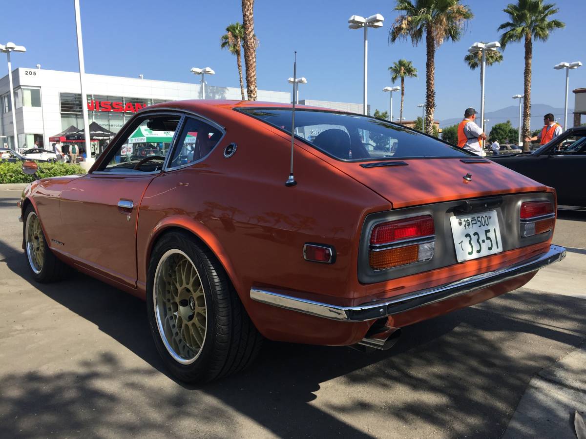

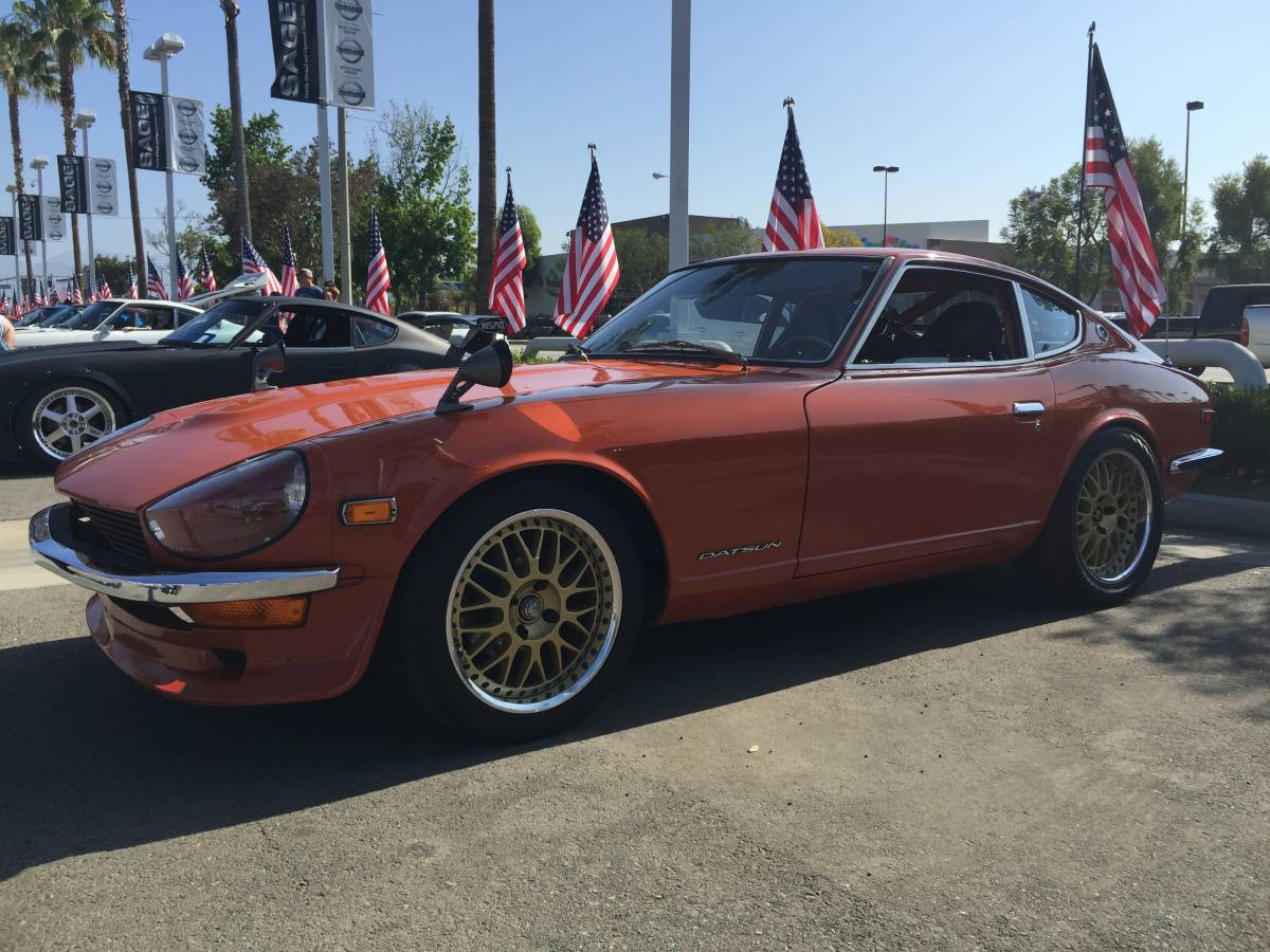

Here is another 240z, it seems to look good but I don't have many informations about it for the moment.
Maybe the previous owner is still around here.
What do you think about it ?
It needs at least factory seats and gauges IMO.
Amy glad you are still on the hunt. Maybe I missed it, but can you tell us how you plan to use the car?  The orange one has been taken in a direction to fulfill the dreams of a particular persons taste.  Does this look appeal to you?  Do you prefer stock?  How much do you want to work on the car?  Is it intended to be a daily driver.
We can look at any Z and comment on condition and parts and fitment,etc.  However, without knowing a bit about you, we cannot make a good match for you and your desires and wants. The car should fit the driver, and the driver should fit the car.
Good question Zedyone_kenobi
I already have a daily drive and a track car which is highly modified.
I'm looking for a light to medium modified 240Z. I like when they have front lip, rear spoiler, Watanabe wheels, engine can be modified too but without too much modifications (like a turbo).
I want it for cruising or sporty trip.
For example, I like the look of the orange one but I don't like the sport seats (I would prefer original or classic sport seats) or the modified gauges that looks too new for me.
I'm more looking for an advice on the condition of the car and the parts that it has on it.
