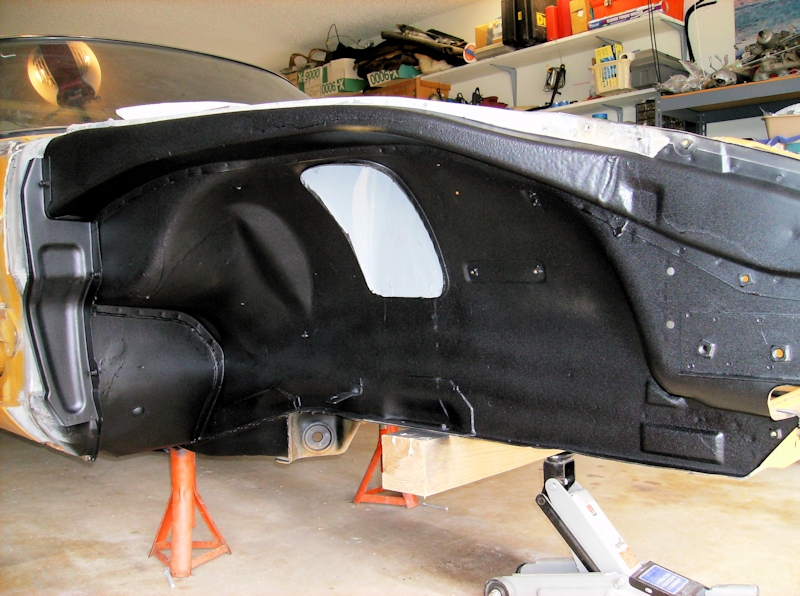

April 25, 20177 yr comment_519095 I did both on the front, as 26th-Z has suggested. Truck bed liner went on the front as a stone chip protective layer - except for the shock tower as I did not want to encourage any moisture retention. The tower was first coated with POR-15, then brush painted in body color, The rest of the area was sprayed in body color. Link to comment https://www.classiczcars.com/forums/topic/57566-wheel-wells-body-colour-or-black/?&page=2#findComment-519095 Share on other sites More sharing options...
April 25, 20177 yr comment_519155 I realize that body color is really the correct method but I went black because I didn't want to see bright yellow from the wheel wells around the black tires. Final body color might influence the decision. A darker color in blue or green, I probably wouldn't have bothered Link to comment https://www.classiczcars.com/forums/topic/57566-wheel-wells-body-colour-or-black/?&page=2#findComment-519155 Share on other sites More sharing options...
