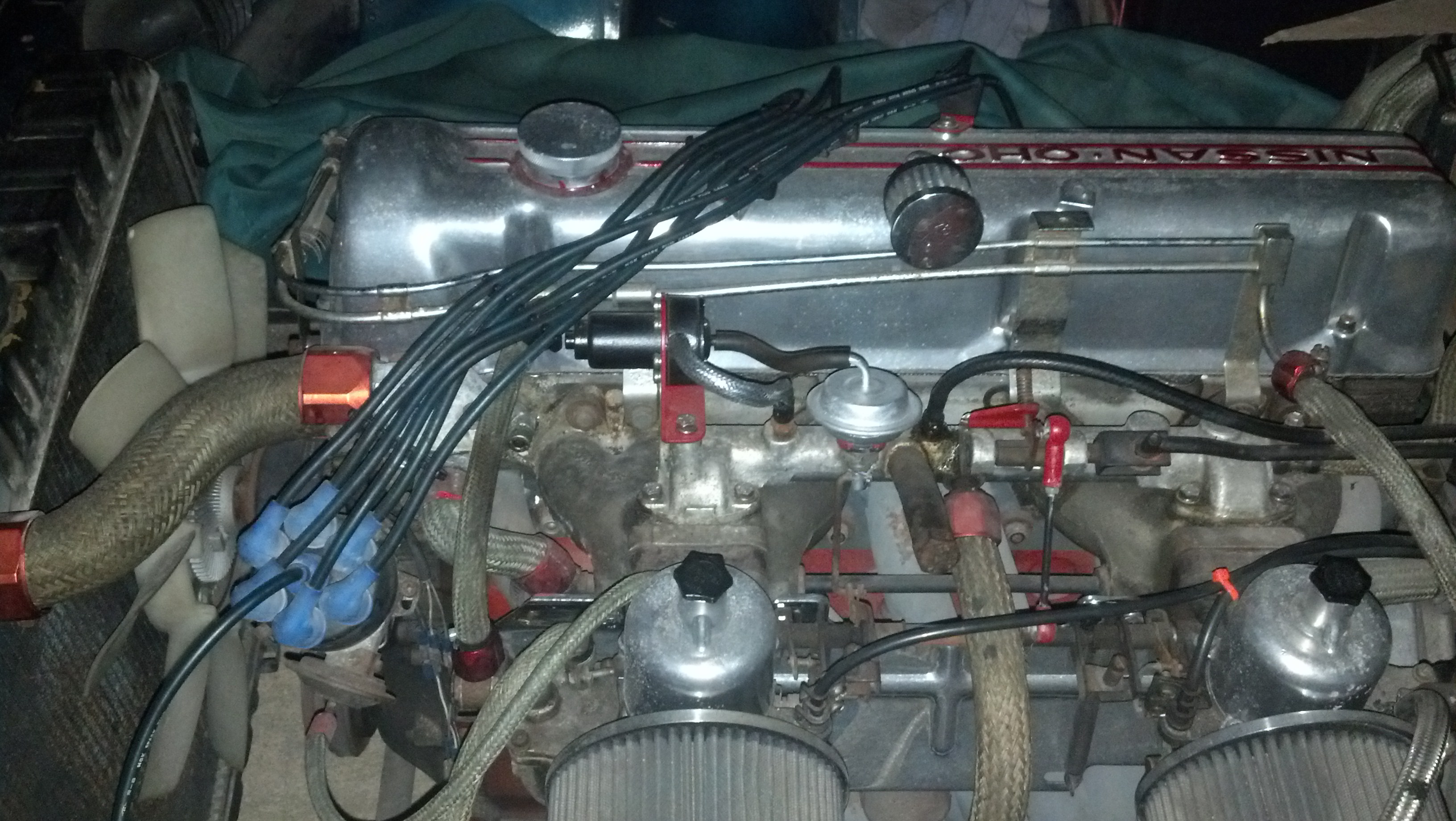

August 1, 20177 yr Author comment_527178 Hey all, I finally had time to open the valve cover and found these floating around...I'm assuming this is what is causing the compression issue. Link to comment https://www.classiczcars.com/forums/topic/57728-engine-rebuild/?&page=3#findComment-527178 Share on other sites More sharing options...
August 1, 20177 yr comment_527180 Yikes! Lash pads! Link to comment https://www.classiczcars.com/forums/topic/57728-engine-rebuild/?&page=3#findComment-527180 Share on other sites More sharing options...

August 1, 20177 yr comment_527187 1 hour ago, Kirob24 said: Hey all, I finally had time to open the valve cover and found these floating around...I'm assuming this is what is causing the compression issue. Is that what is commonly referred to as a proper SWIPE PATTERN? I have been trying to find this out forever. A very good picture of it BTW Link to comment https://www.classiczcars.com/forums/topic/57728-engine-rebuild/?&page=3#findComment-527187 Share on other sites More sharing options...
August 2, 20177 yr Author comment_527200 On 5/15/2017 at 6:55 PM, Mark Maras said: If you can, take pics when you remove the cover. We all want to see what gremlin lurks under it. Here is what I saw Link to comment https://www.classiczcars.com/forums/topic/57728-engine-rebuild/?&page=3#findComment-527200 Share on other sites More sharing options...
August 2, 20177 yr comment_527205 Others have more experience but it's looking like at least one, maybe, two valve-piston collisions occurred, bending the valve. That would explain the noise and the pressure readings, and the misplaced retainers and lash pads. That's what those parts are, they hold the valve spring to the top of the valve. Without those parts the valve can slip down and the the piston will hit it. You can probably get by with just removing the head and having it repaired. Look closely at the round piece on the top of every valve and you'll find the two that are different. I can't really see it in your pictures, they're dark. Link to comment https://www.classiczcars.com/forums/topic/57728-engine-rebuild/?&page=3#findComment-527205 Share on other sites More sharing options...
