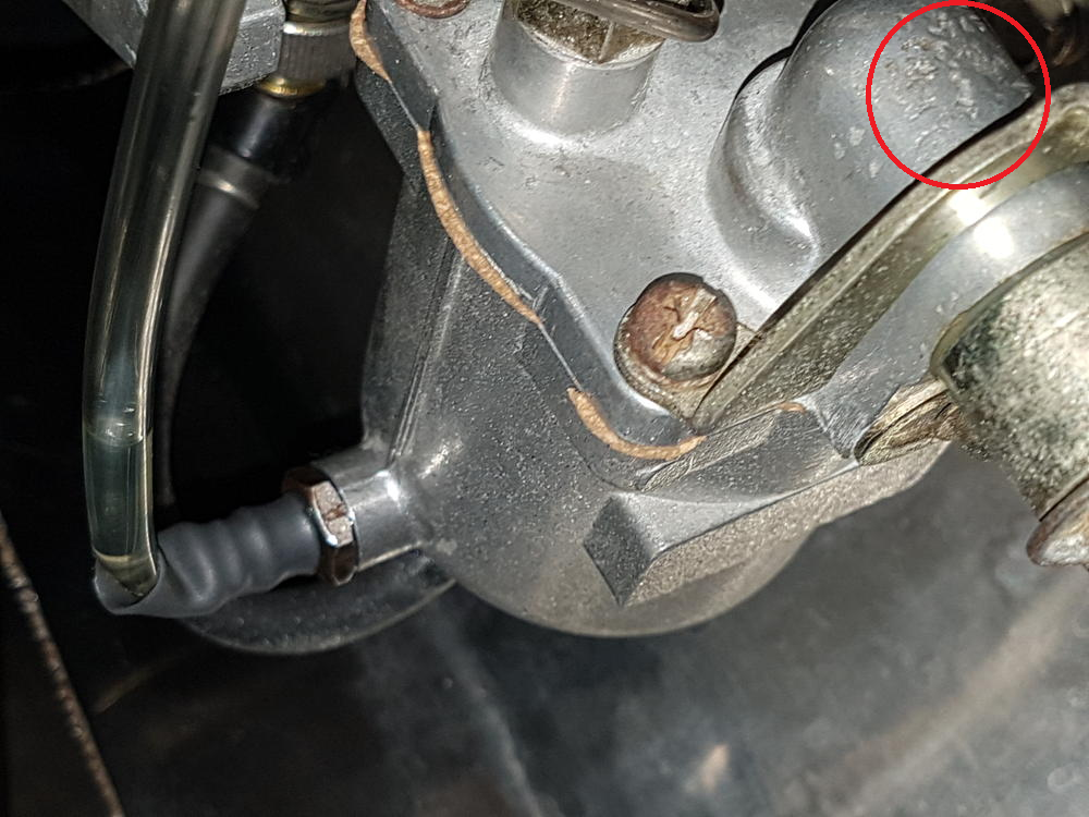

February 18, 20187 yr Author comment_542674 19 hours ago, Stanley said: Yes, use the long valve in the front bowl and put the float back in the original holes like Nissan intended. The fuel level needs to be lower in the front bowl and that makes it easy. What happened with the ztherapy plastic sightglasses in the first post ? That's what I use. Or the ones by Randalla. Or use the "both nozzles at same height, same fuel level in the nozzle" method. If you can use either of those methods why bother measuring .55 inch or whatever ? That method is a little iffy, even if it's in the FSM. Make sure the car's sitting level, not on a sloping driveway while setting the floats. What if i decide and fasten the long needle valve on the front float lid and move upper to the original ear holes and then fasten the pair of tubes to the drain holes on both carbs? How high should the fuel be in both carbs? Link to comment https://www.classiczcars.com/forums/topic/57733-checking-correct-fuel-level-at-round-top-3-screw-su-carbs-float-bowls/?&page=3#findComment-542674 Share on other sites More sharing options...
February 19, 20187 yr comment_542684 It sounds like you're taking it back to original design. I believe that you're shooting for 23 mm in the front bowl and 21 mm in the rear. Someone, anyone, correct me if I'm wrong. Opinions vary on these measurements. Most seem to like the 21 mm in the rear and if the difference in pivot point height is 2 mm, 23 mm in the front would be a good starting point. BUT you'll never truly know if the floats are correct until you pull the domes, pistons and look at the fuel level in the nozzles, 2 1/2 turns down. Then and only then will you know for sure if they're right. Link to comment https://www.classiczcars.com/forums/topic/57733-checking-correct-fuel-level-at-round-top-3-screw-su-carbs-float-bowls/?&page=3#findComment-542684 Share on other sites More sharing options...
February 19, 20187 yr Author comment_542701 any pictures so i can guide myself after removing both drain plugs and installing the sight clear plastic tubes i bought from ztherapy in order to set the correct level on both carbs? i hope i can dial both su carbs at 2.5 turns clockwise equally. Link to comment https://www.classiczcars.com/forums/topic/57733-checking-correct-fuel-level-at-round-top-3-screw-su-carbs-float-bowls/?&page=3#findComment-542701 Share on other sites More sharing options...
February 26, 20187 yr Author comment_543280 On 05/15/2017 at 7:50 PM, Randalla said: Bruce and Z Therapy don't have them. I'm the manufacturer and sell them on Ebay for $69.95. I had the same issue as many others so I designed this product. The nice thing about them is that you can check fuel levels with the running or not Are you still selling this float synch tool? I have tried setting the 23mm with the hoses and clips i purchased from Bruce but its becoming a complete nightmare and i want to move further with this float adjustment. Link to comment https://www.classiczcars.com/forums/topic/57733-checking-correct-fuel-level-at-round-top-3-screw-su-carbs-float-bowls/?&page=3#findComment-543280 Share on other sites More sharing options...
February 26, 20187 yr Author comment_543281 On 02/18/2018 at 7:32 PM, Mark Maras said: It sounds like you're taking it back to original design. I believe that you're shooting for 23 mm in the front bowl and 21 mm in the rear. Someone, anyone, correct me if I'm wrong. Opinions vary on these measurements. Most seem to like the 21 mm in the rear and if the difference in pivot point height is 2 mm, 23 mm in the front would be a good starting point. BUT you'll never truly know if the floats are correct until you pull the domes, pistons and look at the fuel level in the nozzles, 2 1/2 turns down. Then and only then will you know for sure if they're right. Can you explain the 10 turns method more precisely? Should i warm the car for 2 minutes and then proceed with the 10 turns clockwise or should i just open both float lids and measure the fuel height with caliper stick? Link to comment https://www.classiczcars.com/forums/topic/57733-checking-correct-fuel-level-at-round-top-3-screw-su-carbs-float-bowls/?&page=3#findComment-543281 Share on other sites More sharing options...

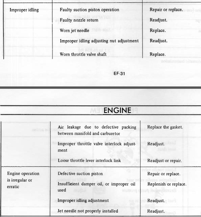

February 27, 20187 yr comment_543347 As much as I've enjoyed watching this journey for the last few years, I think there are a few buggered up issues to sort out and it might be a good idea to start fresh by checking all possible causes of the exhibited symptoms before making any more carb adjustments. Below are the troubleshooting steps from the factory manual. Each item should be checked before moving on to carb adjustment. According to the manual, fuel pressure can be in the range of 3.41 to 4.27 psi. More, or less, will cause less than optimal operation. Fuel capacity is another issue. Delivery should be 1600 cc (3 3/8 quarts) per minute (static test). At this point, I'm leaning toward "operator error" rather than "mechanical failure". In 47 years I haven't had that much of a problem with fuel delivery or carb adjustment with mine just following the factory manual and using a uni-syn and a Colortune. Good luck! Dennis Link to comment https://www.classiczcars.com/forums/topic/57733-checking-correct-fuel-level-at-round-top-3-screw-su-carbs-float-bowls/?&page=3#findComment-543347 Share on other sites More sharing options...
