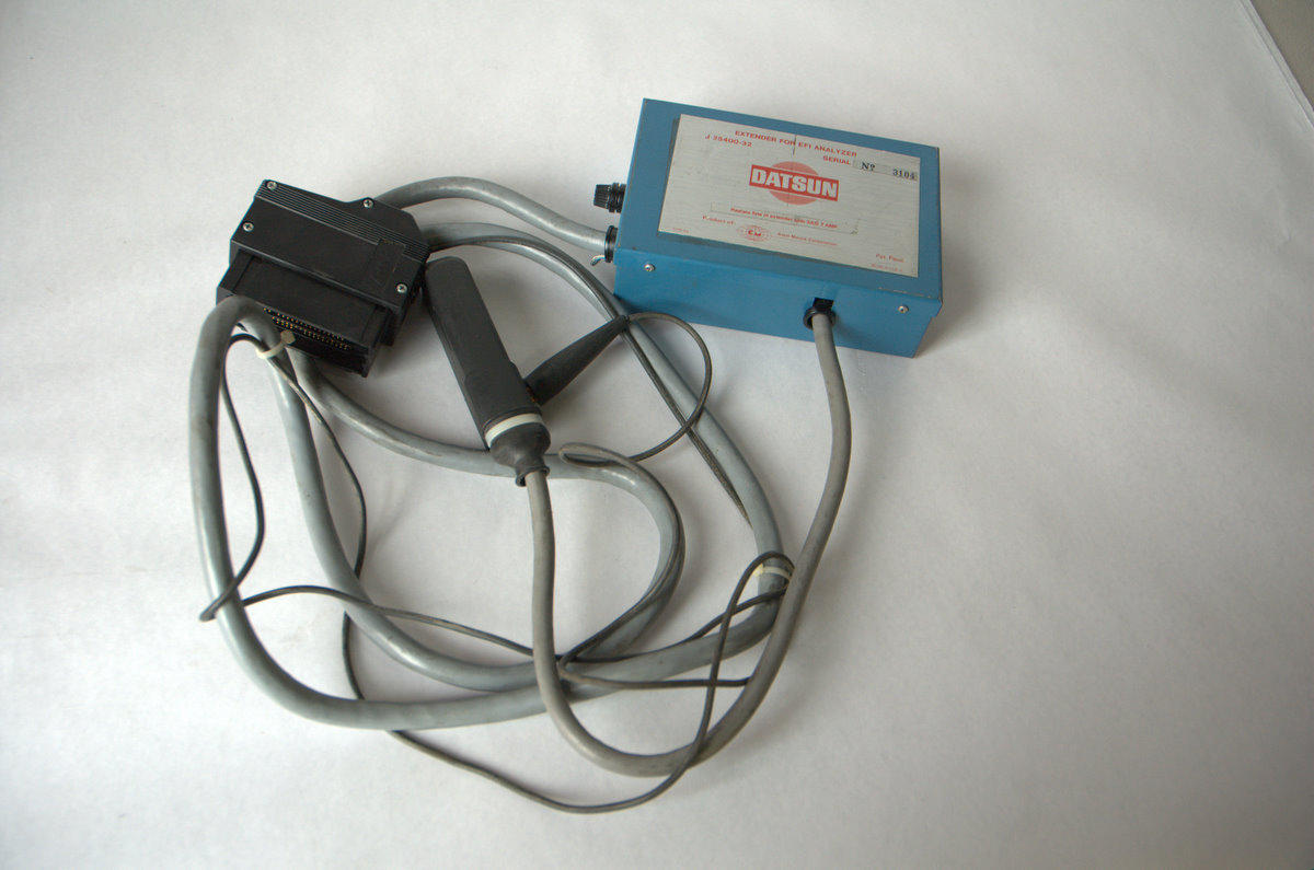

I found some pic's on the net that are the  supposed parts one would need if he wants to check a 1979 280zx EFI system..
This is a J25400-32   I read i need a J24500-36 adapter to check a 280zx s130 1979 model..

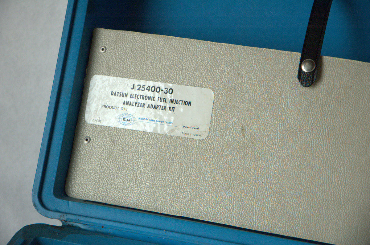

On the sticker it says J25400-30 ? huh...

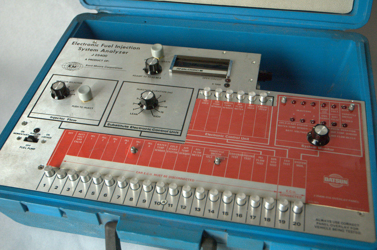

On my analyzer is a blue overlay. I need the red overlay with DATSUN on it.. But i could use some tape over the blue overlay and copy what's on the red one haha. (i bet there is not much difference.)

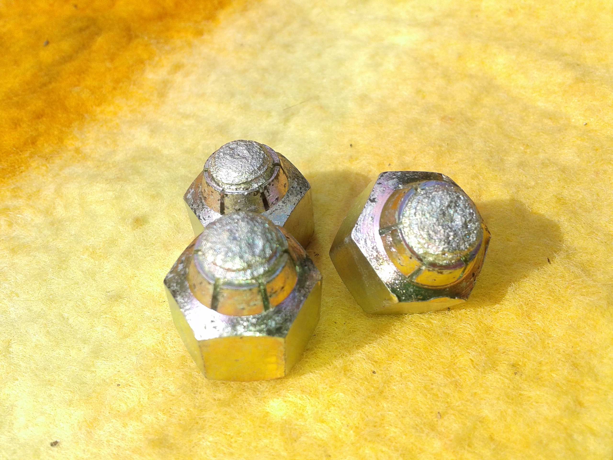

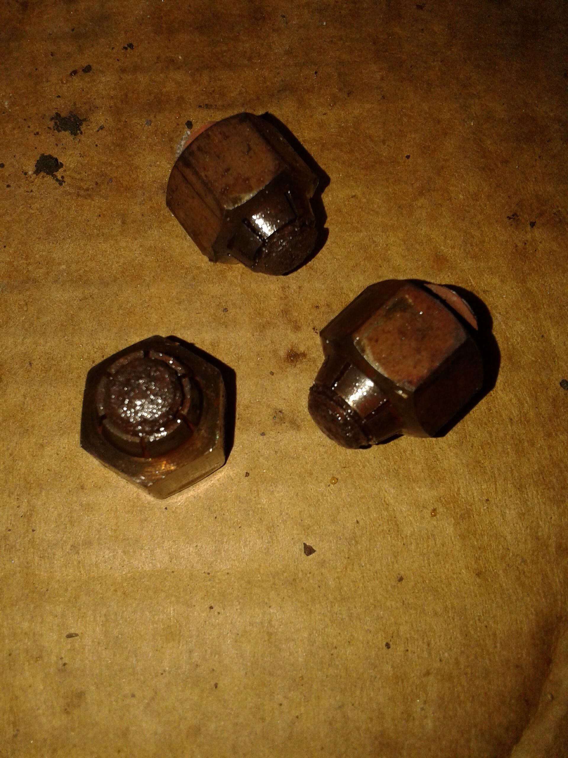

Exhaustflange nuts (these where luckily the only ones that broke off besides one on the engine that i have already repaired..)

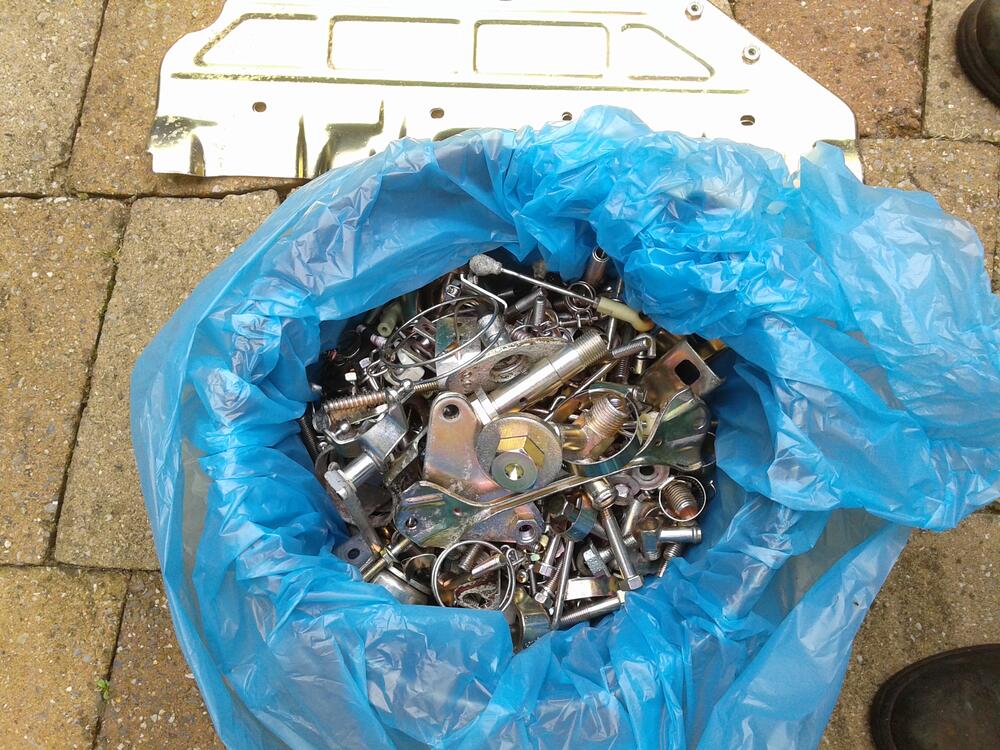

So i need to do these 3 bolts in the exh.manifold... (I have sended these nuts with 35-40 kg of old parts to the company that passifies these parts so they come back as a very clean part.. drill them out, tap them and will try to reuse them!)

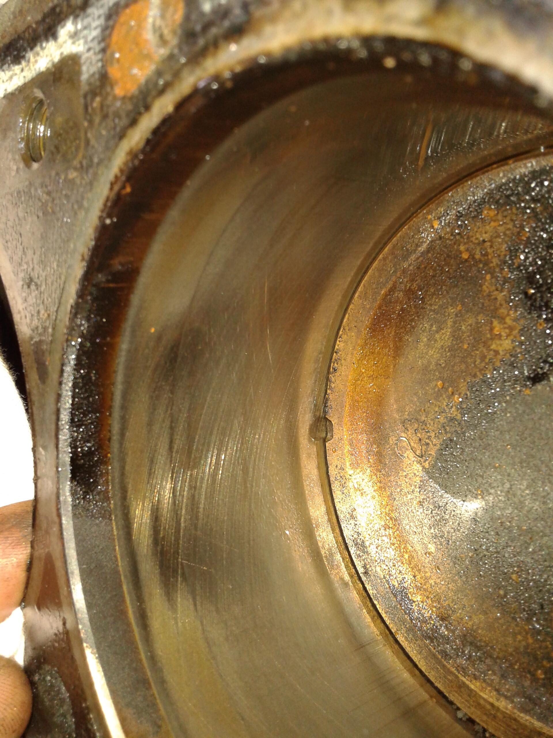

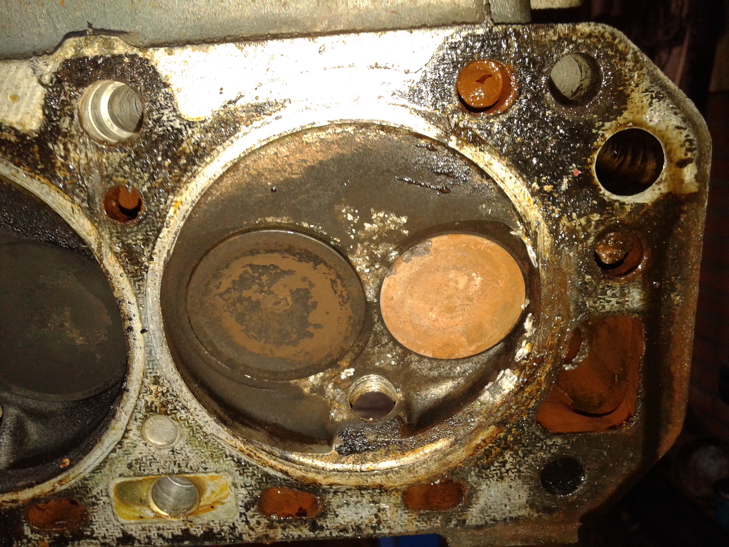

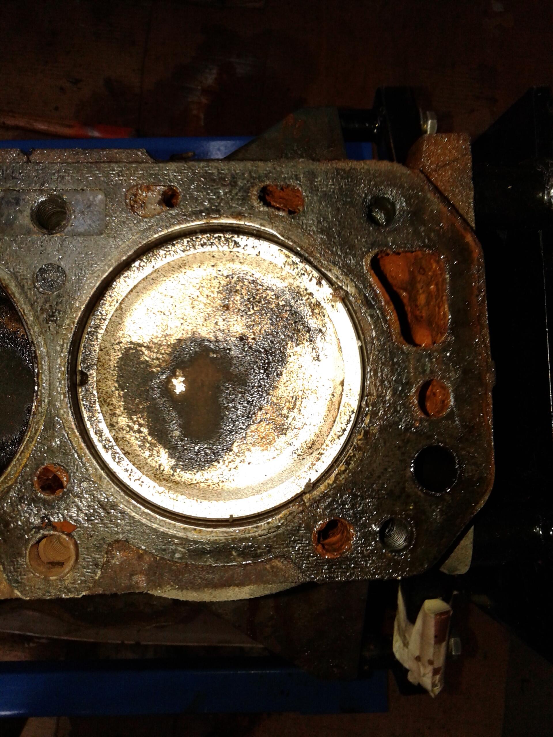

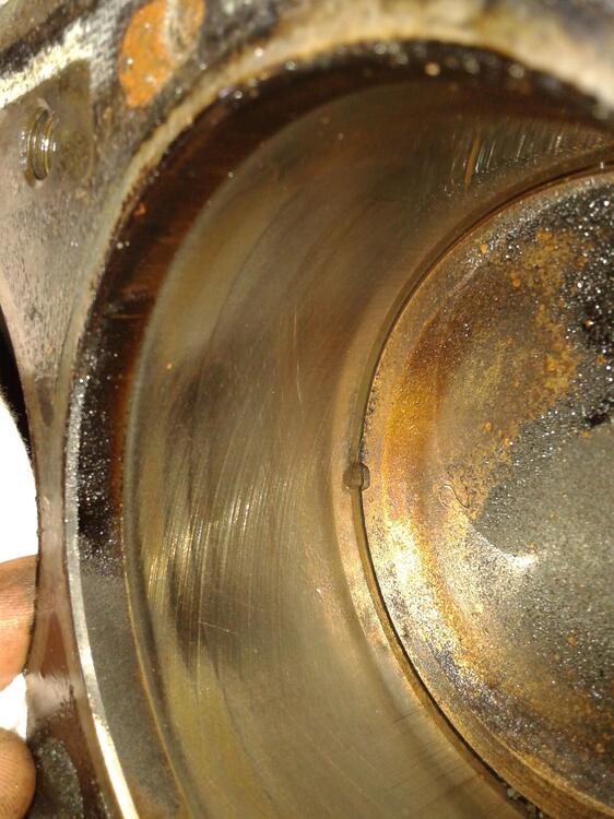

Cylinders looked very good you can see the honing marks very good so no need to take the pistons out!

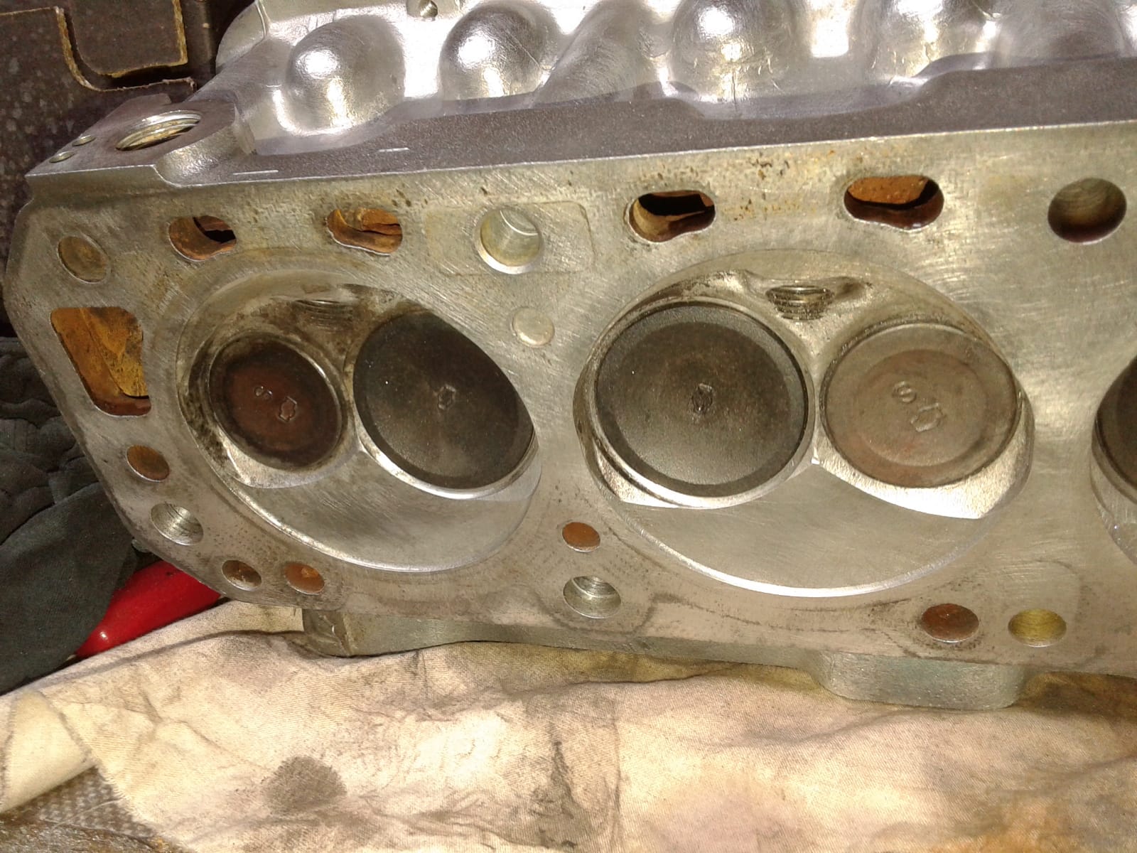

Here i found the small leak into cylinder 6! If you look good at 3-4 o'clock  on the seal around this cyl. then you can see that the seal was not very well installed on this head! it has a twist in the seal. next pic at 2-3 o'clock it is very clear to see that the seal was not installed very well!
Very happy that it's just the seal that was faulty!
Here a cleaned up version of the head .. it's a N42 head by the way.
I took the head to a firm that revise engines and they cleaned it for me.. as the head is as straight as an arrow it does not need any work. I already cleaned the valves and renewed the stem-seals of them..  Also did a valve fitment check and ground the valves (for as far as necessary) with the special abrasives..

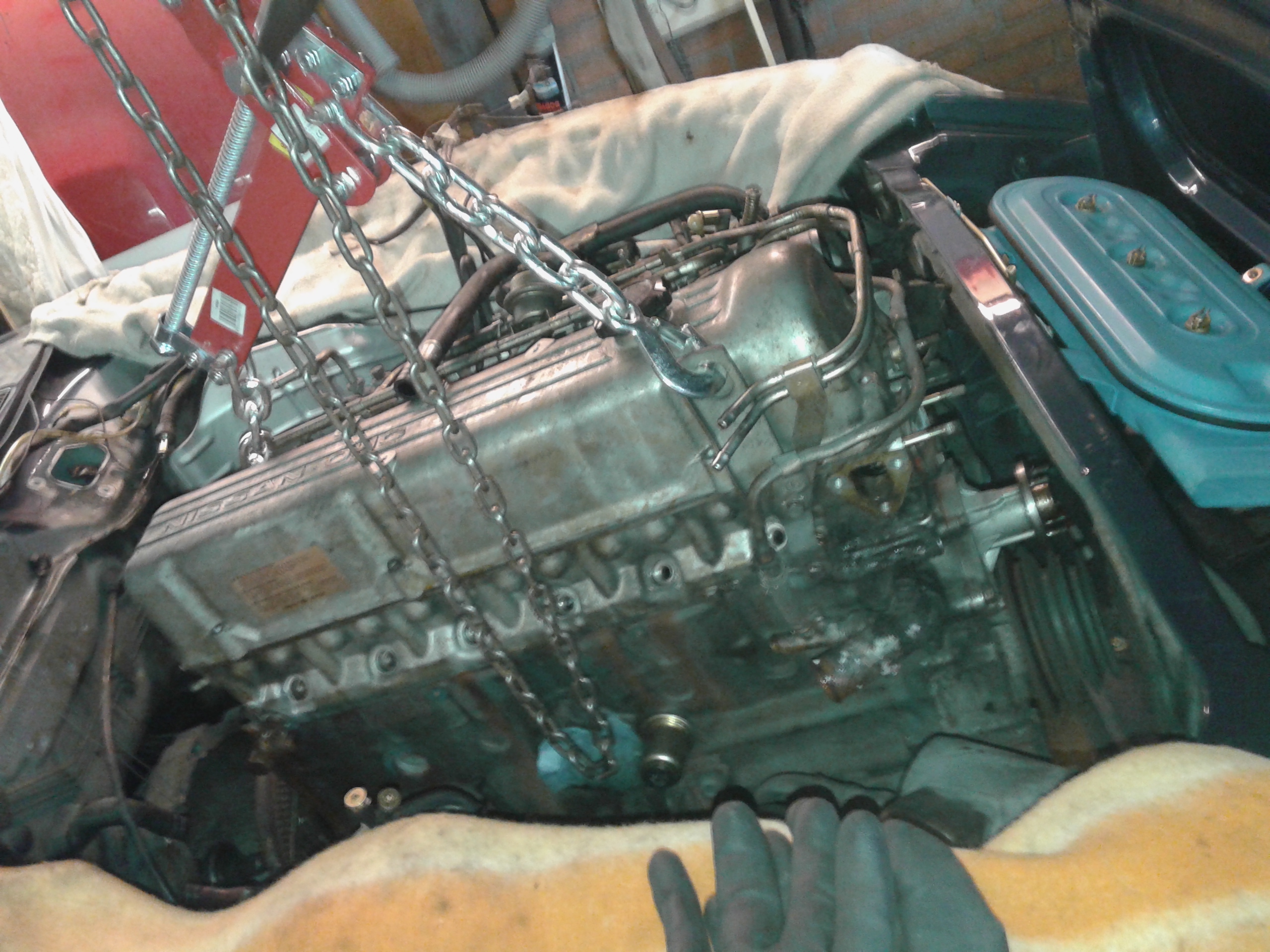

Taking the engine out pic..

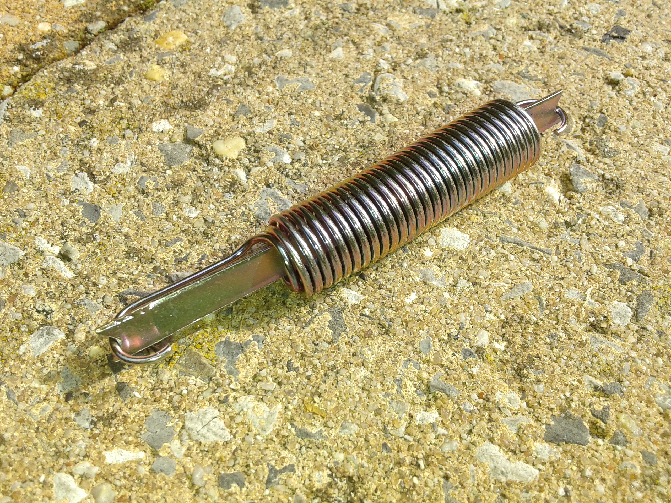

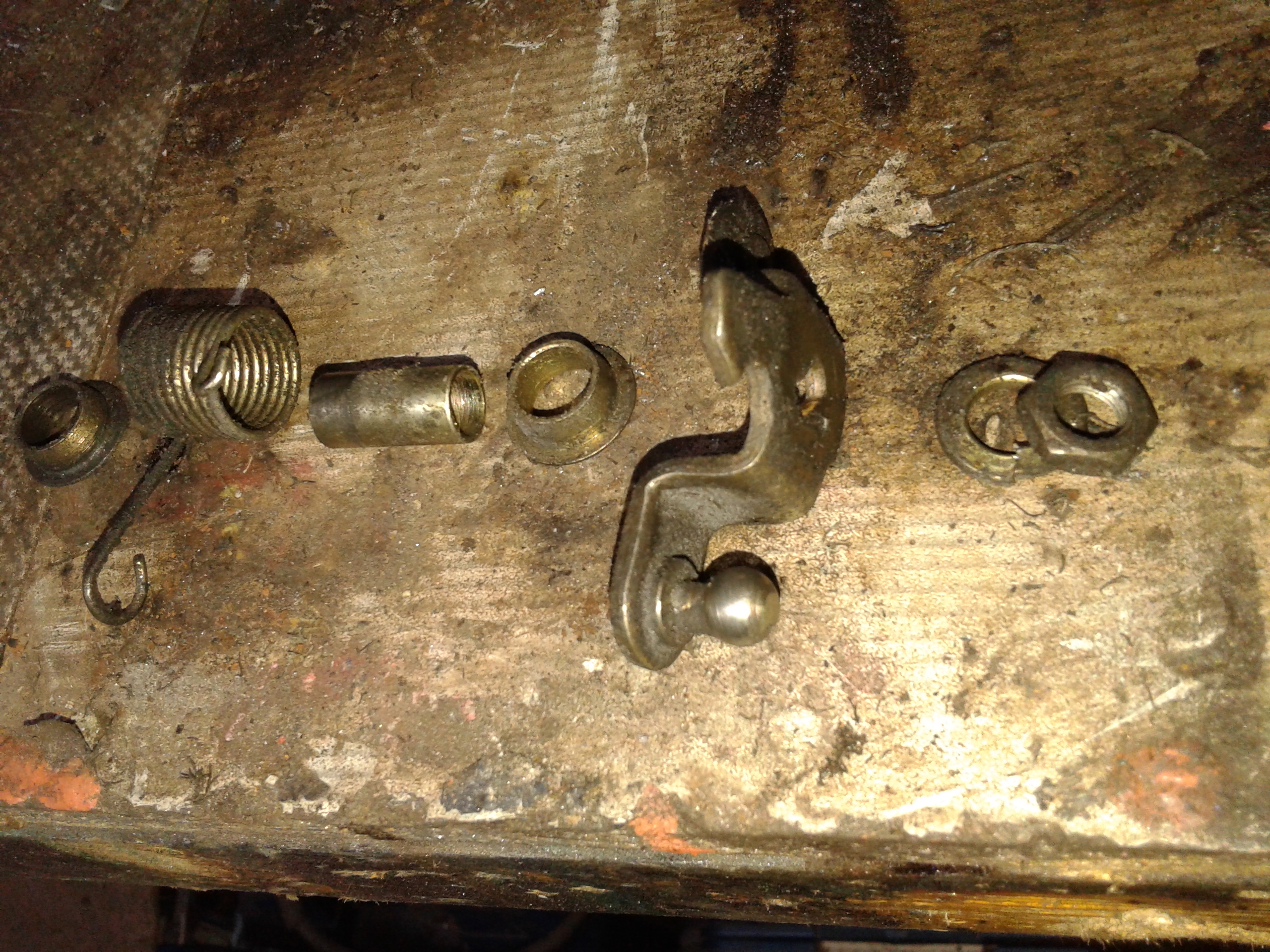

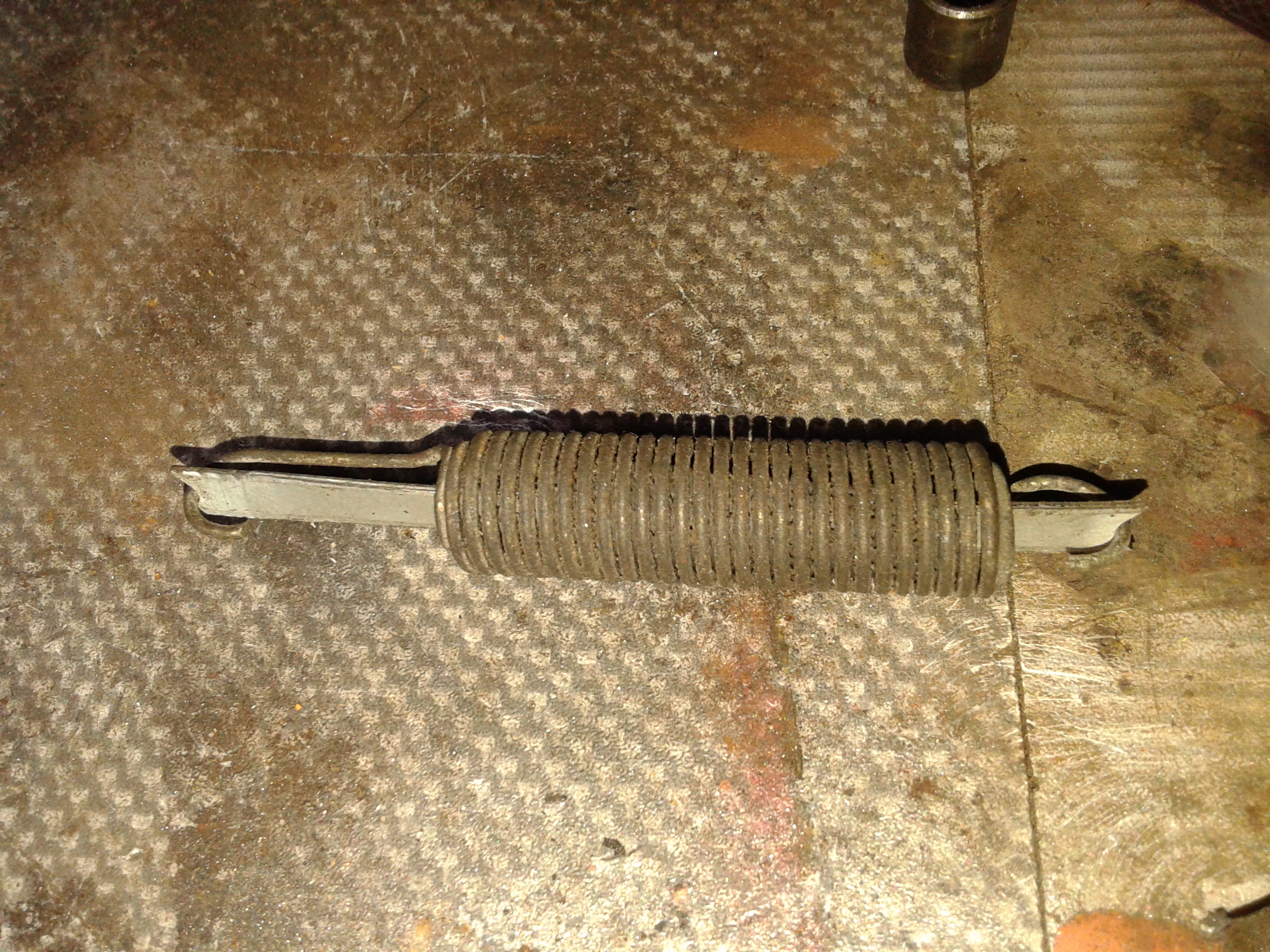

Here a top-tip for when you restore springs..
The spring is on a little peace of sheetmetal  so the cleaning can be done between the "rings" It comes back as a new one!
I need to take these bolt-ends out.. if you have a tip other then drill them out i like to hear from you!  (I try to get them out with some oil and if not then i cut them flat of and drill them out and tap new thread in it..)  AH.. i will try to do it with heat.. but tell me, what do you do.. wait till its colder again or try to turn them when still reasonable hot?  Has somebody used coldspray? i try that also on the bolt (not the manifold) .. (Just bought some penatraiting oil that also cools it.. the bolt will freeze!)

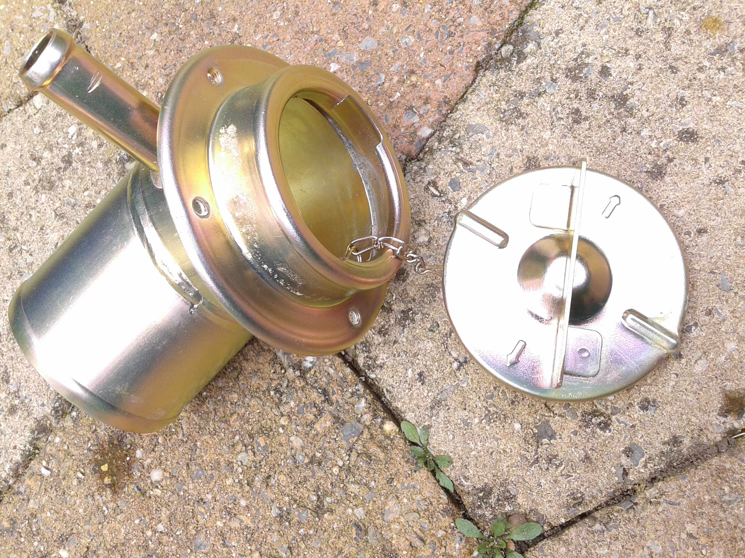

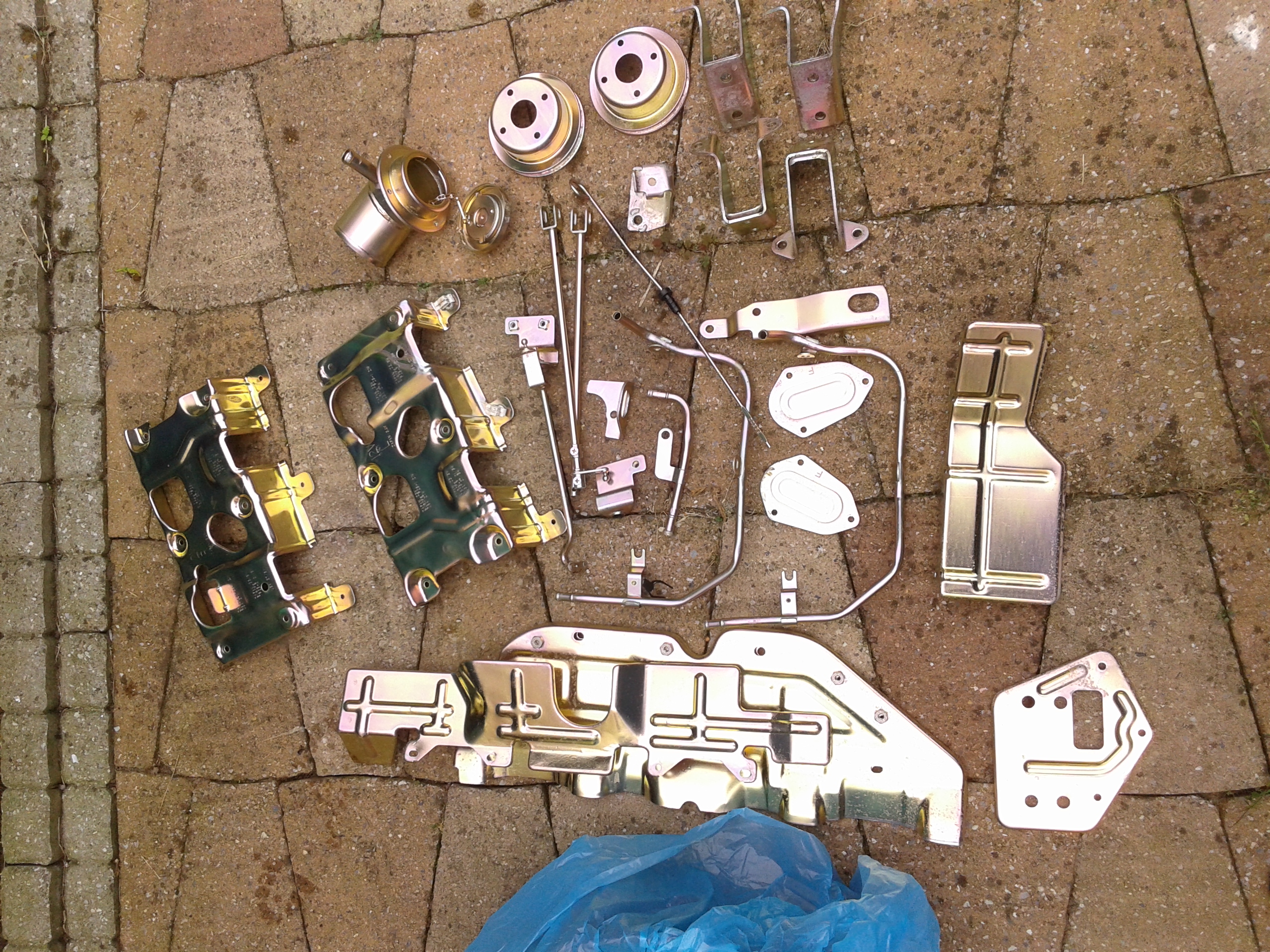

This week i got my parts back from the galvano company..
Nice to see that old parts so dirty come back like new..
Here the passified nuts of the exhaust manifold..  have to drill them out and make new threads in them..

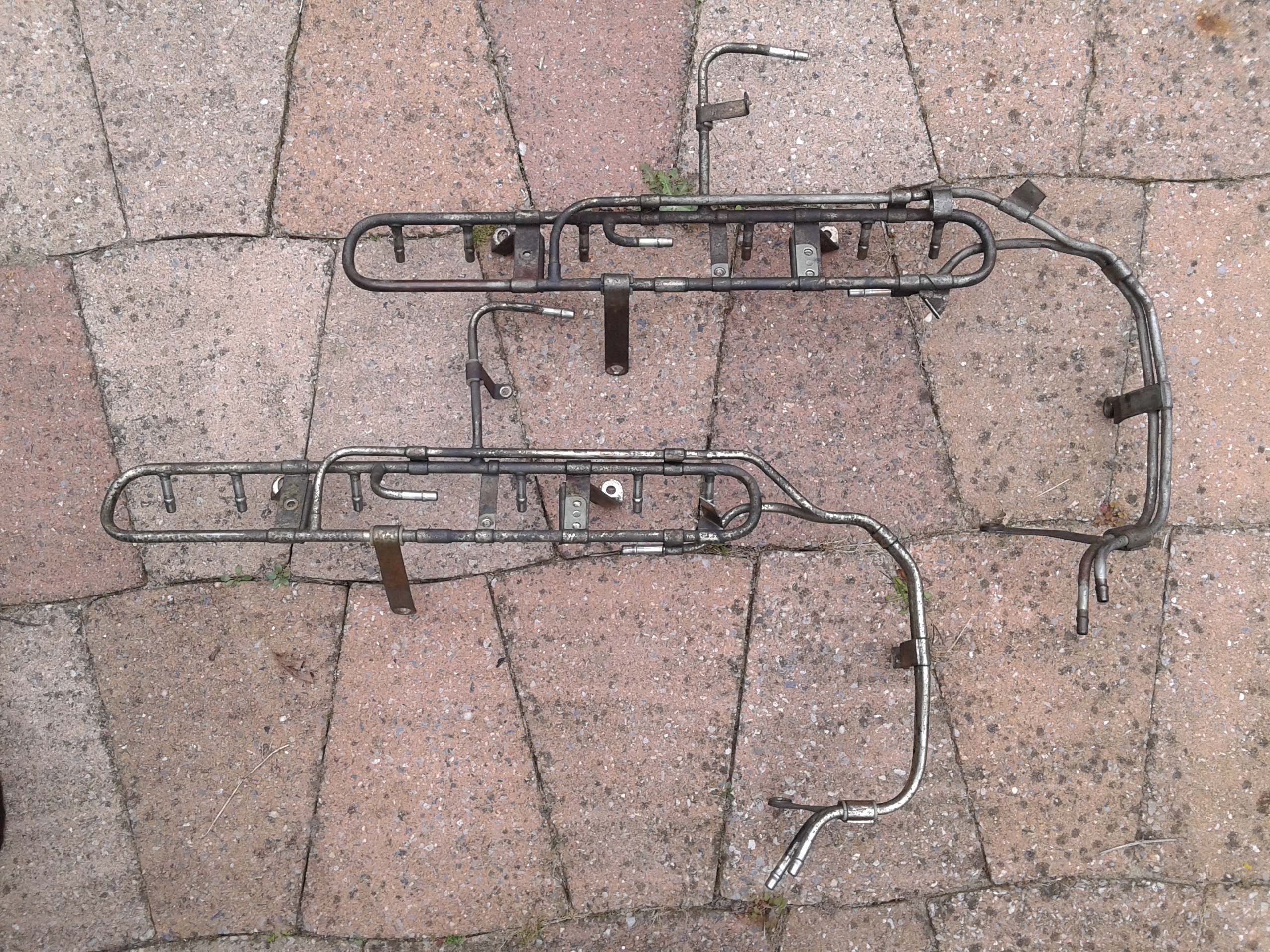

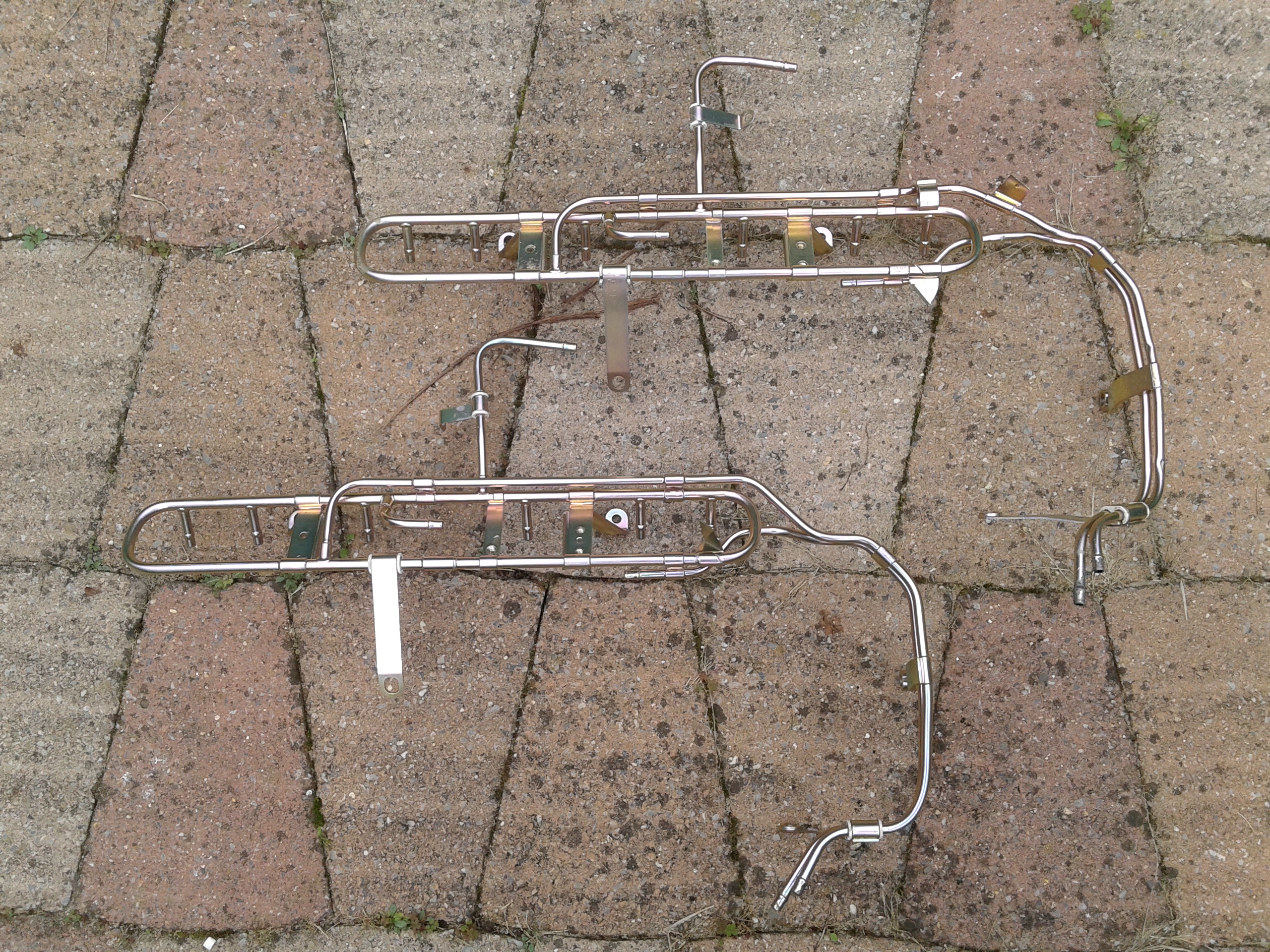

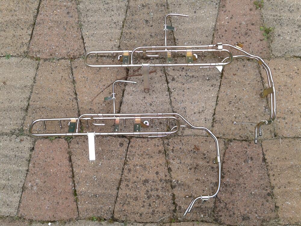

Old and new from the fuel rails (lower is '79 and upper is 82-83 rail.. Look and find the differences!)
came back like new..
Lots of parts for zx.. (not only for my own..)

Look at the old spring few pics back and this is the same one..

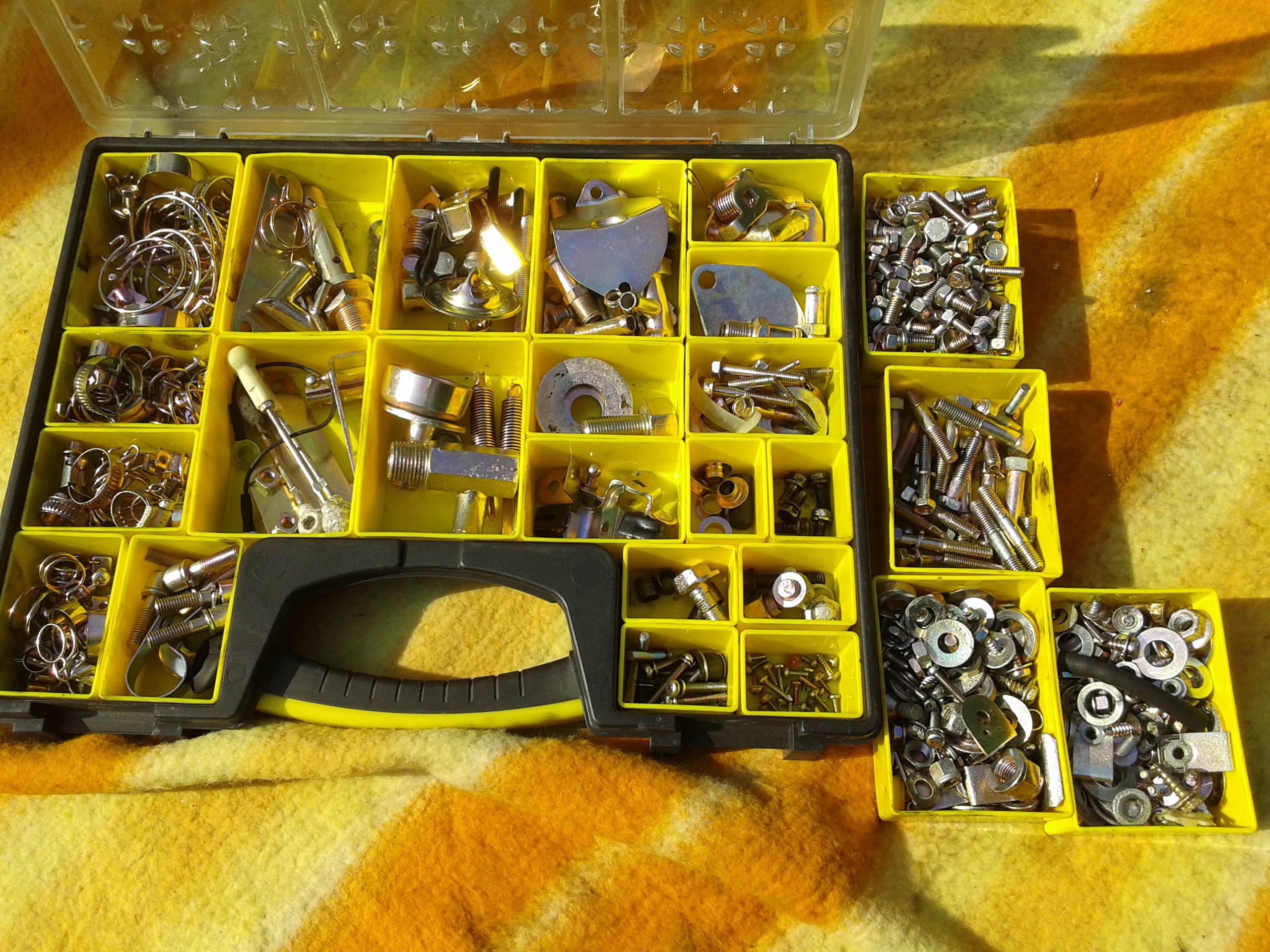

sorted parts ...

3 minutes ago, bartsscooterservice said:
Looks like the exhaust stud is still in the nut ...
They are!  After 42 years they broke off..  Luckely only 1 other broke off at the 6th cylinder exhaust manifold, right at the end of the engine head.. i already took care of that one, head is ready for install.. only the block i have to clean and paint.. and the engineroom also..  Will take a few weeks..or month's.. depends on how well i feel.

Looking at the pictures on my phone I can’t tell if everything was Yellow/Gold Zinc Cad platted or if some were also left clear zinc.

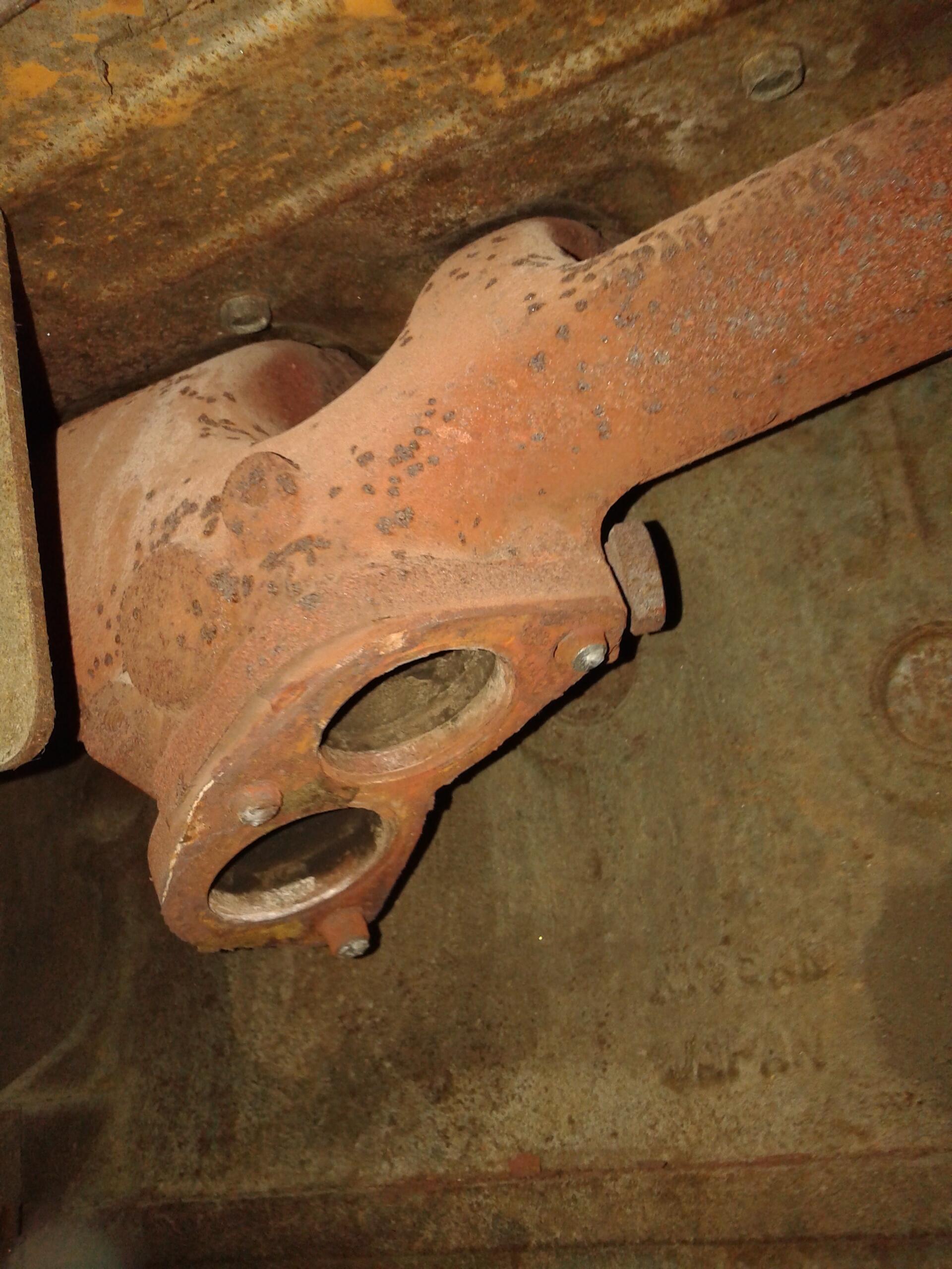

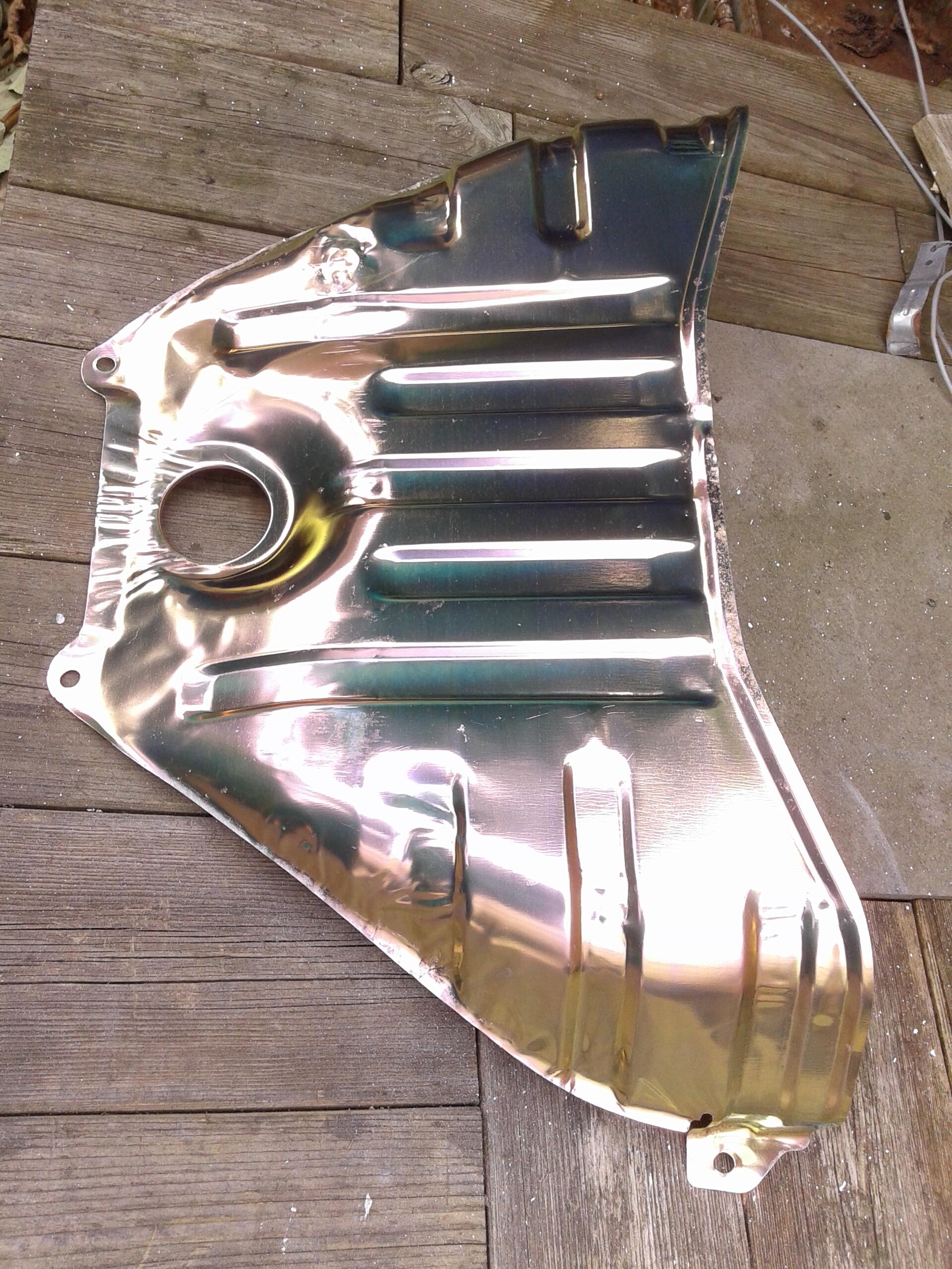

Did the heat and under shields come zinc plated from factory? I was thinking the manifold shield and the booster shield were galvanized but was not positive. Same for the under shield but I have not really looked at it yet or done any prep work to it.
And I was wondering if you knew what finish was on the radiator over flow bottle bracket? Every one that I have seen out of the car is pretty rusty like mine and you can’t see it when looking at engine bay pics of cars.

Yes i think so but just zinc not that golden look.. I don't make 2 piles of stuff to zinc.. i always do the cadmium/zinc? i believe it's called?
Original the car has zinc (grey-ish) and cadmium? (gold-ish) colors on the metal parts, Galvano the company that does this for me can do both but then it's twice as expensive.. i decided that it IS a car for daily drive and NOT a trailerqueen...  so the parts need to be protected against rust but they don't need to be as they were factory.. as there are few zinc grey parts under the hood there is not much difference.. (It's totally possible that i spray the coolingplate under the intake with grey heatresistent paint.. and the under engine front plate black.)
The under shield had a LOT of undercoating on it when i brought it to the firm for passifiing.. it had a little rust and where the undercoating was off it was zinc grey as far i remember..
