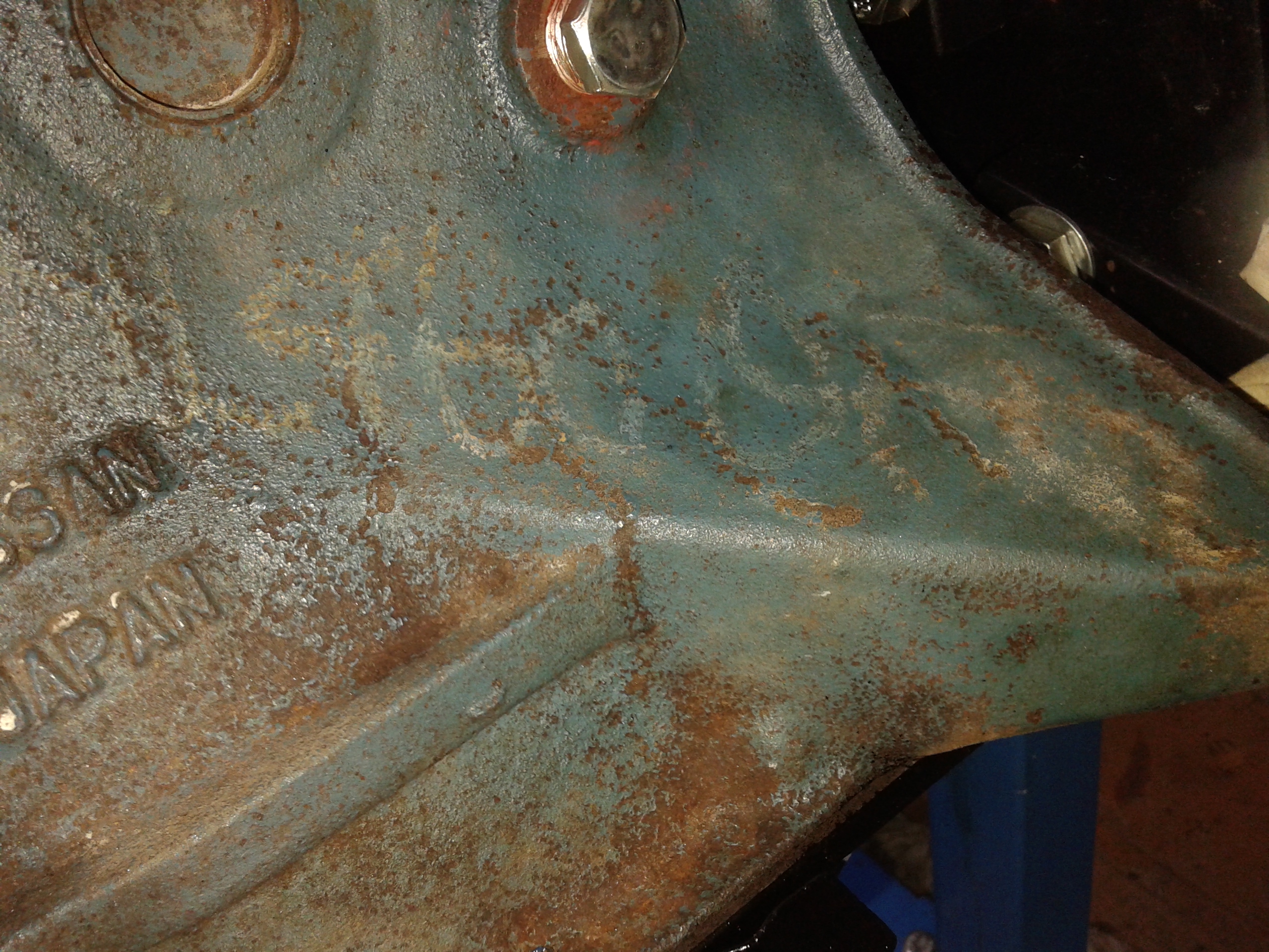

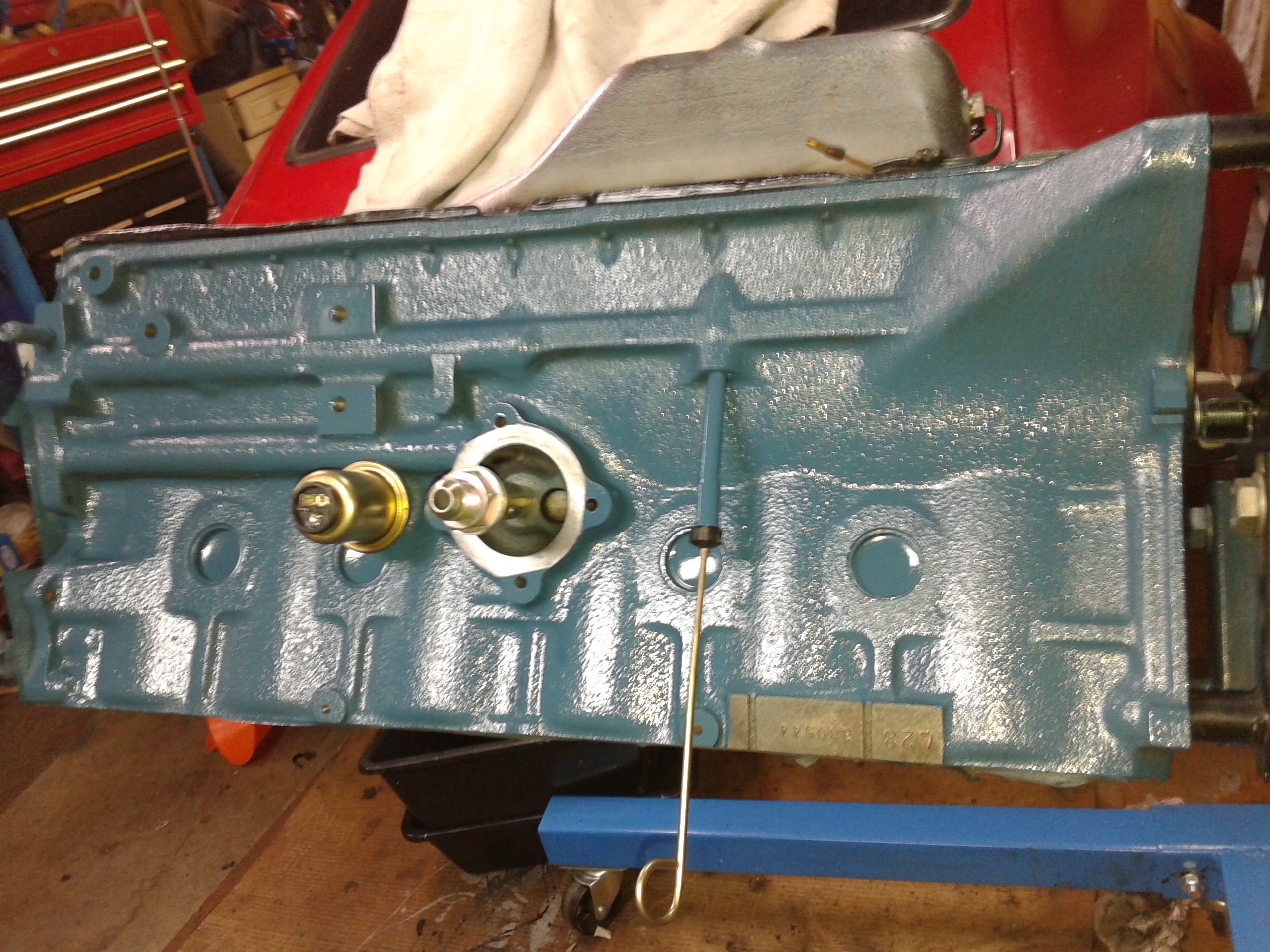

After a good clean (before sanding) i discovered a big number on the block.. i have no idea what it's doeing there..

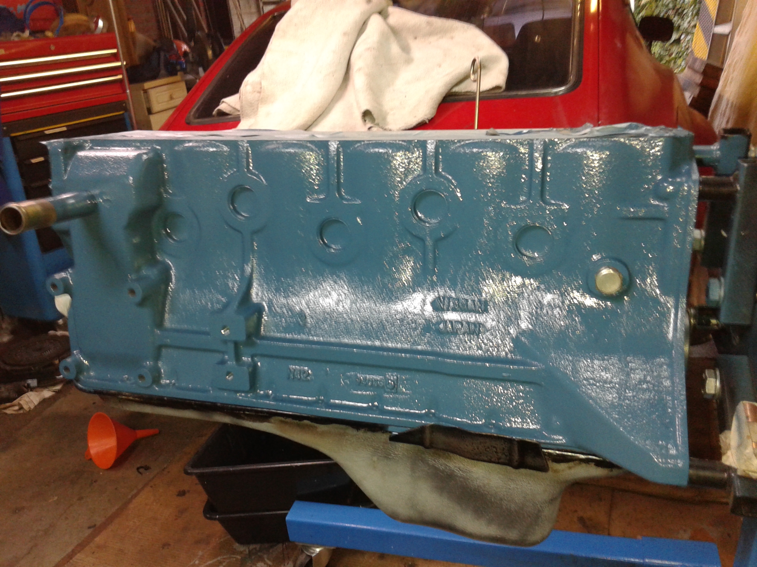

Painted block L28 N42

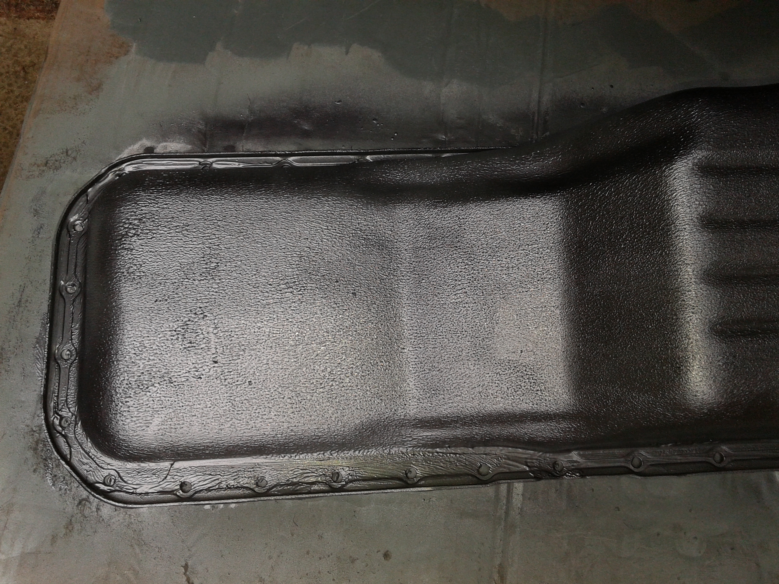

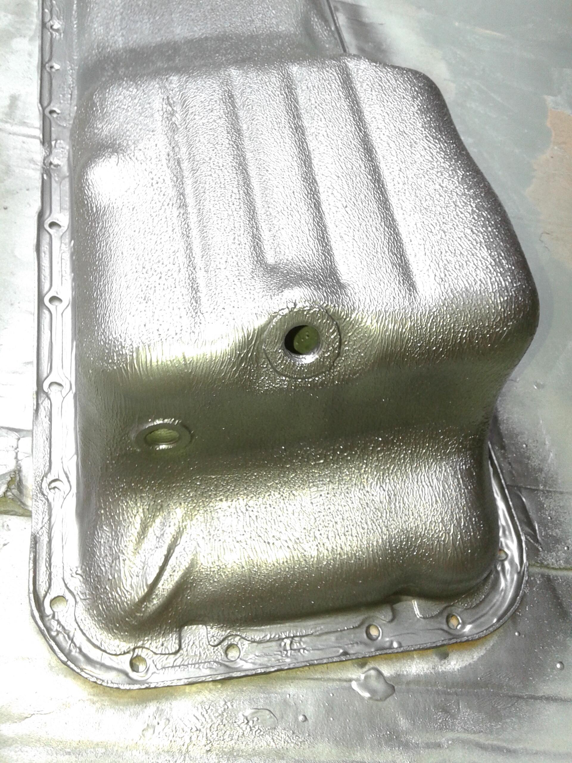

Zinc painted sump .. (it was a combi of first a layer of zinc and then some charcoal paint, it was a bit much so i rolled the paint what gave me this effect..)
The sump was in very good condition, all bolt holes where OK. As cork seals are not very good i used liquid sealer on the sump..

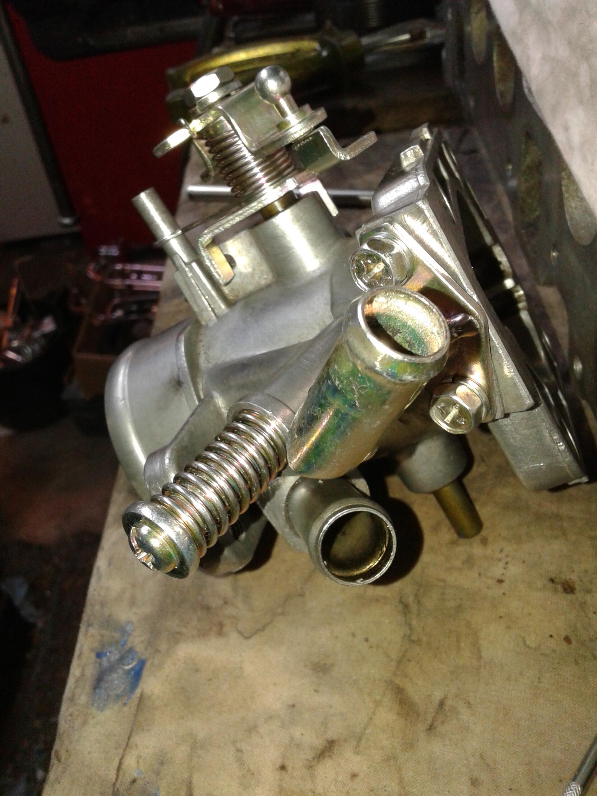

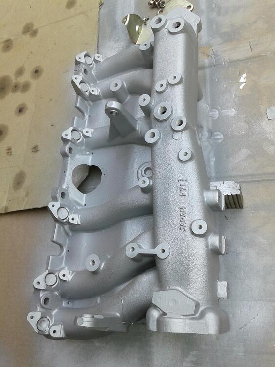

Intake manifold also ready for install.

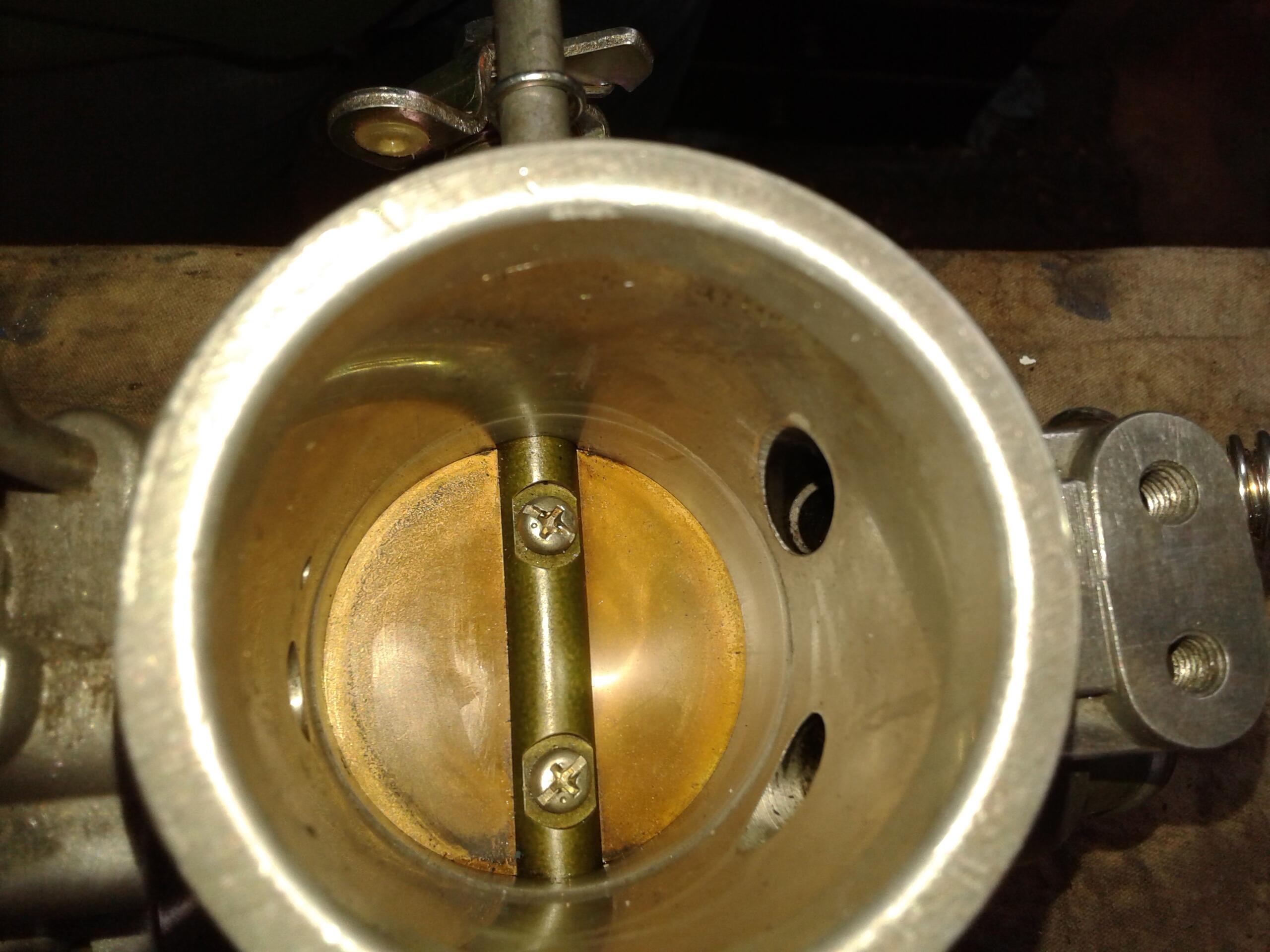

Throttle valve ready for install..

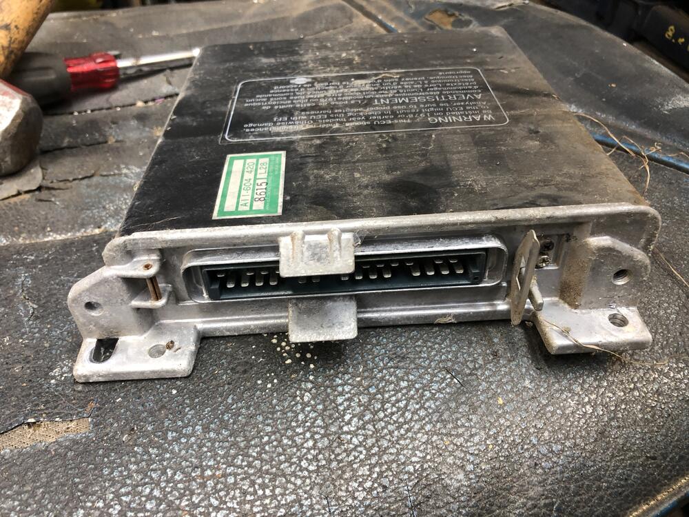

I just finished parting out what was left of a extremely rusty 79 slick top 2+2. I have the AFM and ECU if you want them for spares. Very very cheap.
