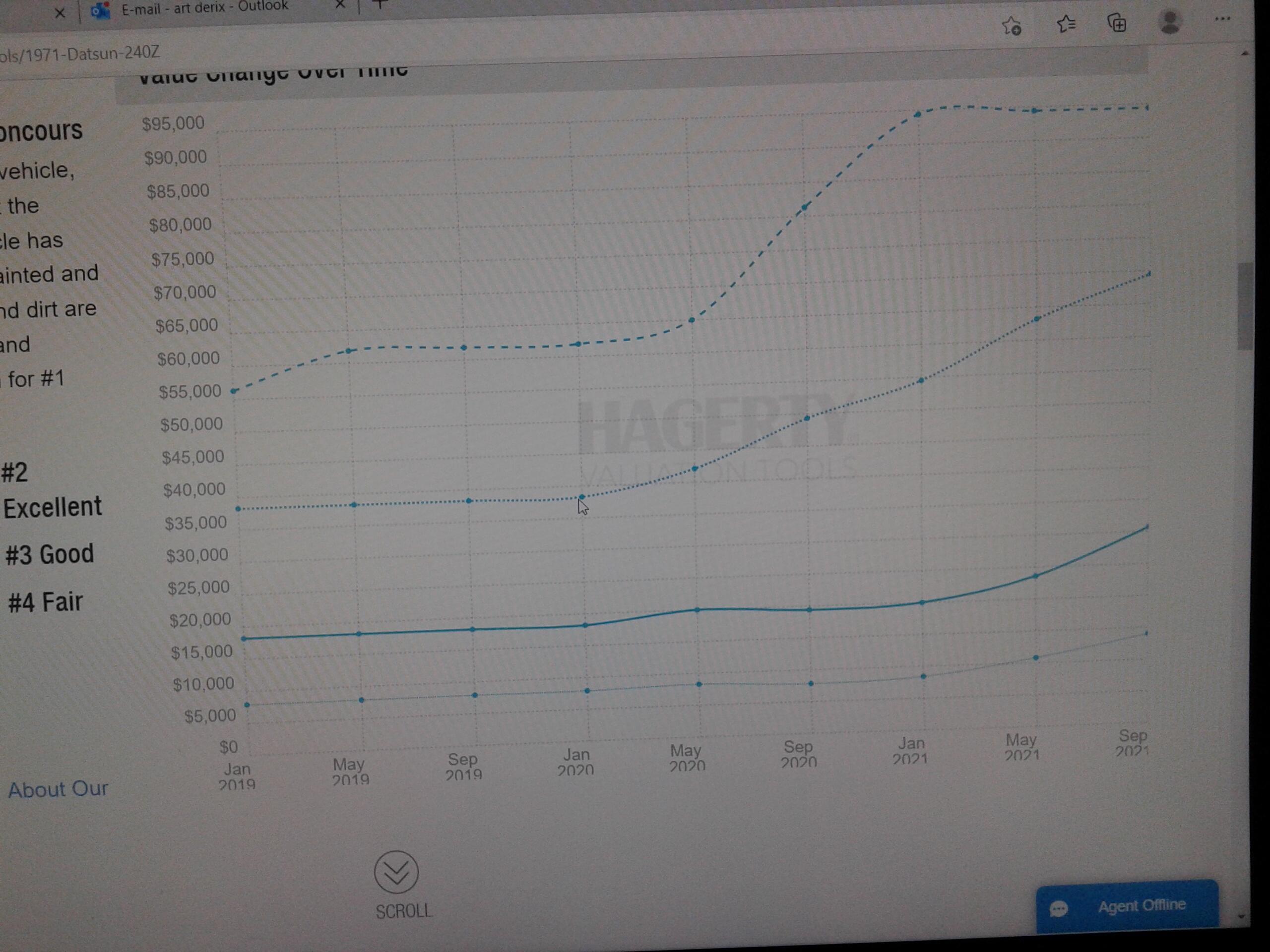

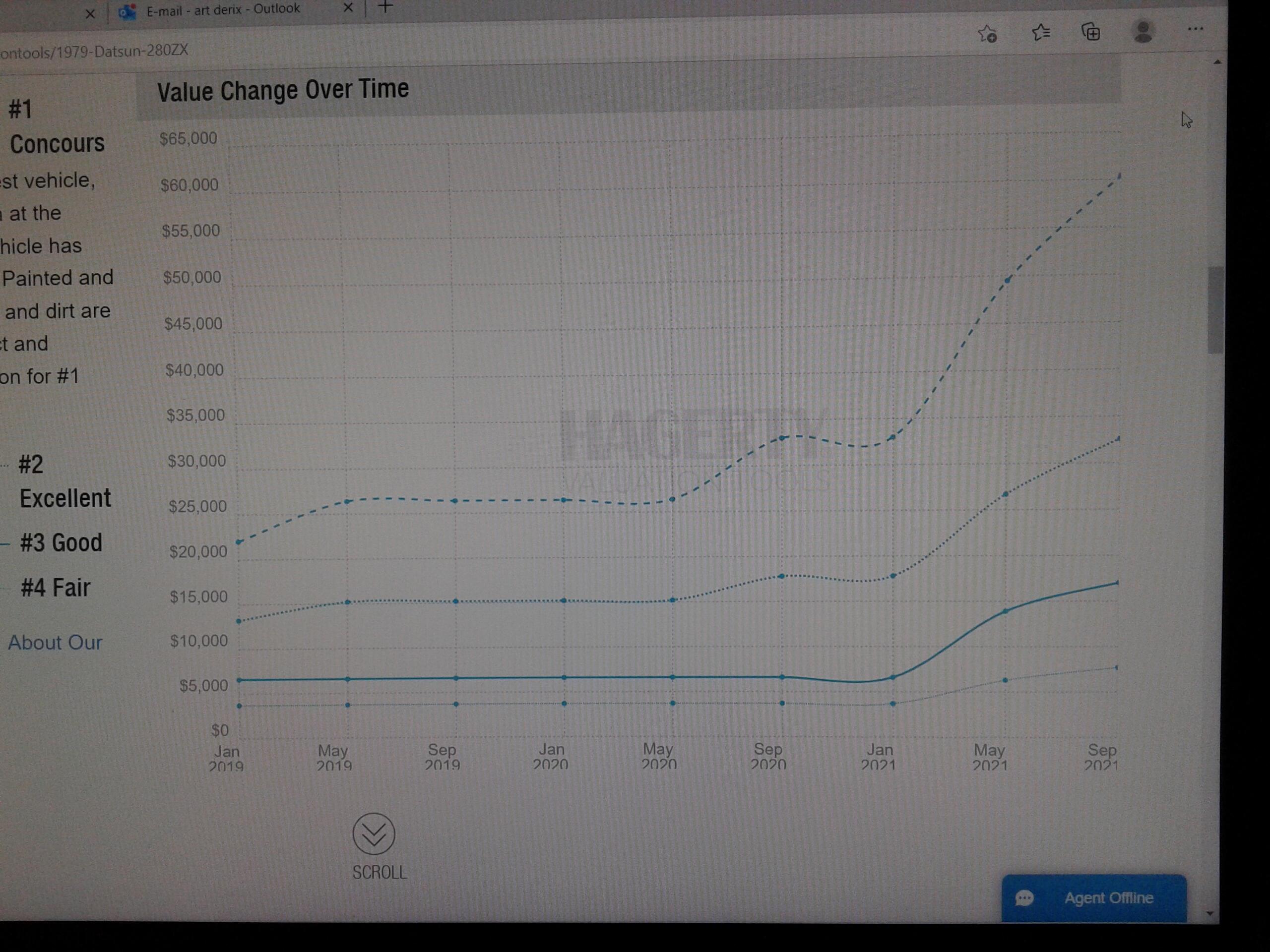

So i looked up my 240z and 280zx op Hagerty's and it seems that the 280zx is following the 240z's lines.. (I restored my 280zx just in time it seems!! :beer:  )
Datsun 240z 1971...
Datsun 280zx..  Double the price in one year!!

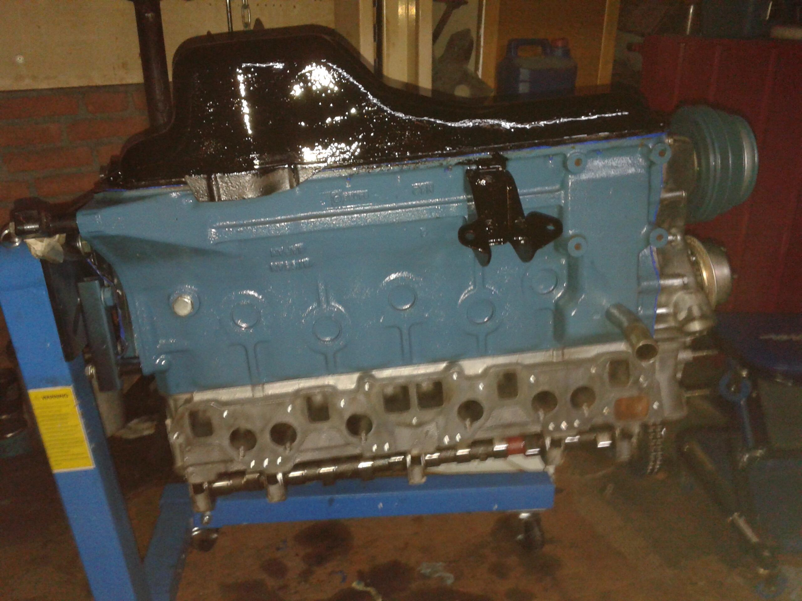

I finally assembled the engine in October.. was to sick to do anything in November..

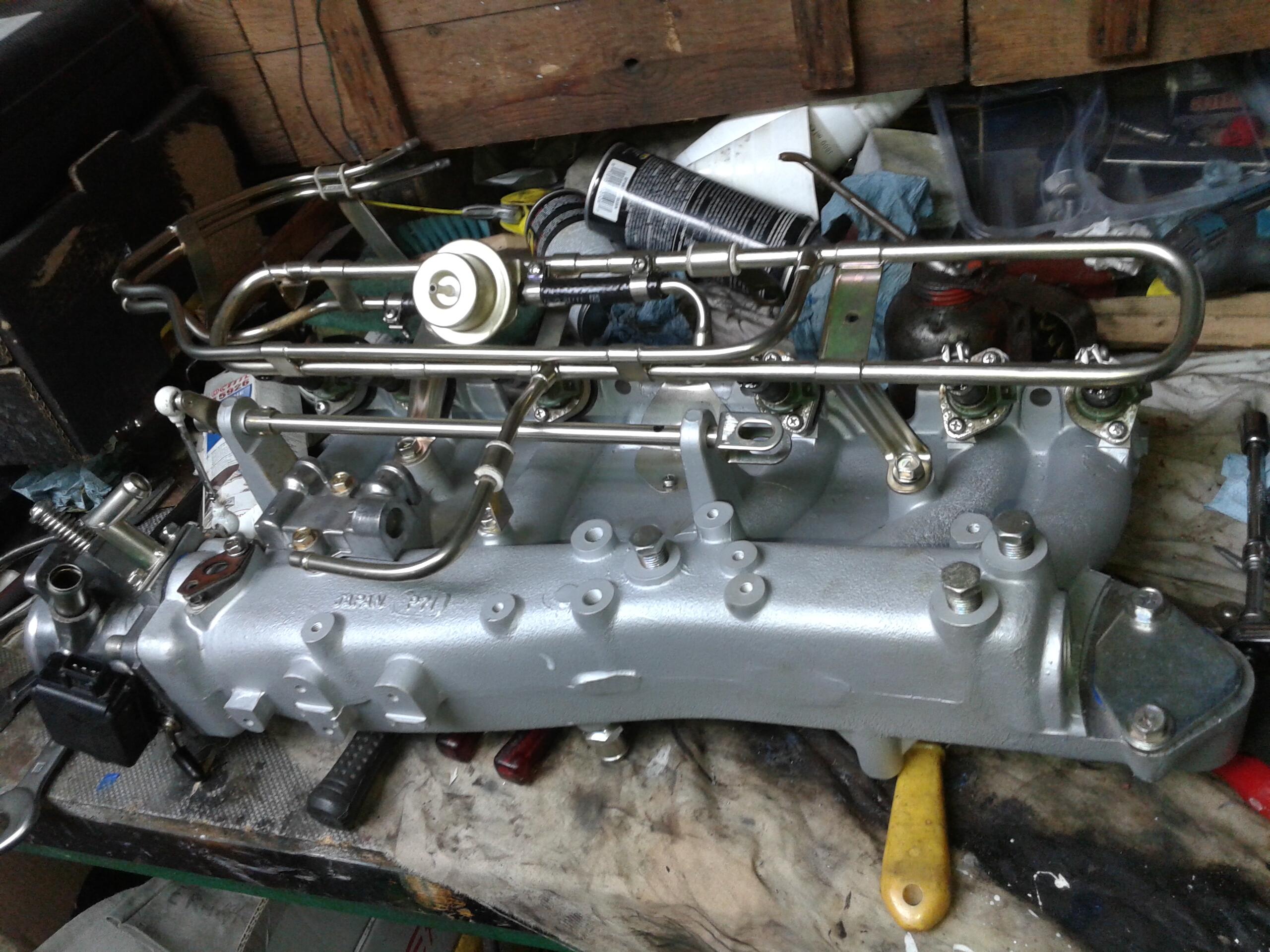

Here some pics of the result.
Still hanging upside down..

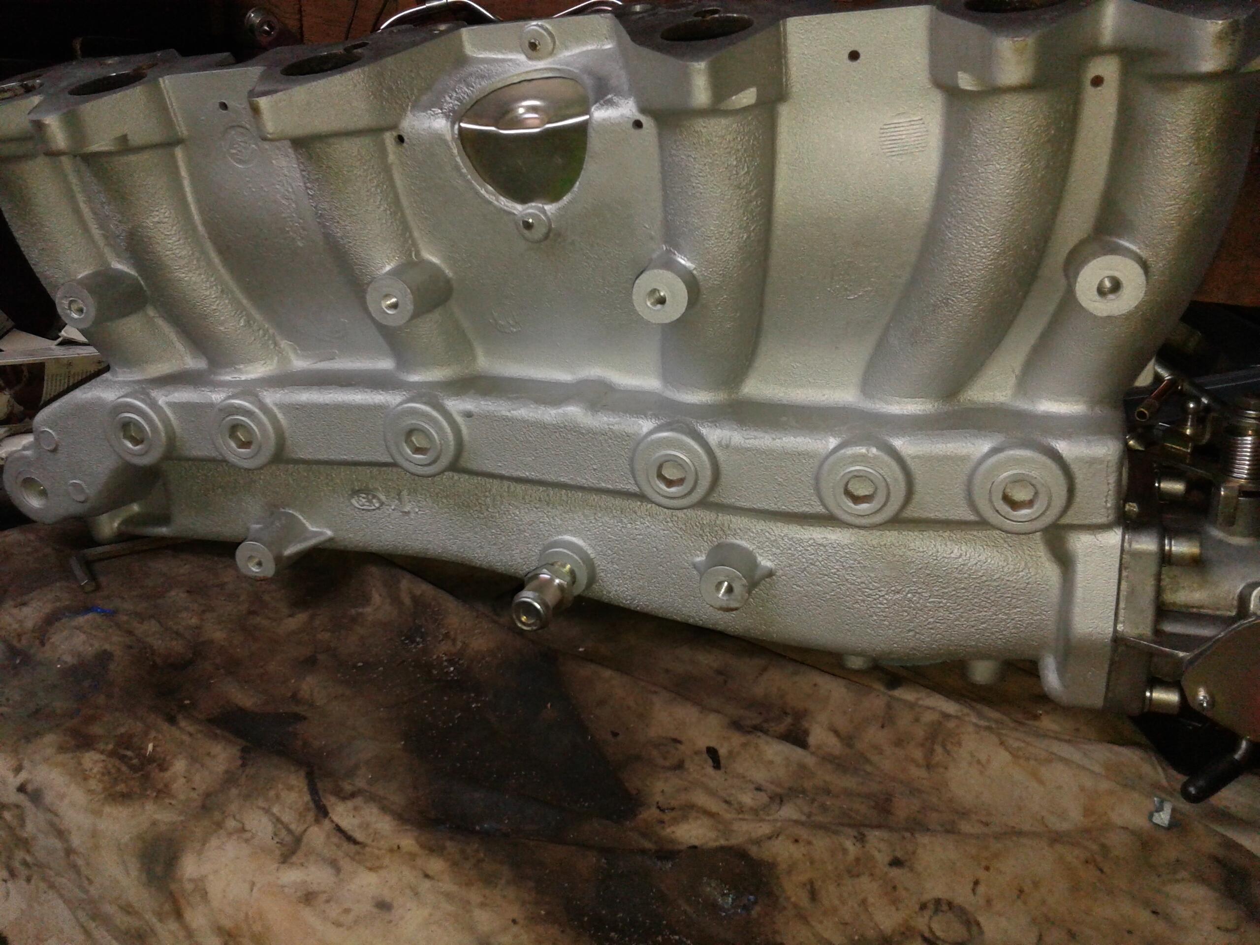

Inlet plus injection..
underside

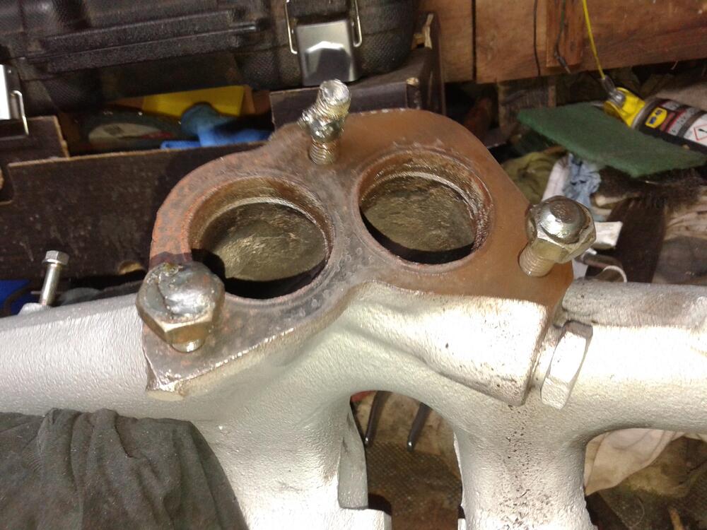

Taking out the old broken bolts with a good heatup by welding it... it was a easy job!

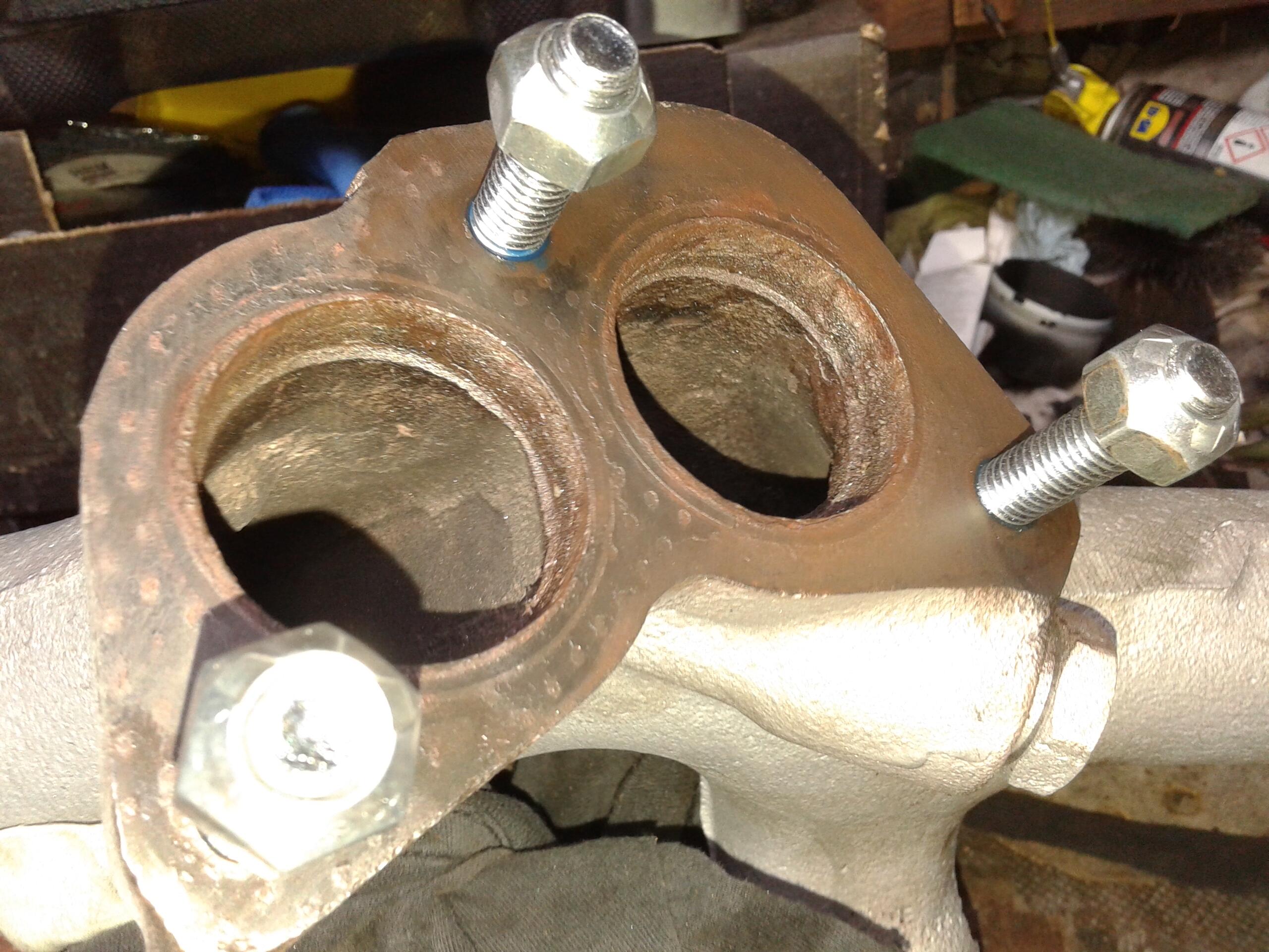

New bolts installed with some red (very tight) lock-tite. And some new self locking nuts.

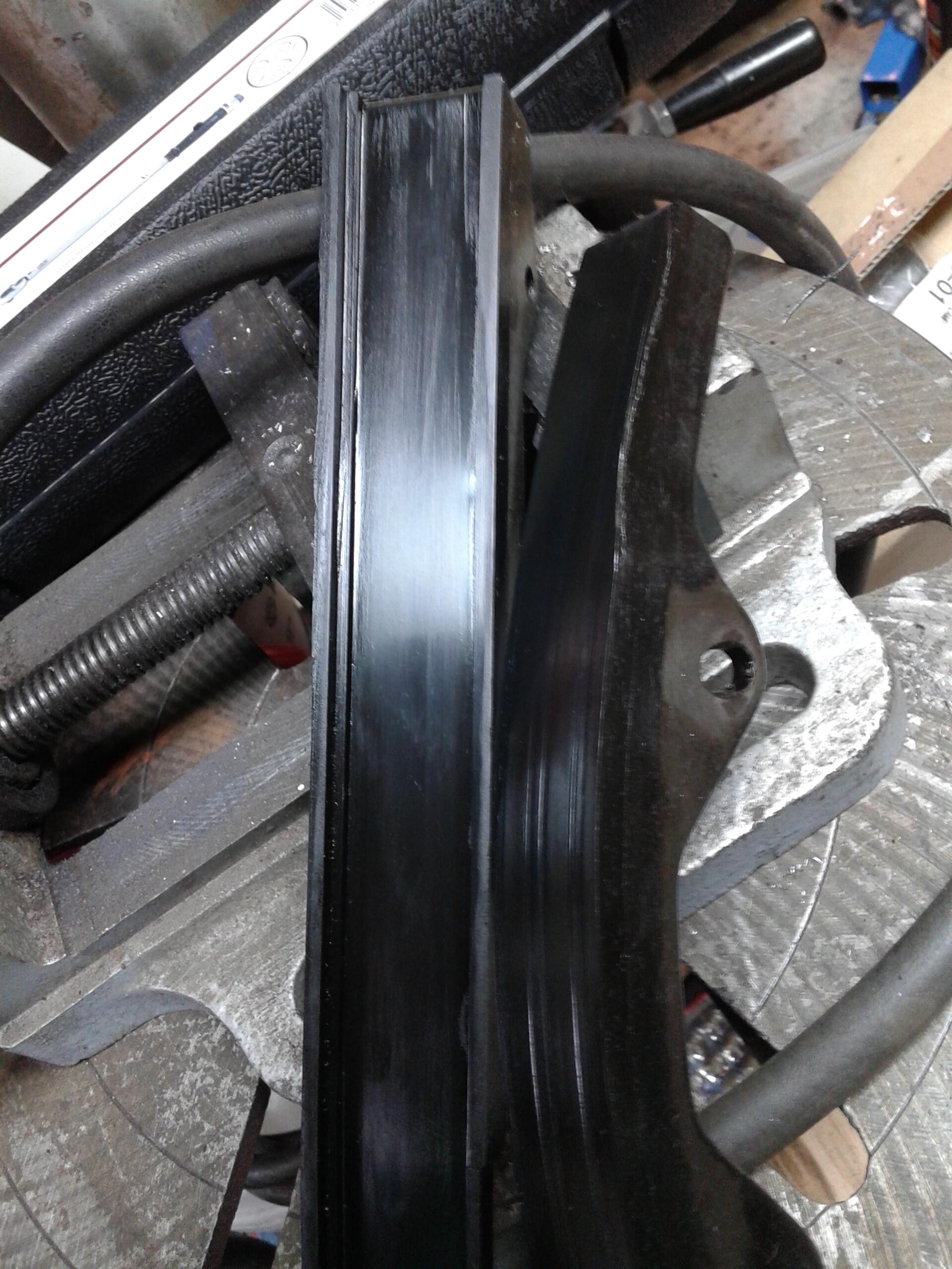

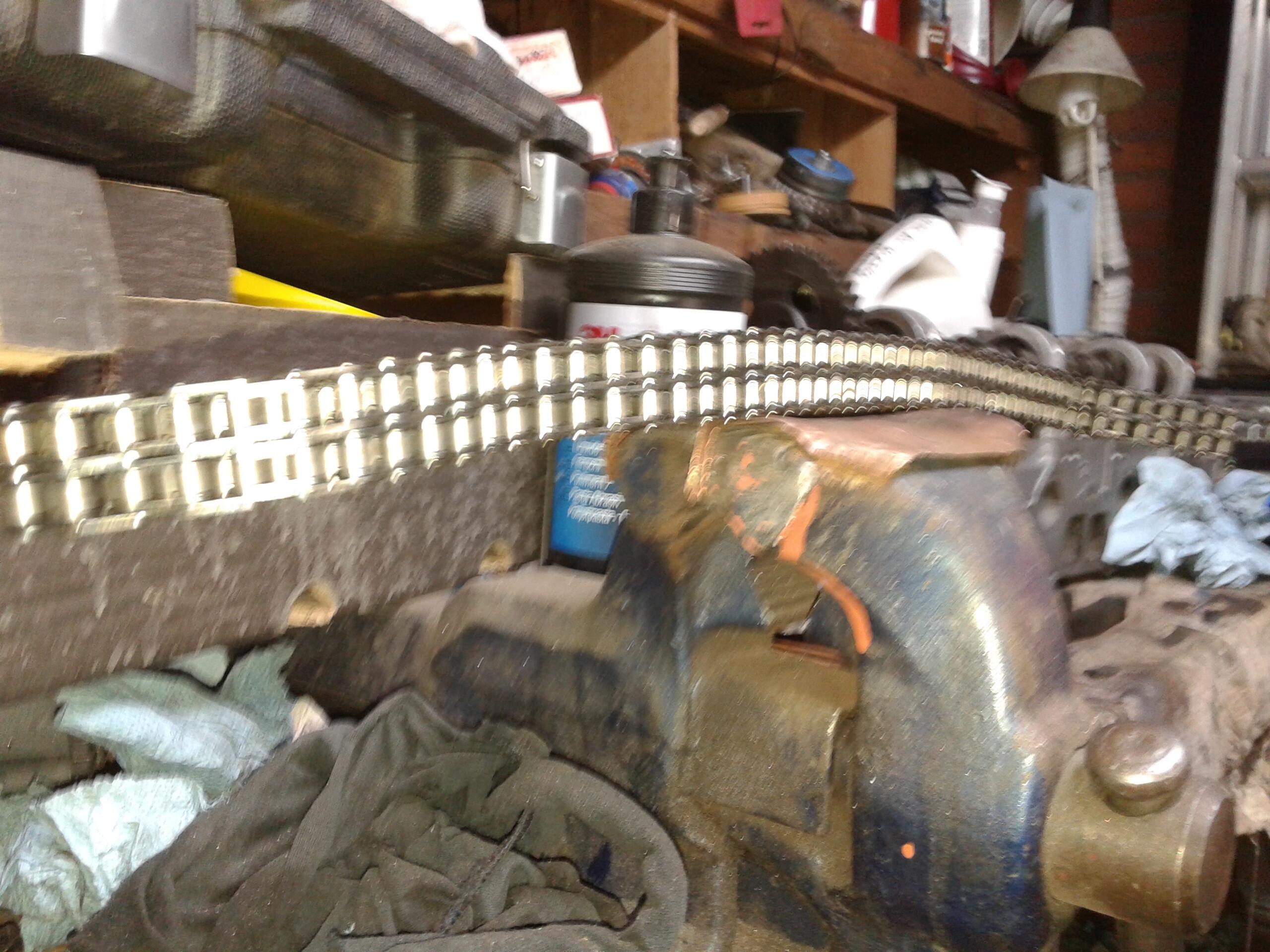

With some patience i managed to lay the chain on my vise and make a pic of it.. it's almost like a new chain after these km's.. i could put it back in and the  sprocket of the timing is still on the number 1 hole!
Almost no wear on the chain-guide.. And YES these ones have gone back in the engine.. the rubber was very good, it was tough but very deformable! (I find that unbelievable! After 42! years!!) (i keep the new set for next time....)

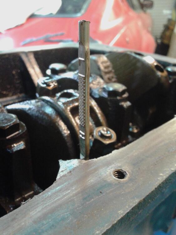

Haha.. the other end of the dipstick... you dipstick! 😉   (yeah a 240z on the background...)

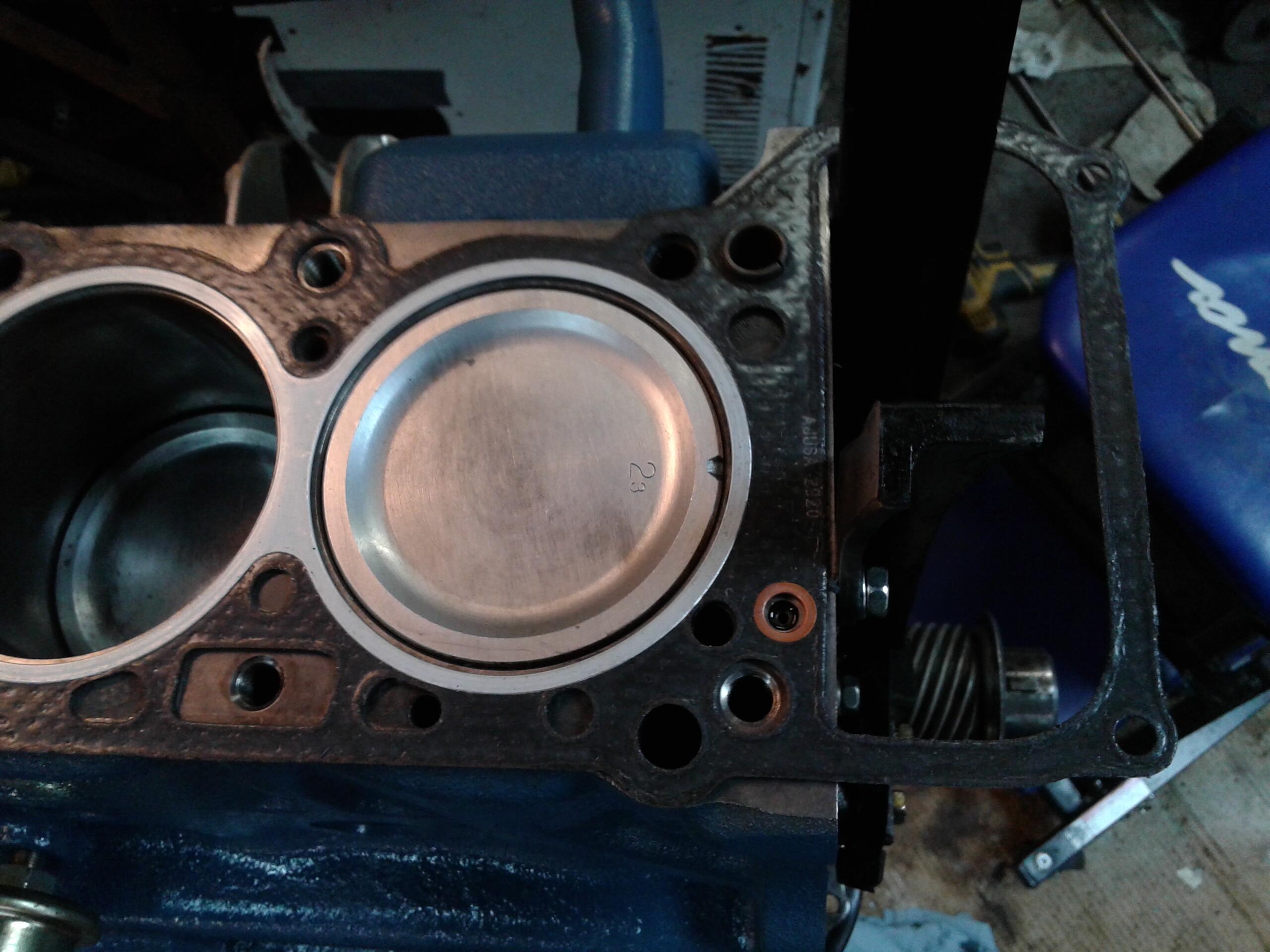

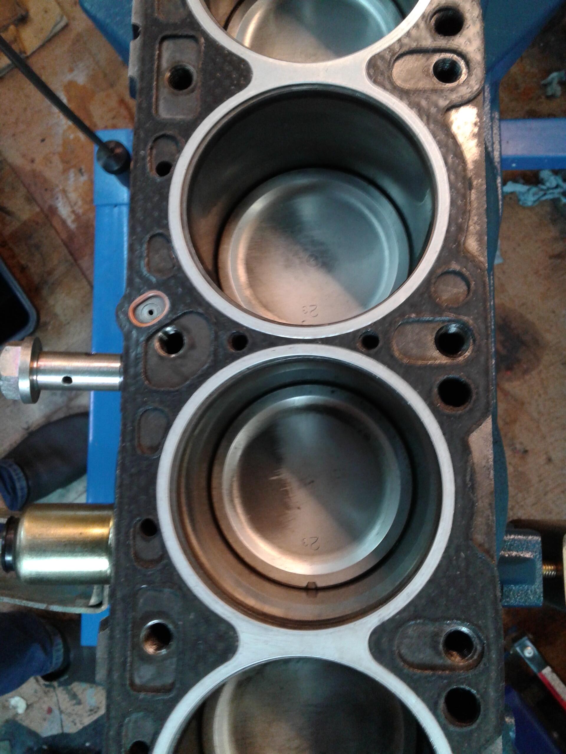

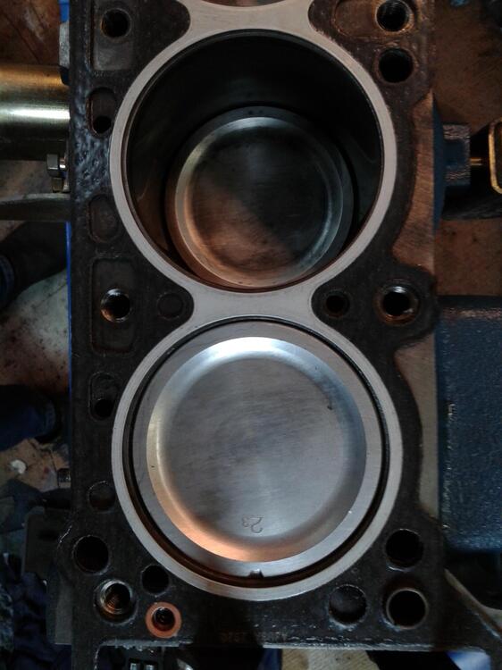

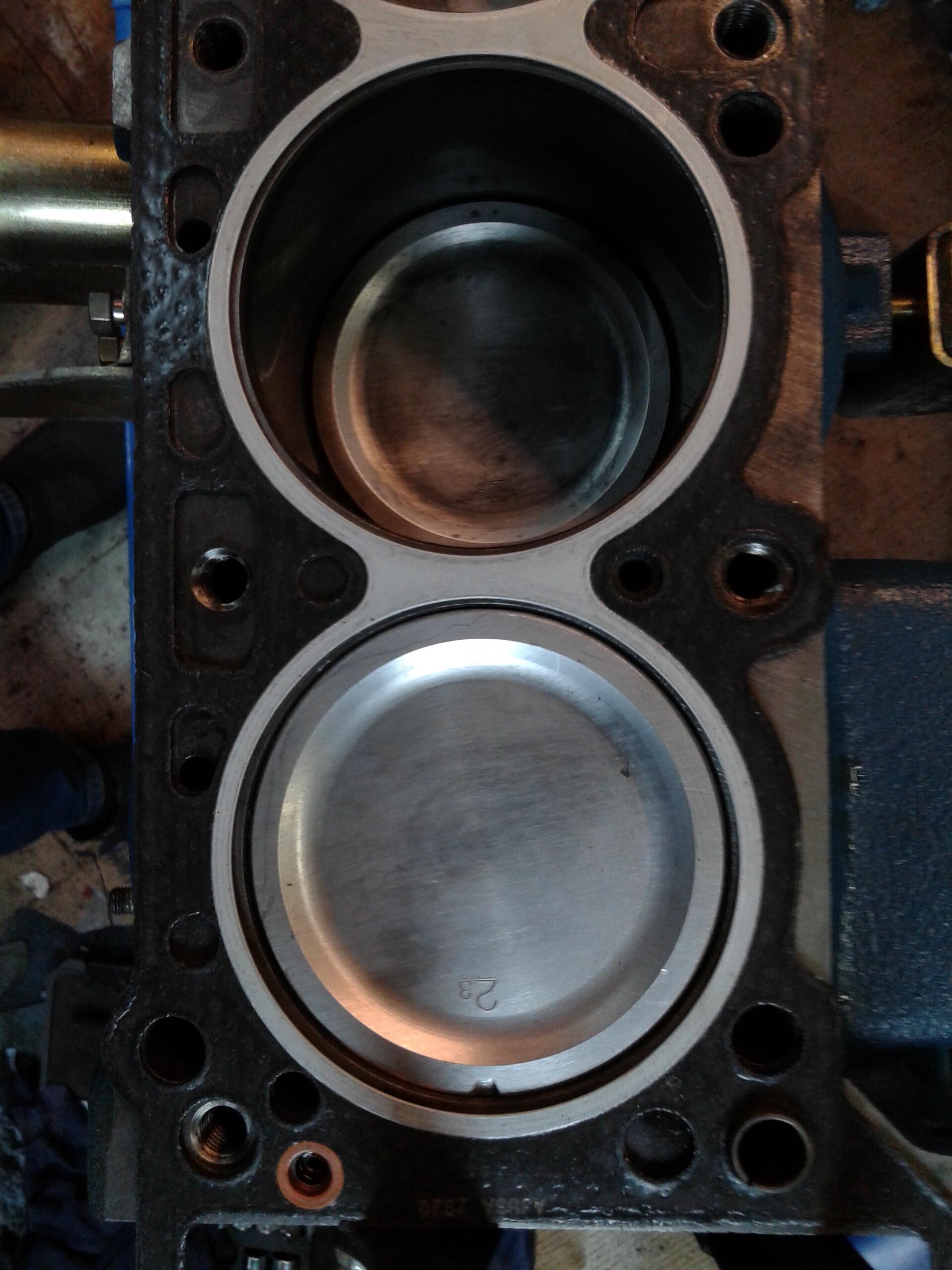

Some pics of the deck.. Nice cleaned out headbolt holes and a new headgasket on..

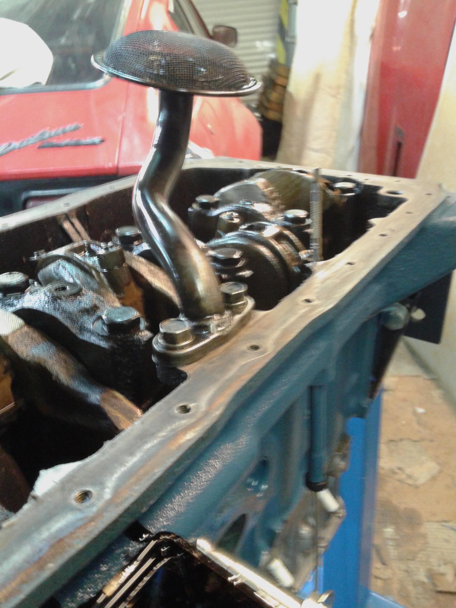

Oilstrainer.
