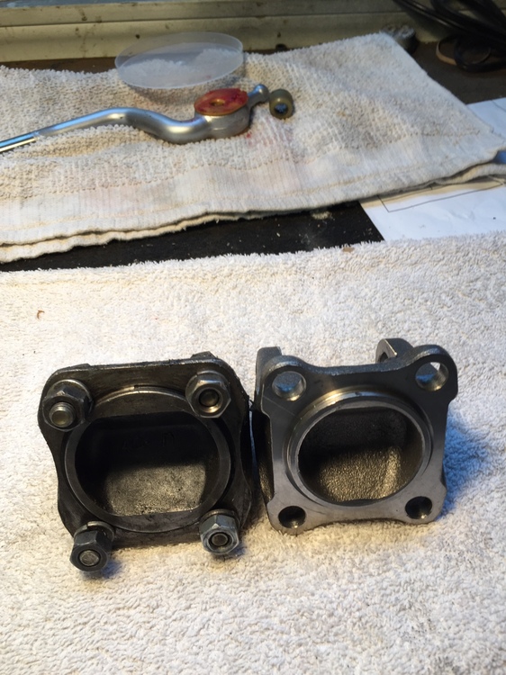

Posted May 20, 20177 yr comment_521403 Need to remove the rear driveline yoke and replace with a R200 conversion yoke. Is there a topic for removing/replacing U joints? Link to comment https://www.classiczcars.com/forums/topic/57771-help-u-joint-replacement-71-240z/ Share on other sites More sharing options...

May 21, 20177 yr Author comment_521438 I mean well. Â Frankly, it still seems like you're missing some things. If you have an R200 flange just use thr procedure in the 240Z FSM. Sorry.Okay you seems you are focused on what I don't know? So a little personal history. Been working on early Zs for over 25 years. Last time I worried about U joints was 2002 when I had my current drive line made. I had Spicer joints installed then. Currently I am adding a R200 with Mfactory LSD. The R200 is from a 300z. I purchased a conversion yoke from Zcardepot. So help me understand what I don't know???? Cause you don't know what you don't know.Now back to my original topic. I haven't personally performed the replacement of a Spicer joint in over 20 years. So if you know a link or have good suggestions on the actual process I would appreciate it. If you are going to be negative as you normally can be then STOP as you said earlier. I promise I can do it without you. others here offer great suggestions a positive support. ThanksDonDon's iPhone using Classic Zcar Club mobile Link to comment https://www.classiczcars.com/forums/topic/57771-help-u-joint-replacement-71-240z/#findComment-521438 Share on other sites More sharing options...

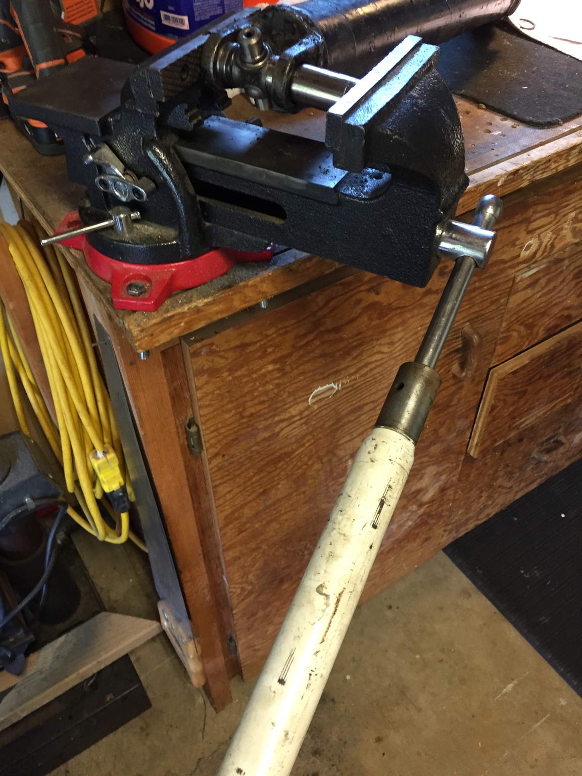

May 26, 20177 yr Author comment_521755 Decided I was man enough to DIY the rear joint and add the R200 yoke. Followed the recommendation on this site using a vise and sockets. It is way harder to remove than replace. Knocked a needle bearing down on the first try. Second time was a success. Installed the Mfactory LSD and the driveline. Need to get it if the jack stands for a test run. Thanks everyone for the help and suggestionsDon's iPhone using Classic Zcar Club mobile Link to comment https://www.classiczcars.com/forums/topic/57771-help-u-joint-replacement-71-240z/#findComment-521755 Share on other sites More sharing options...

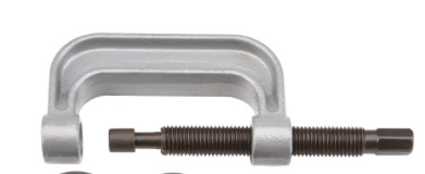

May 26, 20177 yr comment_521780 We are sitting the same boat and didn't even know it. I am replacing all 4 U joints in my half shafts, I was able to get two done yesterday as the shop had to order in the other two U joints. They should be in this morning. I found that O Reiliy's loans out the Ball Joint remover that Mike W mentioned in your other post. Basically it is free for 3 days you just leave a big deposit. It worked great for half the job and then I used a large C clamp with the sockets for the reassembly of the other half.    Link to comment https://www.classiczcars.com/forums/topic/57771-help-u-joint-replacement-71-240z/#findComment-521780 Share on other sites More sharing options...
