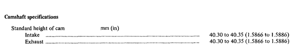

June 5, 20177 yr comment_522388 The base circles aren't as small as some ground cams. When they grind a new profile over an existing profile they cut some base circle off. You can measure the cam lobe height also to see how close it is to factory specs. Not sure but I think that factory cams were cast to shape, forged, then ground. Or maybe just cast and ground. But not billet. That's why your Potter cam is so smooth between the lobes but the factory shafts are all gnarly. Link to comment https://www.classiczcars.com/forums/topic/57863-this-old-cam/#findComment-522388 Share on other sites More sharing options...
