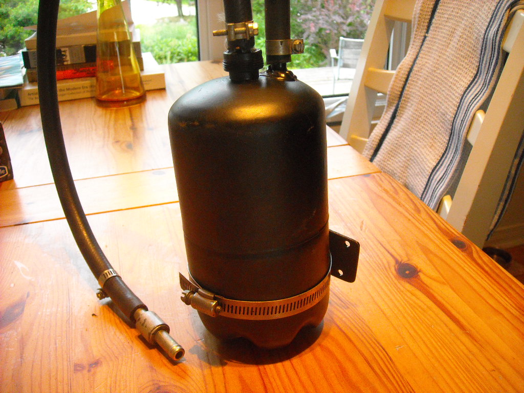

June 20, 20177 yr comment_523525 z boy, if you do decide to install a vacuum canister you don't have to spend $65 for one, I use a camping propane canister. Make sure it's empty first, the safety valve is just a schrader valve like from the valve stem on a car tire, unscrew it and blow some air into the canister blow out any remaining propane gas then drill out the main valve and the safety valve hole to 5/16", slip in a couple of pieces of 5/16ths hard gas line and solder, braze, weld or even seam seal them in. If I remember right the brake booster requires less than 14lbs of vacuum to activate the diaphragm so not very much. Link to comment https://www.classiczcars.com/forums/topic/57904-electric-vacuum-pump-for-brakes/?&page=2#findComment-523525 Share on other sites More sharing options...
June 20, 20177 yr comment_523530 Â I love it. It lacks duck tape but there's a bit of Red Green in that set-up Link to comment https://www.classiczcars.com/forums/topic/57904-electric-vacuum-pump-for-brakes/?&page=2#findComment-523530 Share on other sites More sharing options...
