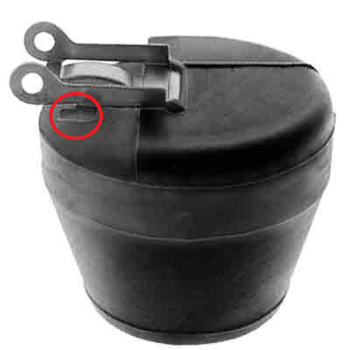

June 14, 20177 yr comment_523078 The tangs on my floats were bent up like a roller coaster's first climb. Â That caused the bowls to barely have fuel, if I drove up a pretty steep mountain it would stall out from fuel starvation. Â I found that having them bent fairly level was a good starting point. The red circle was for somebody else. And try gluing your gaskets onto the lids, it helped me when i was getting them set. Â I used black oil and fuel resistant RTV. Link to comment https://www.classiczcars.com/forums/topic/57916-how-to-tune-carbs-just-to-get-the-car-running/?&page=2#findComment-523078 Share on other sites More sharing options...

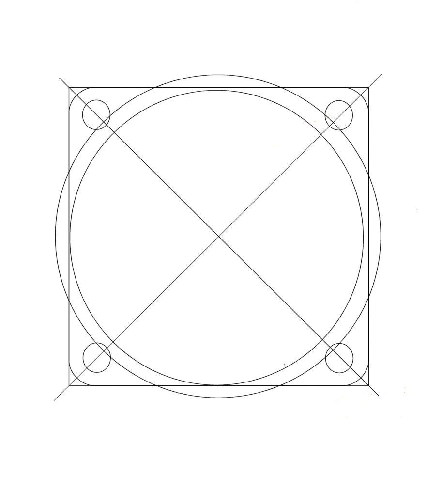

June 14, 20177 yr comment_523116 You may have to scale the above drawing so practice on plain paper until you are happy then throw the gasket paper in the printer. I filled the drawing up with side-by-side copies so that 1 sheet of gasket paper had 6 or 8 templates printed... just in case I screwed up a few when cutting. Edited June 14, 20177 yr by 240260280 Link to comment https://www.classiczcars.com/forums/topic/57916-how-to-tune-carbs-just-to-get-the-car-running/?&page=2#findComment-523116 Share on other sites More sharing options...
