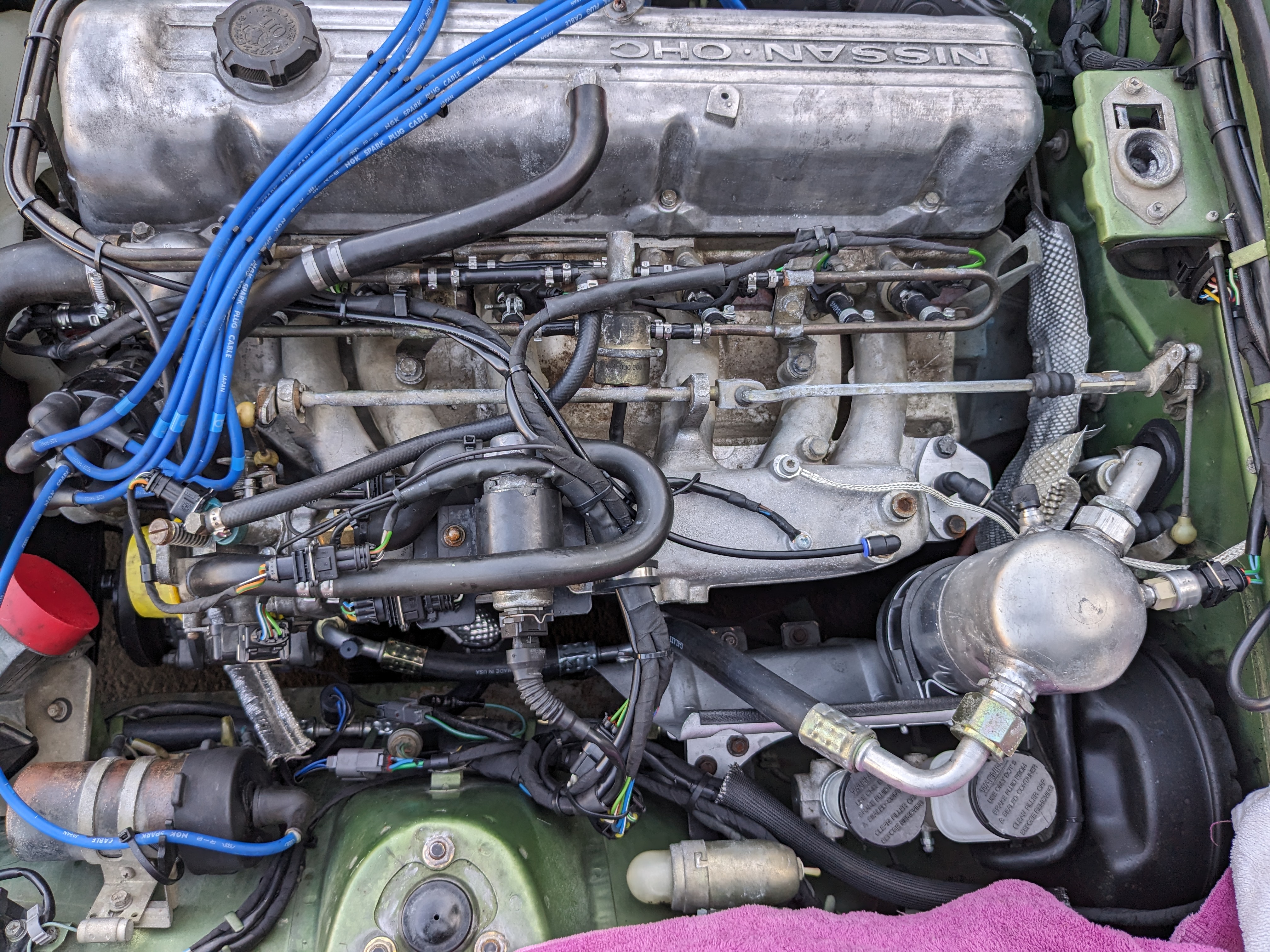

September 3, 20231 yr comment_656623 More wiring. Realized I have to remove the compressor as I didn't drain the mineral oil - I forgot that this compressor (TM15D) was setup for R12. Have to refill with Pag46Ā wiring overview Tucked behind hood catch, secured to firewall to make sure no issues with throttle linkage. Low pressure cutout on accumulator in foreground Harnesses routed alongside stock wiring. Have to secure the 2 relays Edited September 11, 20231 yr by HusseinHolland add pics - revised schematic Link to comment https://www.classiczcars.com/forums/topic/57948-designing-ac-system-using-other-cars-parts/?&page=6#findComment-656623 Share on other sites More sharing options...

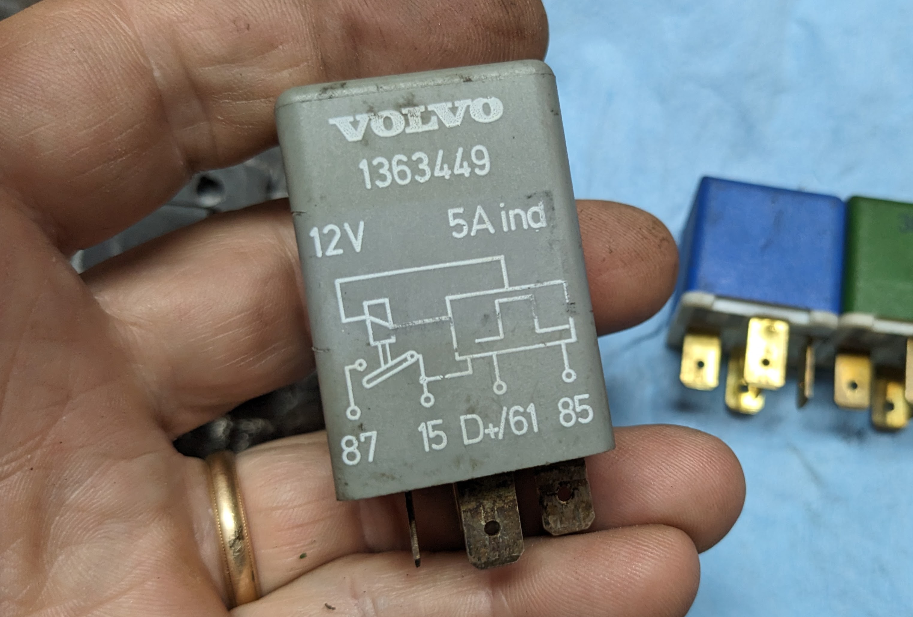

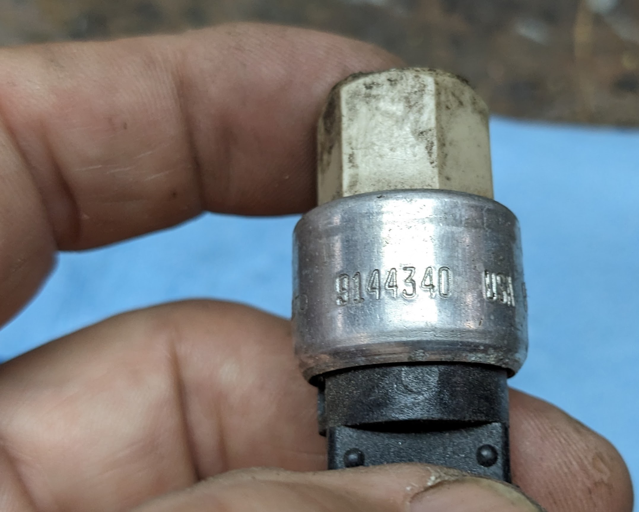

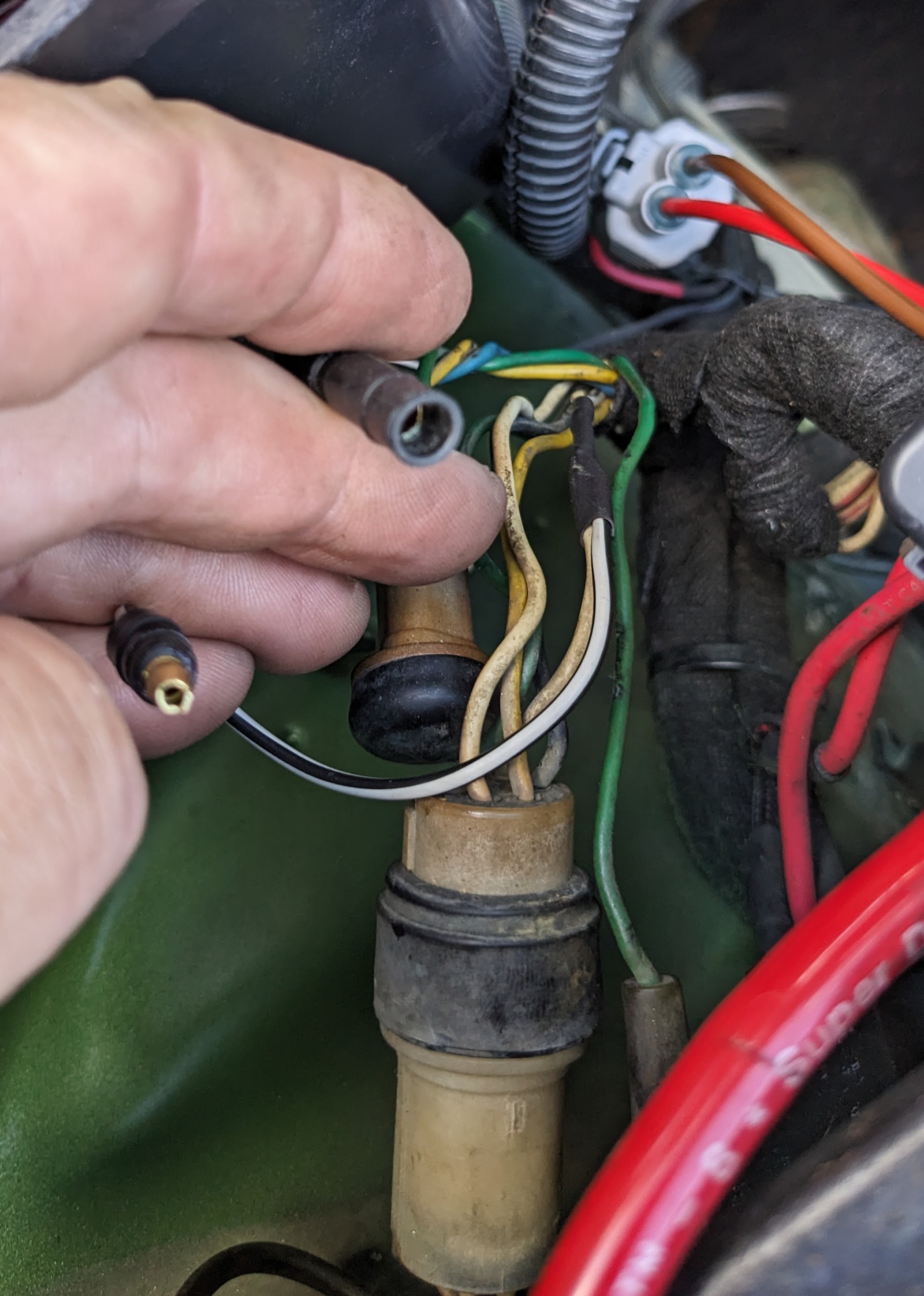

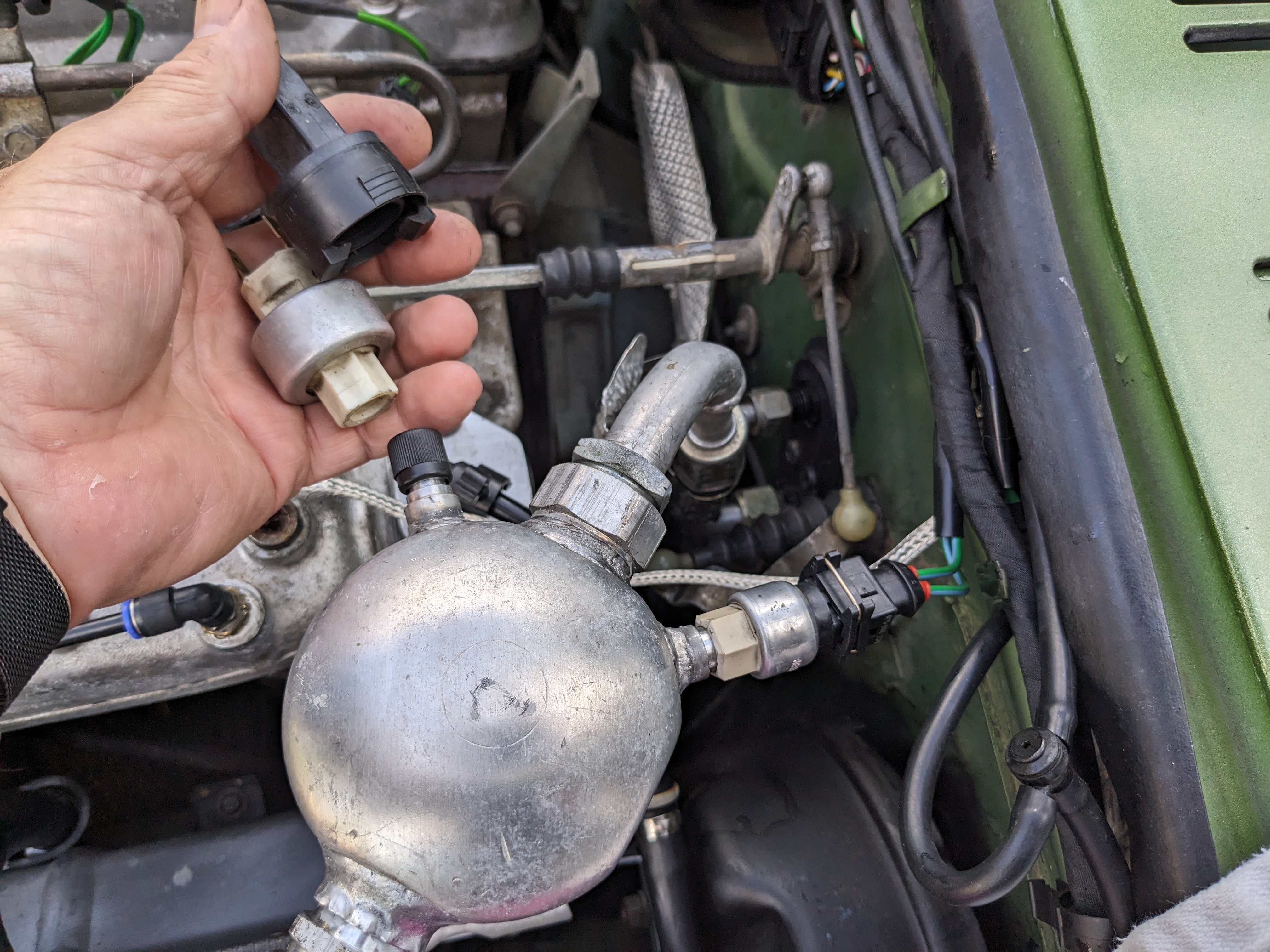

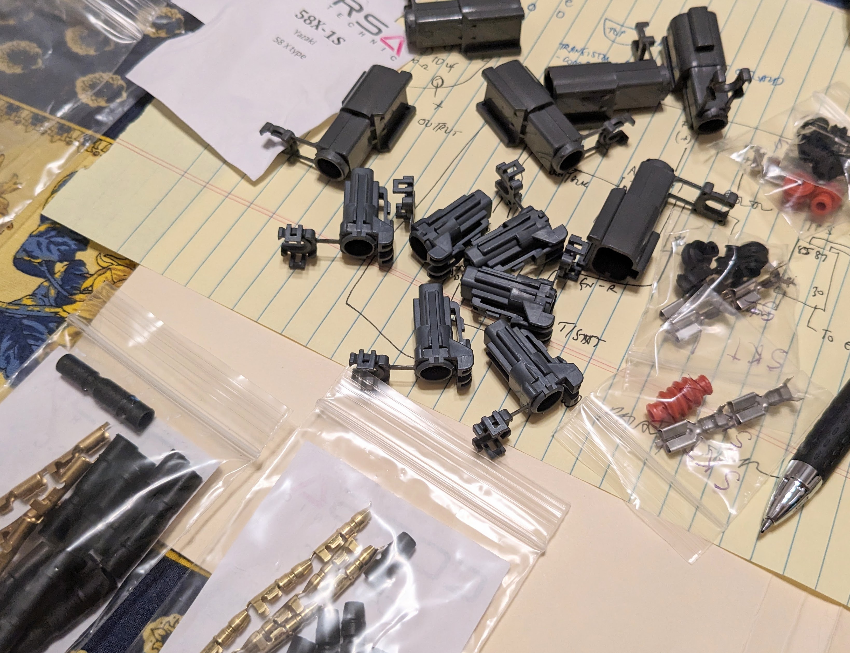

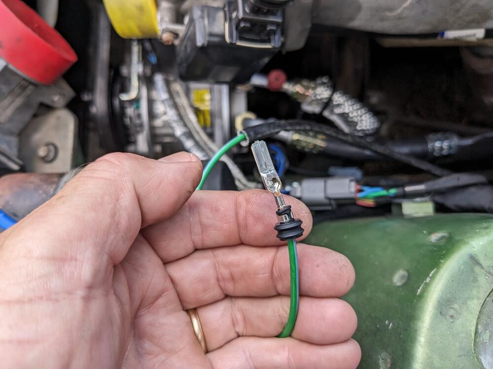

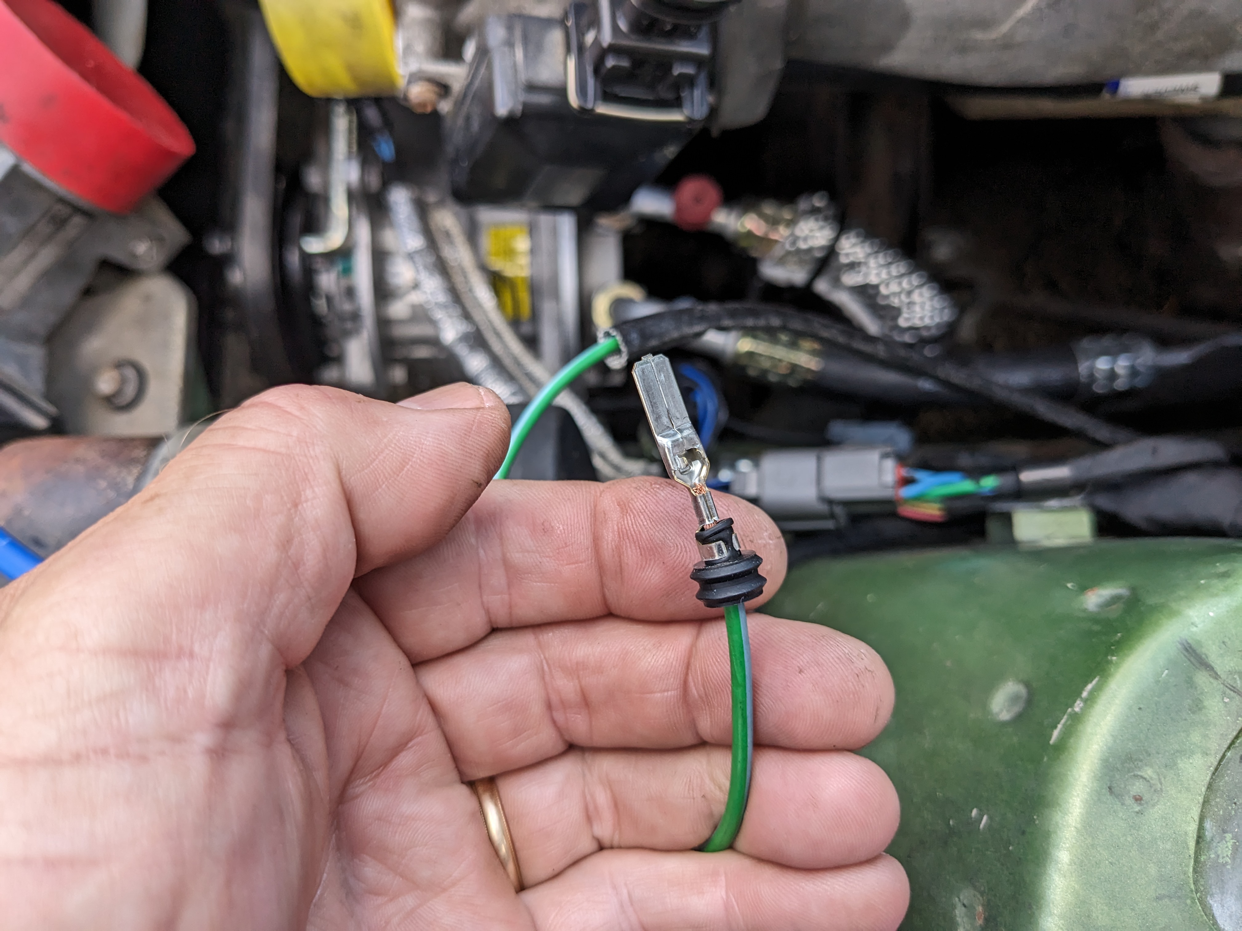

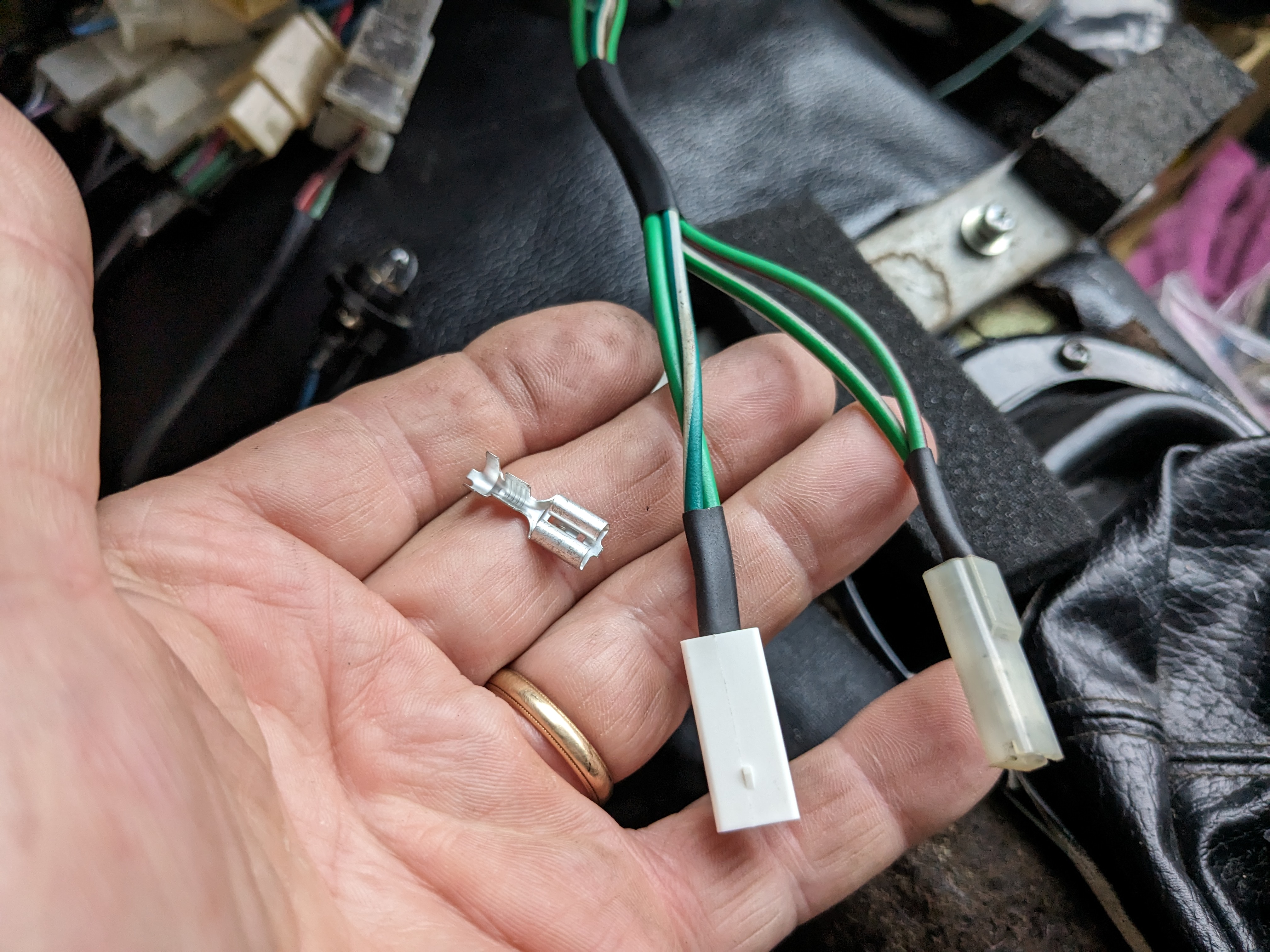

September 12, 20231 yr comment_656952 Haven't been able to work outside with all the rain. Just to keep things moving, I did a small amount of wiring inside the cabin - just the T/stat connections here, and routing wires for the delayed engagement relay VO 1363449. uses a sense signal from the alternator to only engage once the alternator is charging. The white/black wire to the V/reg (F terminal on alt) should be appropriate. Have a more compact low pressure switch that can go on the backside of the Accumulator facing the firewall, instead of the sticking out over the manifold VO 9144340 a bought a number of single pole waterproof connectors, so the bullet style will work for the D+ splice at the v/reg 6 pole connector, and at the AC compressor.Ā Ā Link to comment https://www.classiczcars.com/forums/topic/57948-designing-ac-system-using-other-cars-parts/?&page=6#findComment-656952 Share on other sites More sharing options...

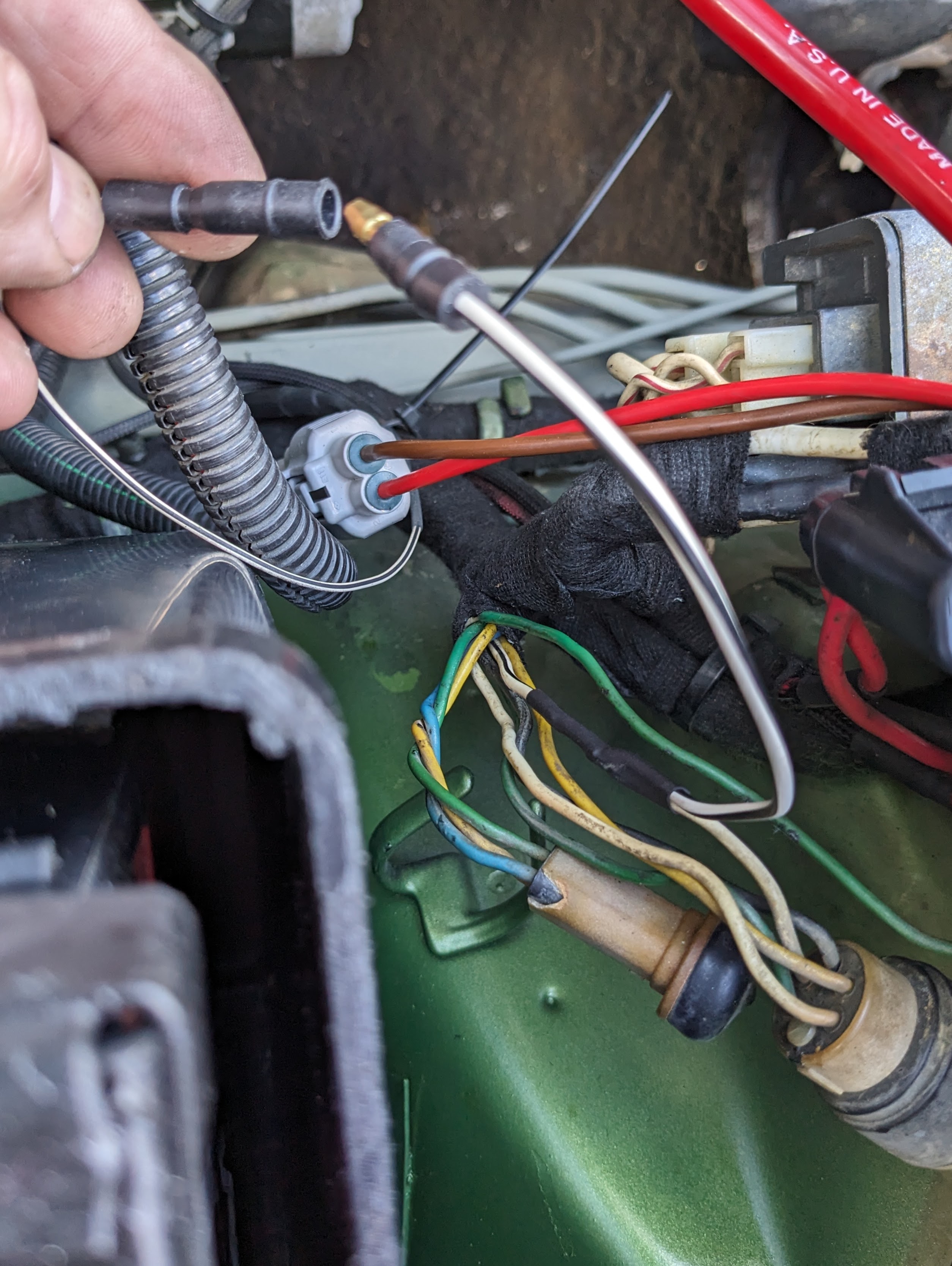

September 13, 20231 yr comment_656978 Wired the compressor & the delay relay signal from F at the V/reg swapped out the pressure switch Link to comment https://www.classiczcars.com/forums/topic/57948-designing-ac-system-using-other-cars-parts/?&page=6#findComment-656978 Share on other sites More sharing options...
