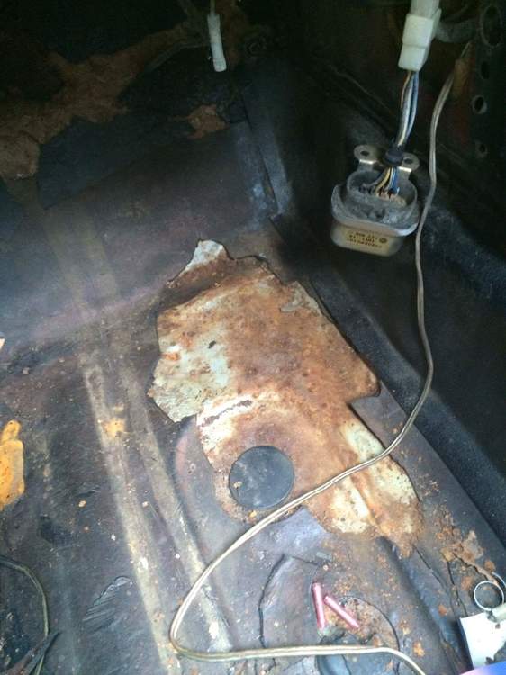

Rust wise, he says it's not horrendous as he keeps it garaged but the floor boards need replacing.. Does anyone know how much roughly that  would cost? I've read $1500-2000? I'm fairly sure I could do this myself as it's straightforward welding.

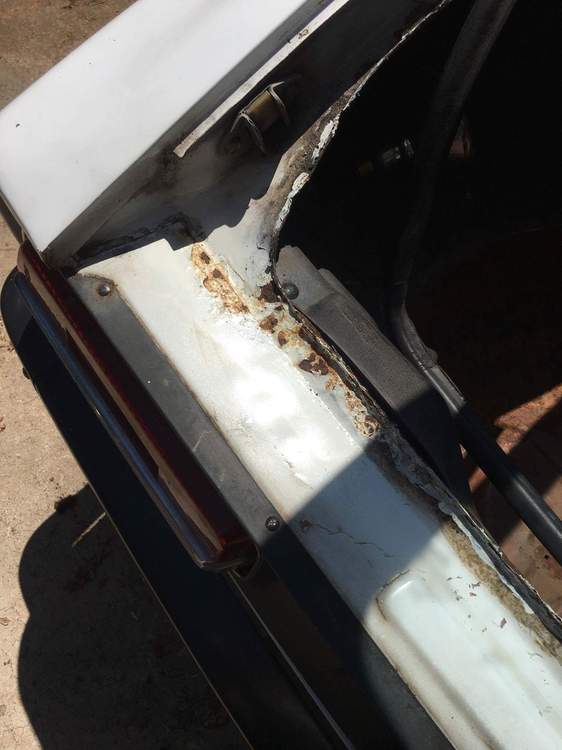

Small rust on the drivers dog leg, he says that's purely cosmetic. The rear valance has rust, but no holes, I've attached a picture.. Any idea roughly how much that would be to replace? I don't think I'd be able to do this myself.

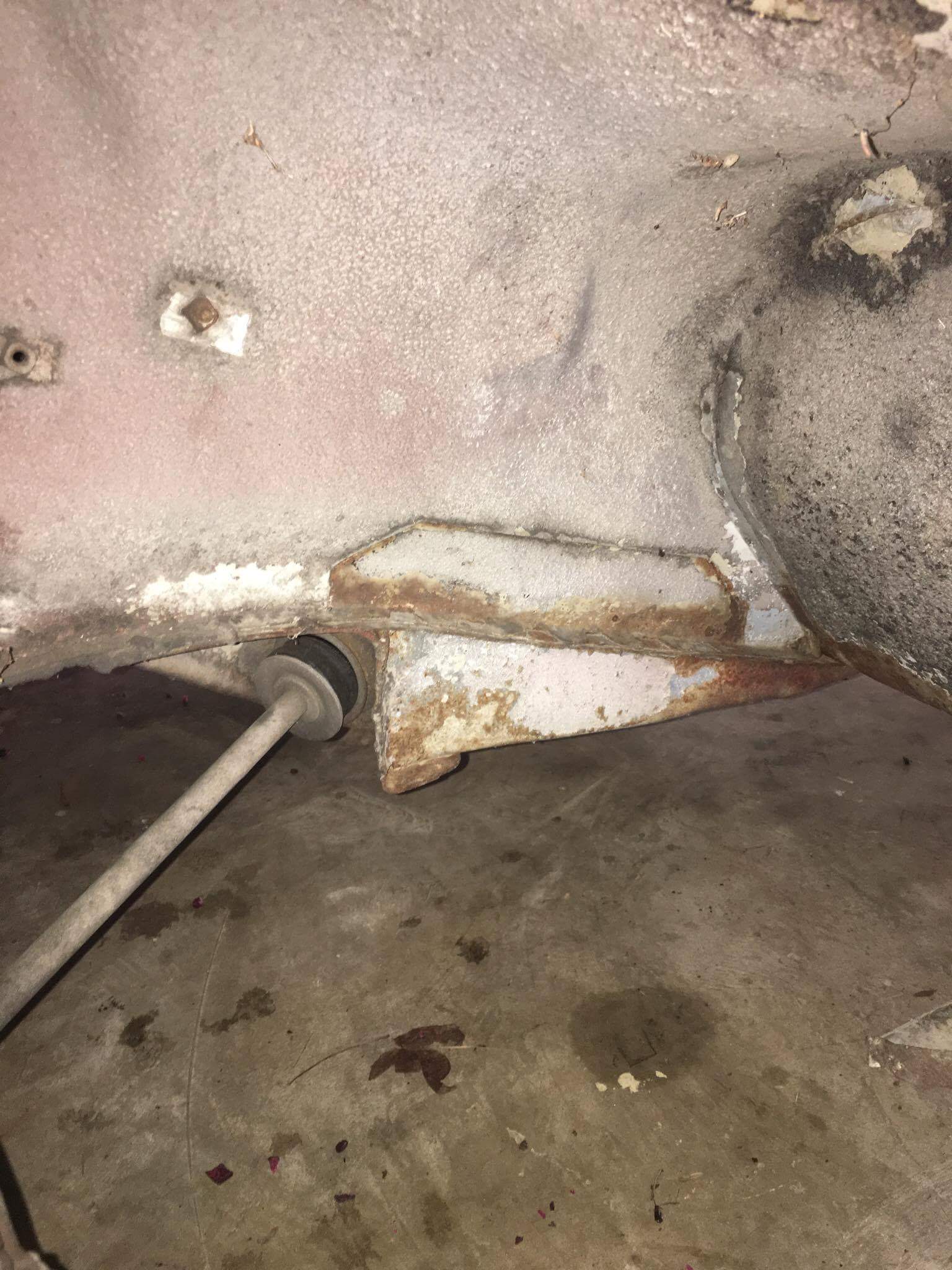

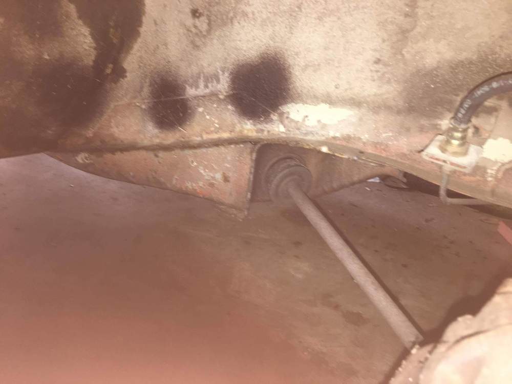

I've attached a few pictures of the underside too? How do they look?

The best shot for me is under the battery. That can be a tricky spot with the acid eating up the fuel lines. I ran rubber from the slave cylinders location to the fuel filter.
Tabco has replacement panels for what you've shown in your pics.

The floor doesn't look that bad. Doesn't look like it goes through, but if it does, you could just patch it, vs total replacement. I'm stretching my memory here, but I think I recall John Coffey saying it was $1500 a side to replace floors. That said, that picture only shows one spot of one floor, and may be misleading to overall condition.
I may be wrong, but my gut is telling me that the driver's side frame rail reinforcement there has rust behind it. Could easily be wrong, but that spot rusts out pretty often, and seems to start from behind. Just kinda looks like it's been pushed out a bit in the middle there from the wheel well.
Hatch sill rust looks pretty tame. Not sure you'd need a full replacement. FYI, Tabco parts are kind of a mixed bag for fitment. Some of their panels are just useless.
If there's one thing I've learned though, it's that rust is usually worse than you expect.
Jay, that looks like a pretty decent car from the pics, lots of owners have cut out replaced the floors themselves, it's not an easy job but it will save you lots of money. There are lots threads in the archives with great pics of how others did there Z's
