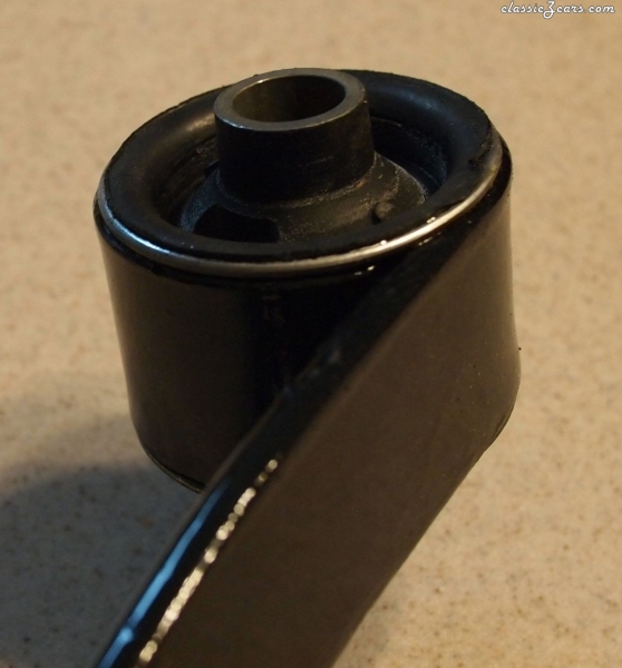

August 4, 20177 yr comment_527353 Some additional photos to support the view that the OE design for the MB mount insulators is 'special'... Link to comment https://www.classiczcars.com/forums/topic/58037-mustache-bar-bushings/?&page=3#findComment-527353 Share on other sites More sharing options...

August 4, 20177 yr comment_527364 Here's a rough chart that can give you an idea of the relative hardness of rubber and poly: My thought on poly replacements is they are (obviously) better than nothing, but will never be as compliant (or quiet) as the original system. With the original system, the only points of contact are through the rubber bridge of the bushing, and the raised tips of the rubber on the flat washers. With poly, you usually have much more contact. At least that's the case with the current design poly bushings. Also, I'm not sure about the flexing abilities of poly. By that, I mean, I know what happens to rubber when it flexes and flexes and flexes a whole bunch of times... Pretty much nothing. But what happens to poly when you flex it a couple thousand times? I suspect it cracks a lot more readily than rubber of the same durometer. So the tipping point would be to make it as soft as possible without it being soft enough to bend enough in application to cause it to fatigue and crack. Link to comment https://www.classiczcars.com/forums/topic/58037-mustache-bar-bushings/?&page=3#findComment-527364 Share on other sites More sharing options...
August 4, 20177 yr comment_527371 3 hours ago, Jason240z said: Interesting. I've got this company on the case for us. http://robush.com/ Im interested in hearing what they say. I have used their fkm and isolast products a lot and they have made special parts for the company I work for in the past. Set-up costs will be the main hurdle. Captain Oblivious posted a schetch of the centre bushing, but has anyone made a schetch of the washer ends? I have a set of washers that are still in good condition. Link to comment https://www.classiczcars.com/forums/topic/58037-mustache-bar-bushings/?&page=3#findComment-527371 Share on other sites More sharing options...
August 4, 20177 yr comment_527392 I've never seen a good dimensioned sketch of the washer ends. I'd be interested if you want to make one up! Are the two stock washers the same, or did they have different hole diameters in the middle to account for the bolt they ride on? Link to comment https://www.classiczcars.com/forums/topic/58037-mustache-bar-bushings/?&page=3#findComment-527392 Share on other sites More sharing options...
