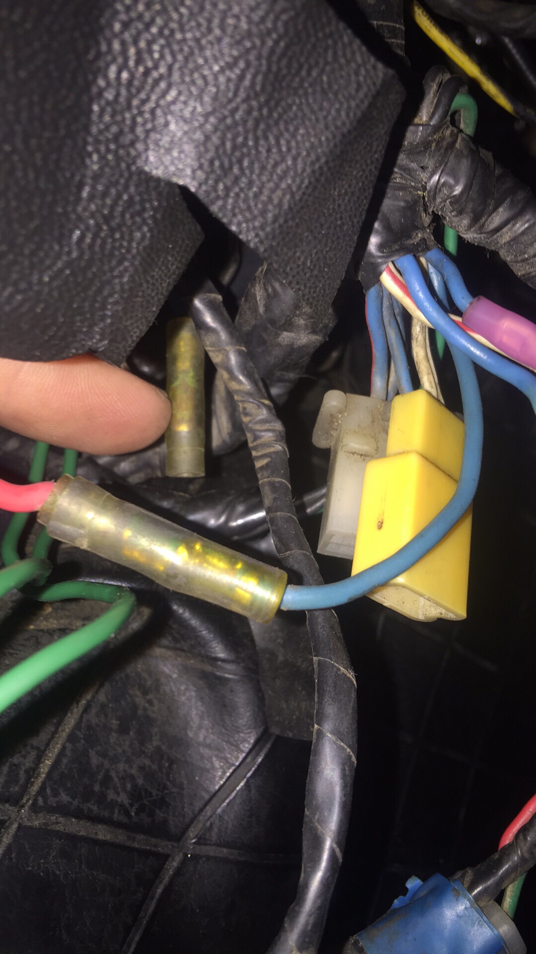

Power to the stereo is taken from the blower motor harness, so if the blower motor don't work ofcourse the stereo won't.
Heres we're I did wrong. Blower motor power cable (red) is now connected to the correct blue female. See pic
before it was connected to another (pointing on it) blue female.
  On 7/24/2017 at 11:17 AM, moelk said:
Dident see that correct cable till I look at my pics I just posted  : )
Feeling stupid But happy.
Stupid is making a mistake and never realizing or learning from it.
