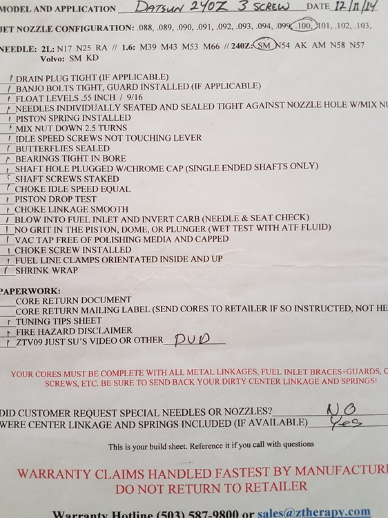

I did had a flaw on both of my su carb float levels and had to set them both to .055 measured with a caliper from the top of the lid to the float.

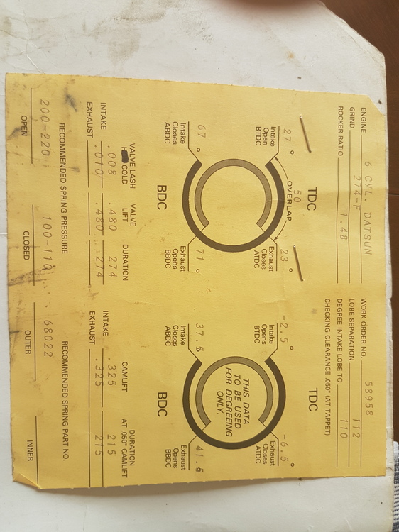

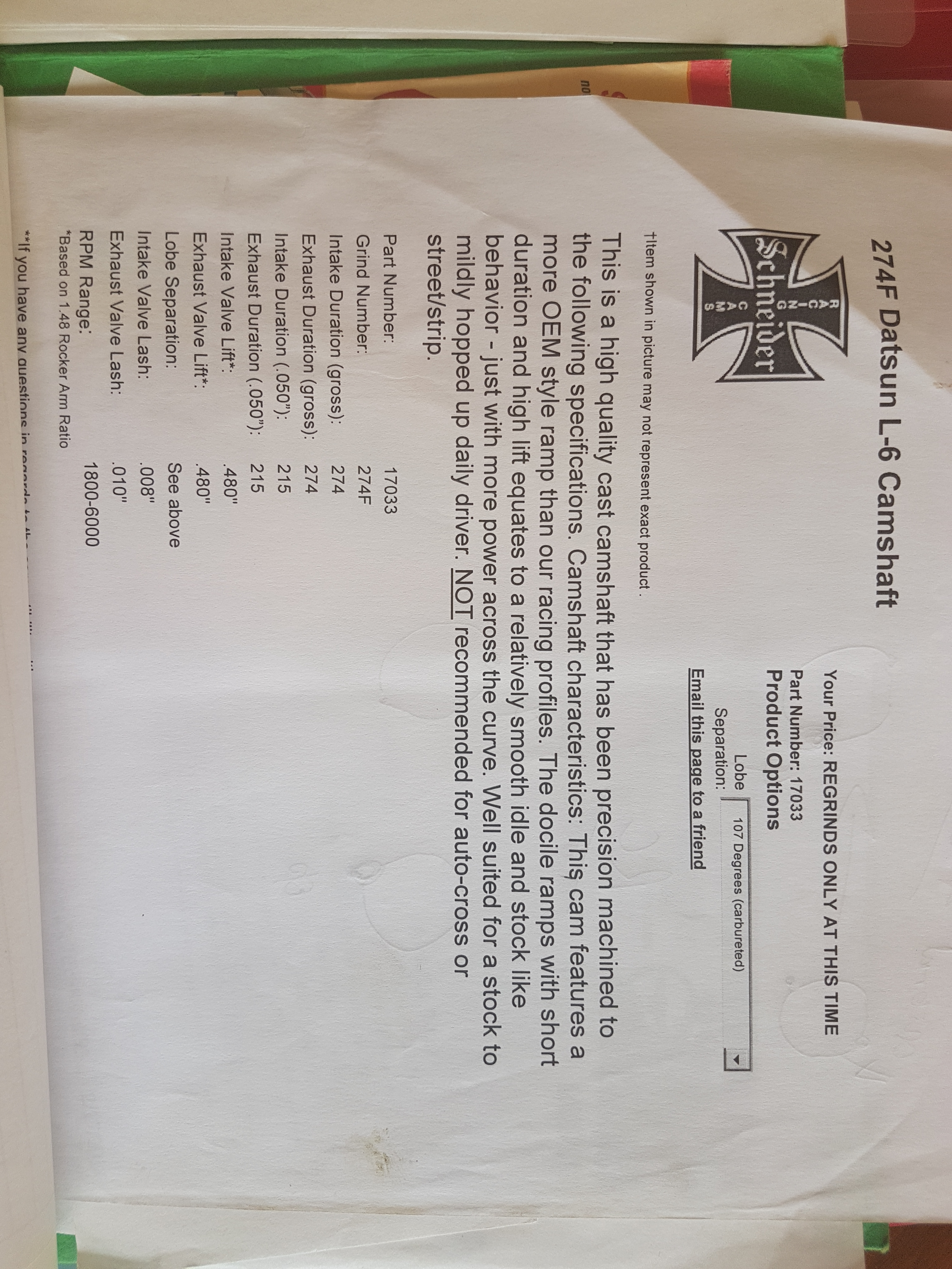

What do you recommend? Also my engine was modified to 2.6L with a Schneider 274F camshaft and i was wondering if i should also swap to better needles?? When both of my su carbs were rebuilt, ztherapy installed SM Needles.
