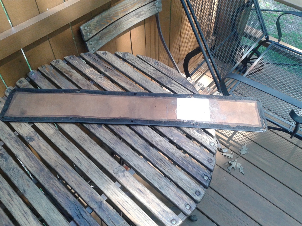

Steve I have a few of these laying around if you want to use one for a pattern. It's curved so not easy to get perfect the first time.
As to thickness, the original hardboard stuff is ~1/8th. I like the idea of using thicker or at least stiffer material so it stays flat and stays sealed forever. Nice bead of dum-dum around the outside will keep it air tight.
Edited by zKars
Agree with zKars. That's why mine is off, it was bent in/broken over the years. I suppose something slid into it? But that's why I removed it and had an upholstery shop glue that thin metal patch in my first picture.

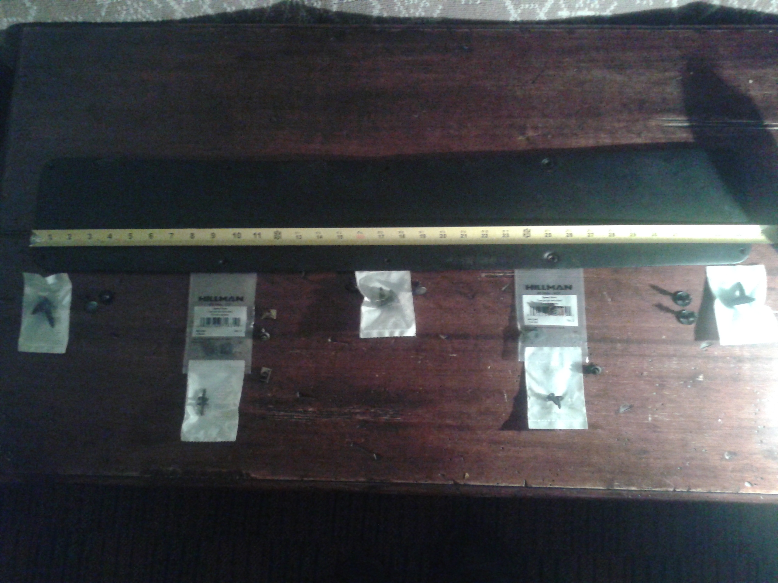

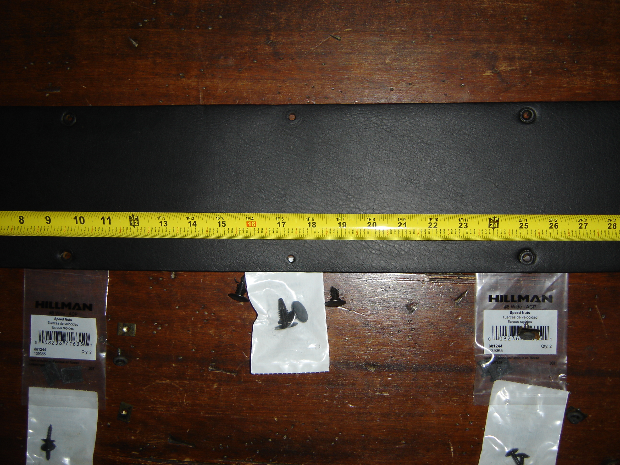

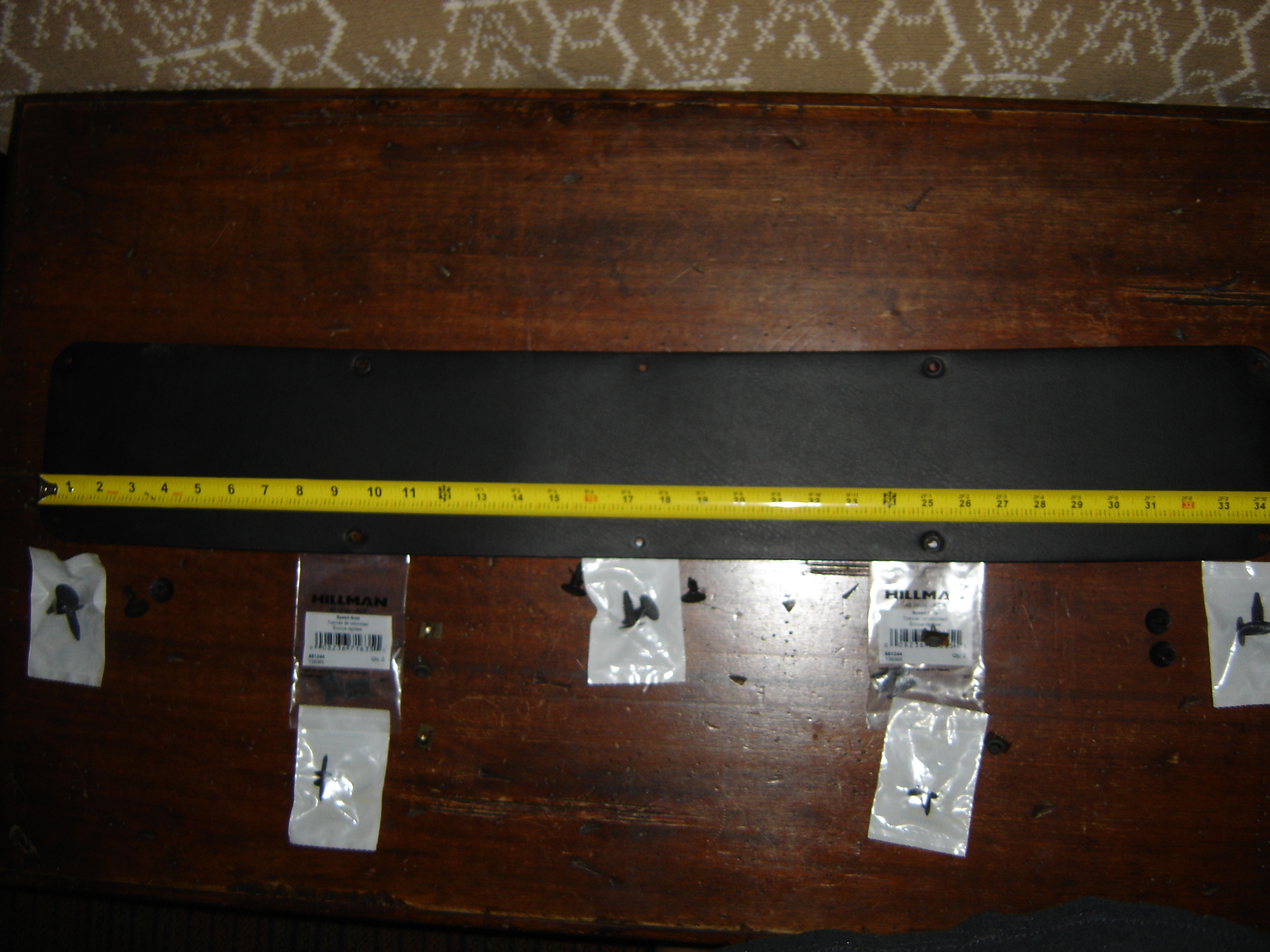

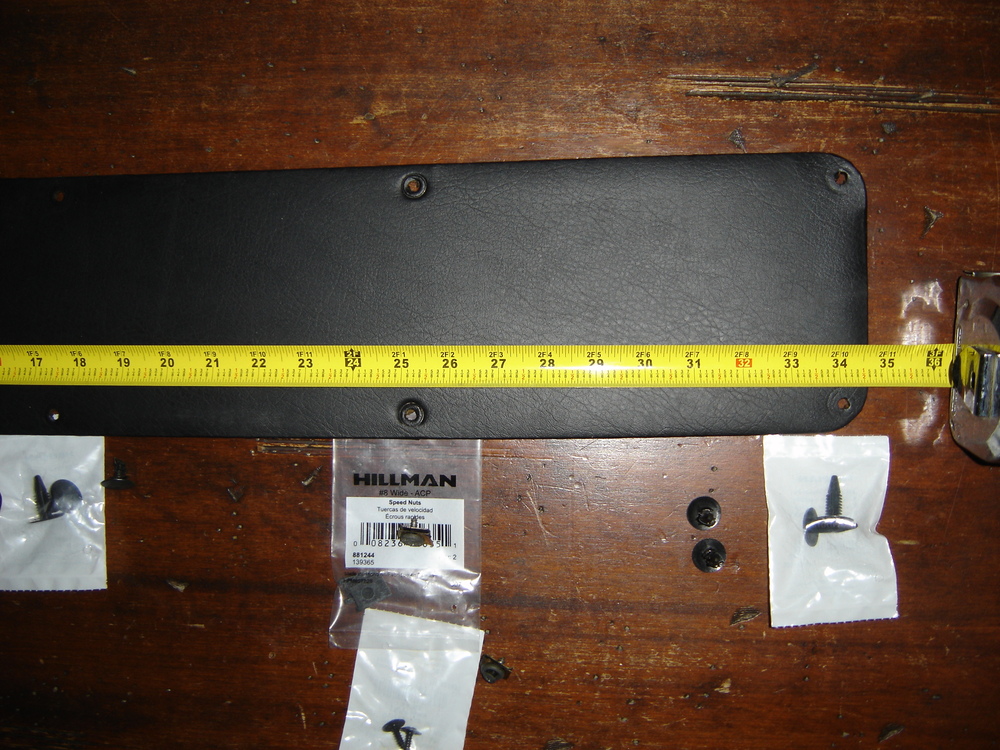

I'll try my best here, if you need something let me know.
I don't have a millimeter tape measure but these are dead on 1/8's, except the distance from the outer edge and the holes all the way around.  They are falling in between 3/8" and 1/2" on my tape measure.
Overall length, 34-5/8"
Width, 5-3/4"
1st hole, 5/8" from edge
2nd, 9-3/8"
3rd, 17-1/4"
4th, 25-1/8"
5th, 34-1/8"
I started my measuring from the left side and the holes are between 3/8"&1/2" from the outer edge.  I bought what I believe is the closest to original from Lowes hardware.  Four #8 speed nuts and four #8x5/8" screws.  Those are for the 2nd and 4th holes top and bottom, from the left.
Six "variable depth push fasteners GM" for the 1st, 3rd and 5th holes top and bottom.
