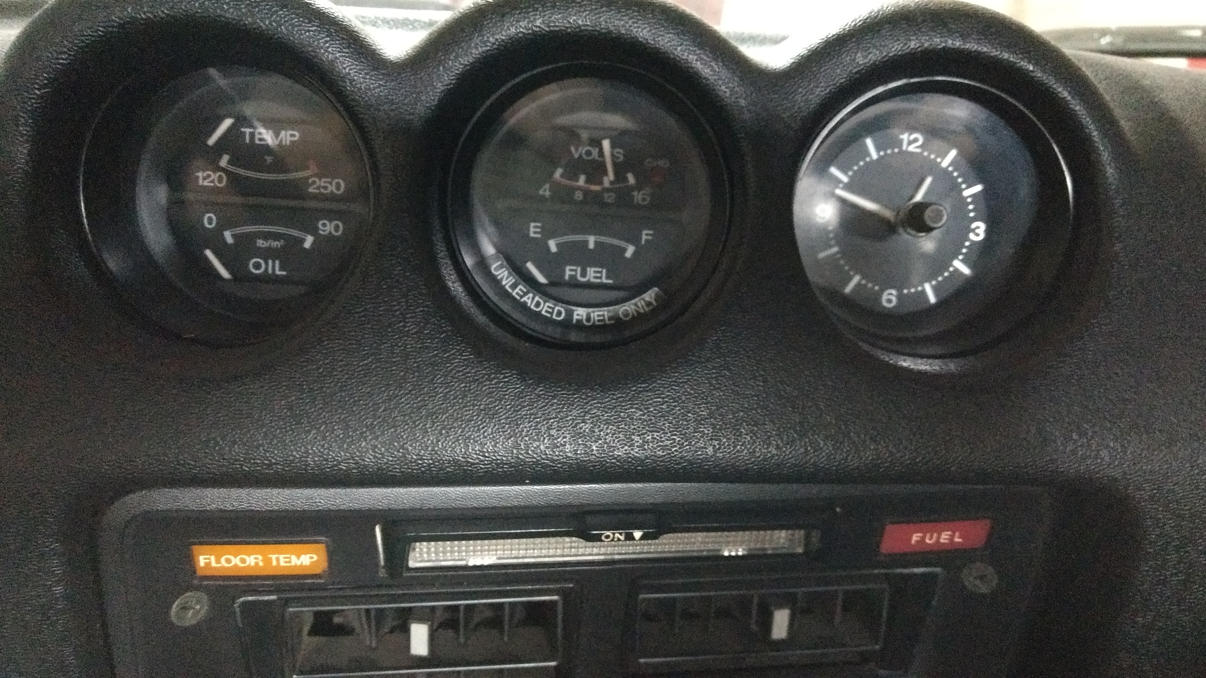

Must be a CA thing. My 78 has it, as did the 75 I pulled a second dash from.
The californian models were fitted with a Cat. Thats why they need unleaded and the floor temperature warning light.
