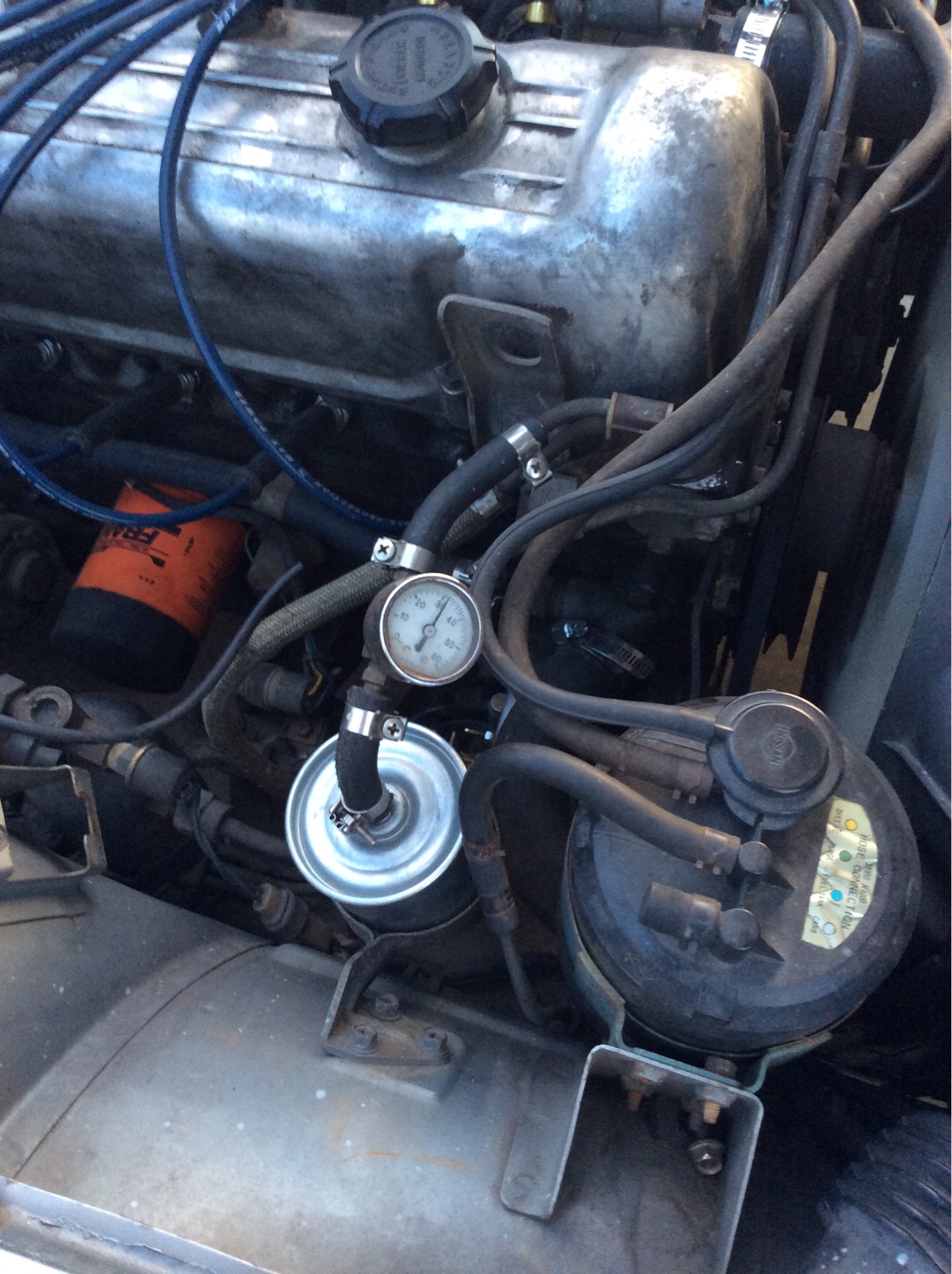

ideally the gas jug should be above the pump. maybe a little longer lines and put the jug up on a box.
They're 3ft hoses.

Yes on the gas jug.  Ideally Dave is right but if you have a good amount of fuel in it should be ok like you do. Stuff a rag lightly around the neck of jug.
BEFORE YOU START MAKE SURE YOU HAVE A FIRE EXTINGUISHER HANDY! Just in case. I'd even go as far as have a fan pointing Towards the can to ensure any raw fumes escaping are blown out the garage. Looks like you have it in there.

Fuel needle stays still. And doesn't move around or drop in pressure.

Let it run for a bit. ?
Now if you could rig somehow to go for a drive. I wouldn't suggest it. ?

Doesn't it read 32 psi?  Fuzzy.  That's low.  Progress, but still.
Don't know why you still have that prefilter on there for the test.
Yea, it reads 32 and doesn't go below that. Is that because the jerry can isn't fully sealed?. Also what wire should I buy tomorrow? I was told 1/8 of an inch round balene wire.
I was told if I were to poke a hole through the sock that there would be debris coming out. But I'll take it off.

goose the engine if it was running, the fuel pressure will respond if the FPR is working right.
I gave it a little rev and it did go up in fuel pressure. Obviously it wasn't a big rev because I have a jerry can. But it went up to 38and back to 32.
