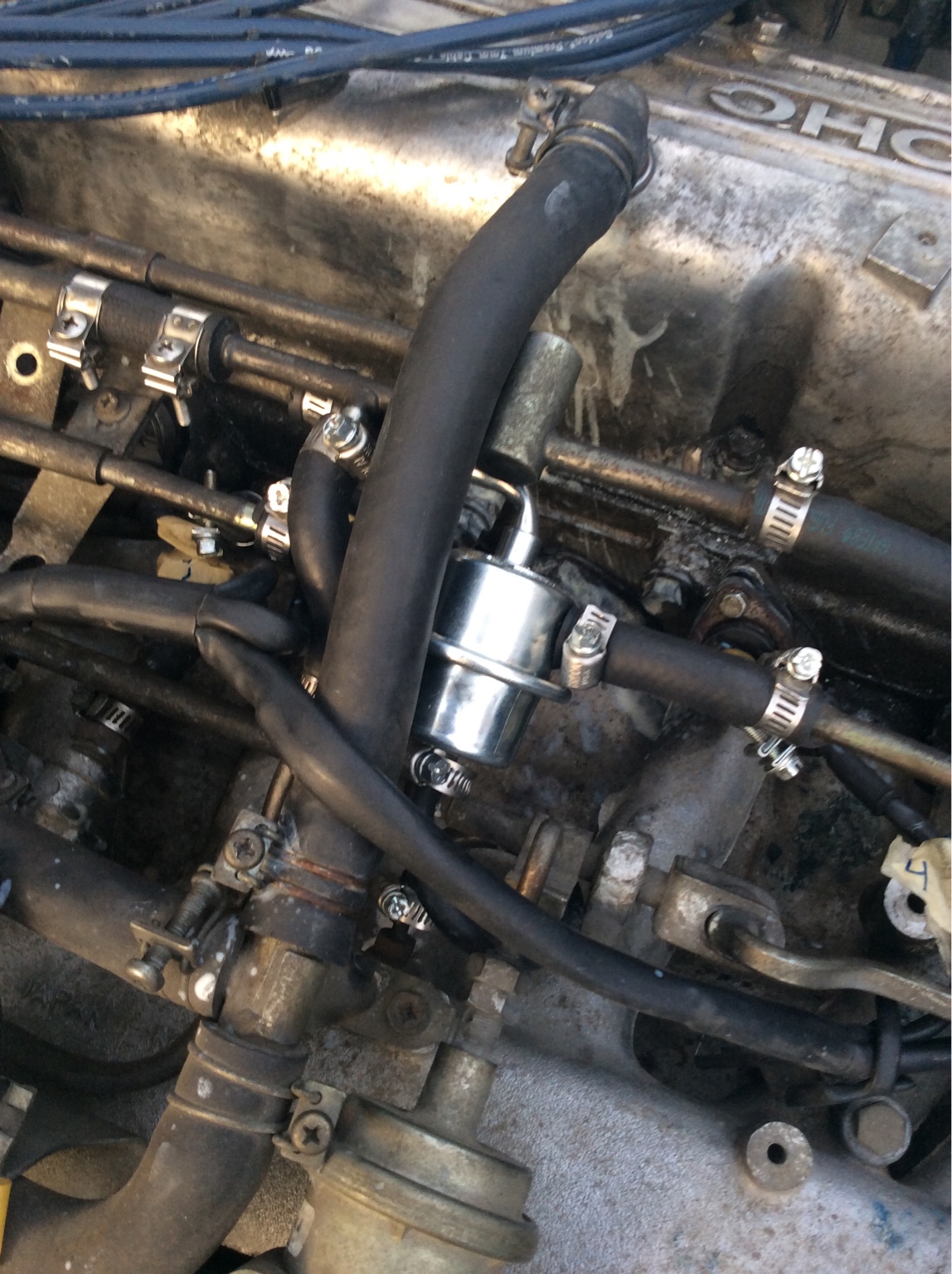

August 12, 20177 yr Author comment_527818 Anotha update:I recently installed a new set of injectors(lifetime warranty) and a fuel pressure regulator. Every time it starts up immediately then when I drive it out maybe less than a quarter mile it drops in fuel pressure(down to 10psi) and when I when I returned to my house a parked it but didn't turn it off it was still running 10 and wanted to die. I've noticed when I drive it and I'm giving it gas that it will all the suddenly not want to take anymore then all of the sudden the rpms come back up and starts driving. And it happens consistently as I drive, it'll happen more and more. But today was swapping out the injectors with new ones and a new fuel pressure regulator day. I'm really confused. I've asked my auto teacher about it when I ran into him the other day at a store and he had a lot to say and was trying to narrow down what it could be. I told him about the rust and everything that had happen and he told me I didn't have to change the injectors because if one of them were clogged than more of them should too if rust particles were to have gotten that far. Sent from my iPad using Classic Zcar Club mobile Link to comment https://www.classiczcars.com/forums/topic/58221-starting-problem/?&page=2#findComment-527818 Share on other sites More sharing options...
August 13, 20177 yr Author comment_527836 Idles fine, no misfiring, no smoke, some soot. New fuel regulator and injectors. When the car idles I do notice that my fuel gauge jumps around a lot from 32 to 30 a lot and even hits 29 at some times. But as soon as you want to drive it, I guess the better way to put it is that it stalls and doesn't get the direct power anymore. Which is very confusing as to what the problem maybe now. Sent from my iPad using Classic Zcar Club mobile Link to comment https://www.classiczcars.com/forums/topic/58221-starting-problem/?&page=2#findComment-527836 Share on other sites More sharing options...

August 13, 20177 yr comment_527838 4 minutes ago, SeKcGamer said: I guess the better way to put it is that it stalls and doesn't get the direct power anymore. That's not really a very good way to describe anything. From your previous posts, the drop to 10 psi is your main problem. That should never happen. Either you're losing power to the fuel pump, or the fuel pump is bad and not spinning fast enough, or you have an obstruction in the supply to the pump. Focus on the pump and its power and fuel supply, Link to comment https://www.classiczcars.com/forums/topic/58221-starting-problem/?&page=2#findComment-527838 Share on other sites More sharing options...
