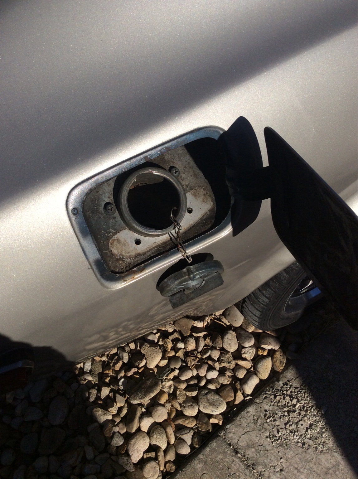

August 16, 20177 yr comment_528040 random thought 9 hours ago, SeKcGamer said: After everything was installed the car started right up, I took it for a drive around the block twice and drove fine, but on my third run I started getting the same problems again. The pressure went down and I barely made it back home. When I finally got back it died at 16psi and didn't want to start anymore. Sent from my iPad using Classic Zcar Club mobile random thought. after driving around the block, try opening the gas cap, is there a rush of air into the tank? heck, try driving without the cap. if the cap is bad, the tank may be in a vacuum not letting the pump do its job Link to comment https://www.classiczcars.com/forums/topic/58221-starting-problem/?&page=3#findComment-528040 Share on other sites More sharing options...
August 16, 20177 yr comment_528042 That's a good idea. Don't take any left turns at more than 2 miles per hour though. Link to comment https://www.classiczcars.com/forums/topic/58221-starting-problem/?&page=3#findComment-528042 Share on other sites More sharing options...
August 17, 20177 yr Author comment_528136 Even when I take off the gas cap there's no pressure build up. It's currently trying to idle at 30 but then moves rapidly to 20 then back up to 30. When I take the cap off, nothin. It's like closing a jar and opening it.Sent from my iPad using Classic Zcar Club mobile Link to comment https://www.classiczcars.com/forums/topic/58221-starting-problem/?&page=3#findComment-528136 Share on other sites More sharing options...
