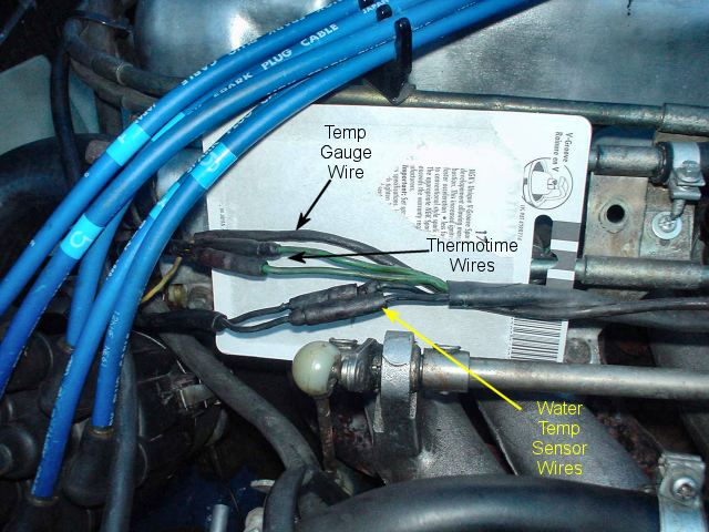

August 4, 20177 yr comment_527400 Without holding the throttle wide open try and crank it over. I've heard of the injectors magnets getting stuck after sitting for awhile. Try tapping each one with a screwdriver handle. The injector replacing in '15 might have been an attempt to fix the real problem? This is for a '77 but should be the same. The EFI may not be grounding and running continuously. Clean the grounds. http://atlanticz.ca/zclub/techtips/electricalconnections/index.html Link to comment https://www.classiczcars.com/forums/topic/58263-78-280zx-fuel-in-oil/#findComment-527400 Share on other sites More sharing options...
August 4, 20177 yr comment_527402 Make sure these aren't crossed. Edited August 4, 20177 yr by siteunseen Link to comment https://www.classiczcars.com/forums/topic/58263-78-280zx-fuel-in-oil/#findComment-527402 Share on other sites More sharing options...
