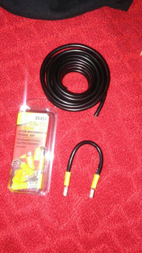

August 10, 20177 yr comment_527693 Just now, lefty7126 said: And then a buddy off mine who actually knows some what about cars helped me assemble these but that didn't make a difference. Sent from my LGLS770 using Classic Zcar Club mobile If that is regular wire, all I can say is DON'T DO IT! You need to use fusible link wire of the proper gauge, otherwise you risk burning up your wiring. Link to comment https://www.classiczcars.com/forums/topic/58282-1974-datsun-260z-wont-start/?&page=2#findComment-527693 Share on other sites More sharing options...
August 10, 20177 yr Author comment_527694 Yeah this wasn't recent I joined the forum to get better insight on what the problem might be that way I don't mess it up any worst.Sent from my LGLS770 using Classic Zcar Club mobile Link to comment https://www.classiczcars.com/forums/topic/58282-1974-datsun-260z-wont-start/?&page=2#findComment-527694 Share on other sites More sharing options...
August 11, 20177 yr comment_527697 1 hour ago, SteveJ said: If that is regular wire, all I can say is DON'T DO IT! You need to use fusible link wire of the proper gauge, otherwise you risk burning up your wiring. I seem to remember our vendors have this part. MSA: http://www.thezstore.com/page/TZS/PROD/12-4328 Zcar Depot: https://zcardepot.com/electrical/fusible-link-wire-green-oem-260z-280z-74-78.html Link to comment https://www.classiczcars.com/forums/topic/58282-1974-datsun-260z-wont-start/?&page=2#findComment-527697 Share on other sites More sharing options...
August 11, 20177 yr comment_527747 The original cables you posted pictures of are actually very special wires. They act like fuses, if you pull too much current they melt to protect the rest of of the harness. If you replaced them with heavy gauge wire and spade connectors then you transferred that overcurrent into the harness. It is possible you made a bad situation worse... Link to comment https://www.classiczcars.com/forums/topic/58282-1974-datsun-260z-wont-start/?&page=2#findComment-527747 Share on other sites More sharing options...
