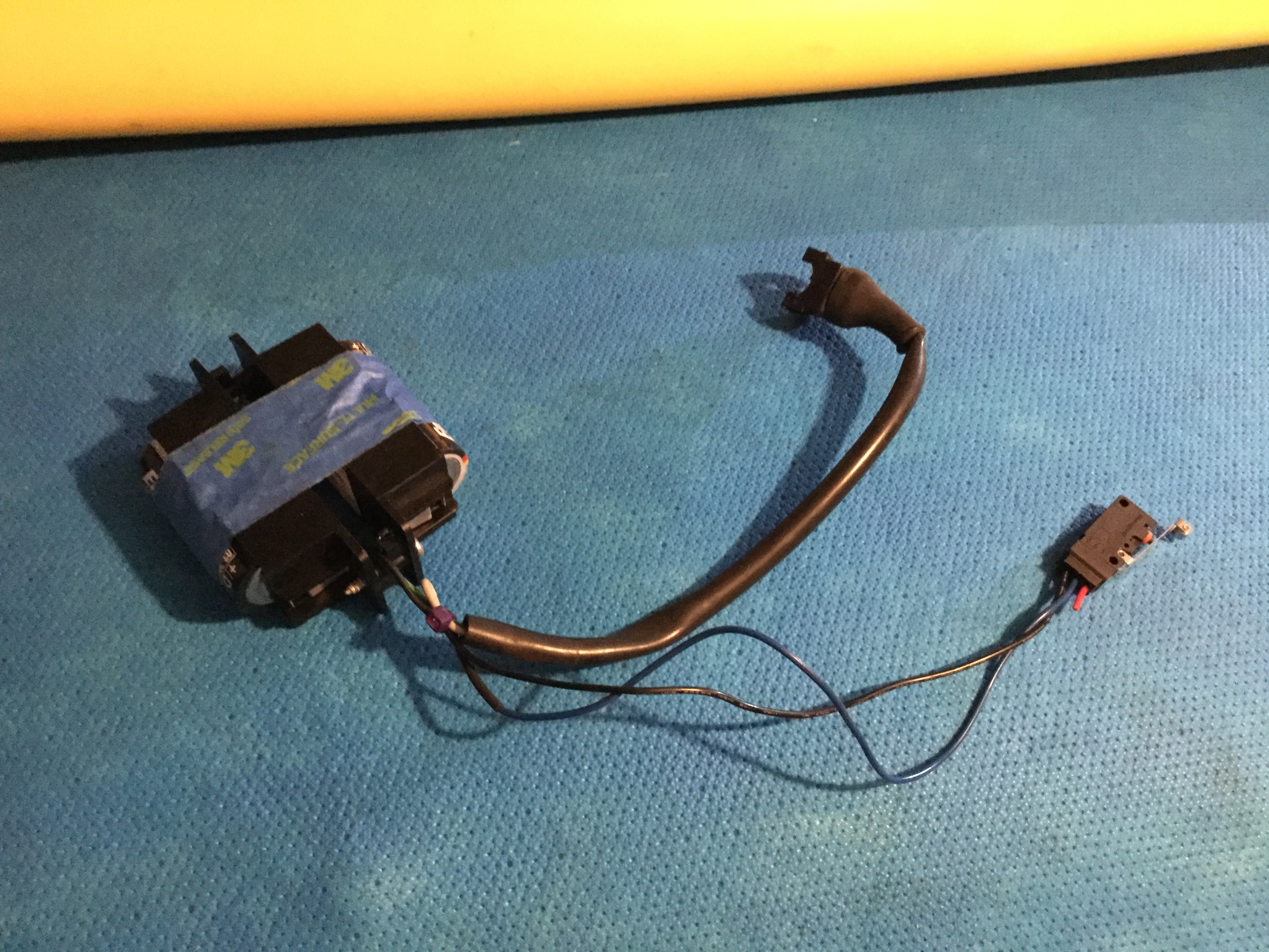

If they are clogged with the fresh gas sitting in them they may work free. My 280zx sat forever (10 years) and they worked free finally within 30 min. I was using starter fluid and I think running the motor on it alone helped the injectors pulse more and free up. At least that is my best guess.
Or take them out and make one of these to pulse them and run carb cleaner through them. Honestly, I don't think that is your issue.  I would do this as a last resort as it's a PITB!

Or an old good working injector works well too.  You can hold it in your hand and feel it actuate.

agree a working injector could be used for a noid, that is a closer load test etc..
I have used mech stethoscope, but unless you have listened for it before you may not have the "ear" calibration needed :)
